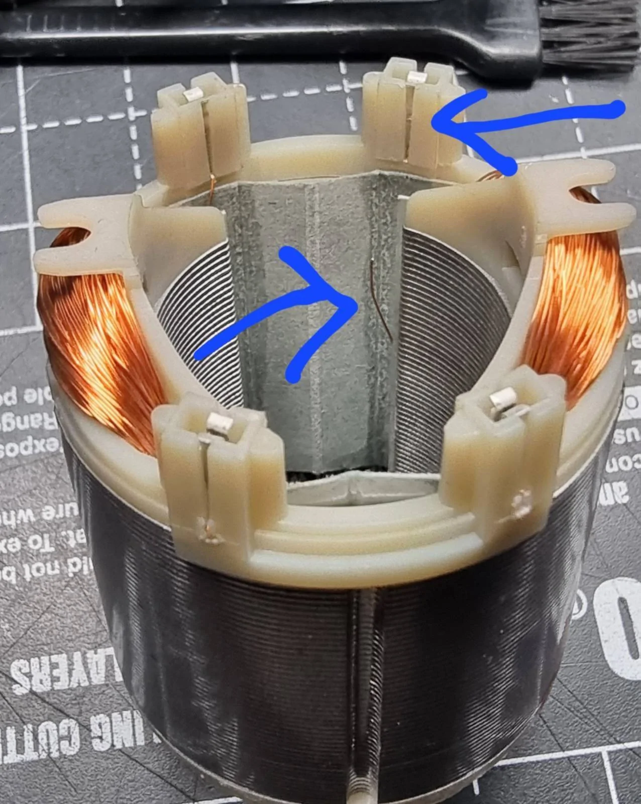

The 3000 was out of warranty so I took it apart and cleaned it and noticed this. After reconnecting it was working fine again.

The Dremel 3000 snapped another copper wire, so it seems this is an issue with this model.
