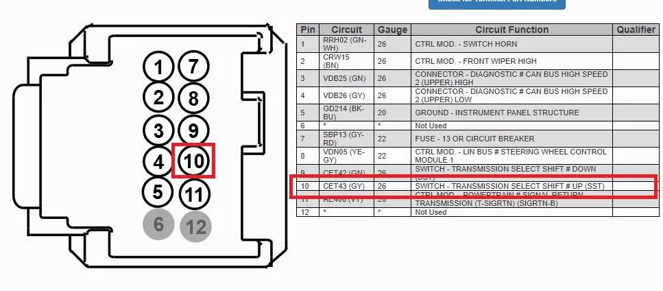

Wiring gurus input needed regarding paddle shifting

Doing a th400 swap as we speak and using an m&m co2 shifter. I want to use the upshift paddle to activate the Mac valve. My plan was to use a negative triggered relay to activate this pin/wire. But then I got thinking, isn’t this oem circuit 5v? If it is, couldn’t a regular 12v negative trigger hurt the ecu?
