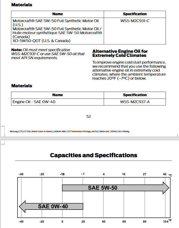

The Ford oil is actually 5w-50, which is fine at lower temps. Up until 2020 model year, Ford didn't suggest any alternatives, but the Owner's Supplement for 2020 has this diagram on page 53:

Would there be any adverse side effects if I applied this to a 2017 car? I know 2020 has a different block which is common with GT500?

I can't imagine why it wouldn't work. If you look past the viscosity label numbers and just consider how oil works, 5w50 and 0w40 have viscosity curves that are pretty much the same shape relative to temperature. 0w40's curve passes through the same points as 5w50, it just does it about 5 degrees C cooler.
