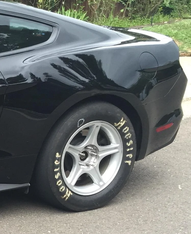

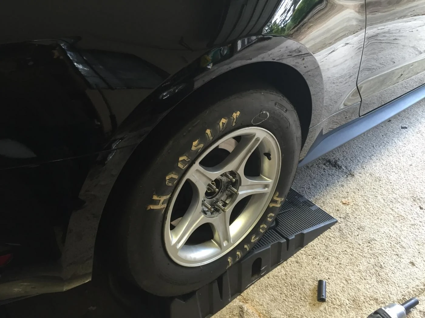

in short, nope. the rim lip will poke anywhere from 2-6mm depending on camber and ride height. so unless you want to stretch a 275 on there with some camber, no dice. theres plenty of mustang replica wheels on sale for $100ish that are 9-9.5" wide with higher offsets that will work. 10.5 wide will need a minimum 35 offset to tuck up under easily. theres a few threads about this

They fit. Use 305 drag radials. Looks are secondary for a cheap rag strip set up. There is probably better choices out there.

If you want cheap find a pair of 99+ GT forged wheels on Craigslist for 50.00 . 17-19lbs depending on the ones you find .
