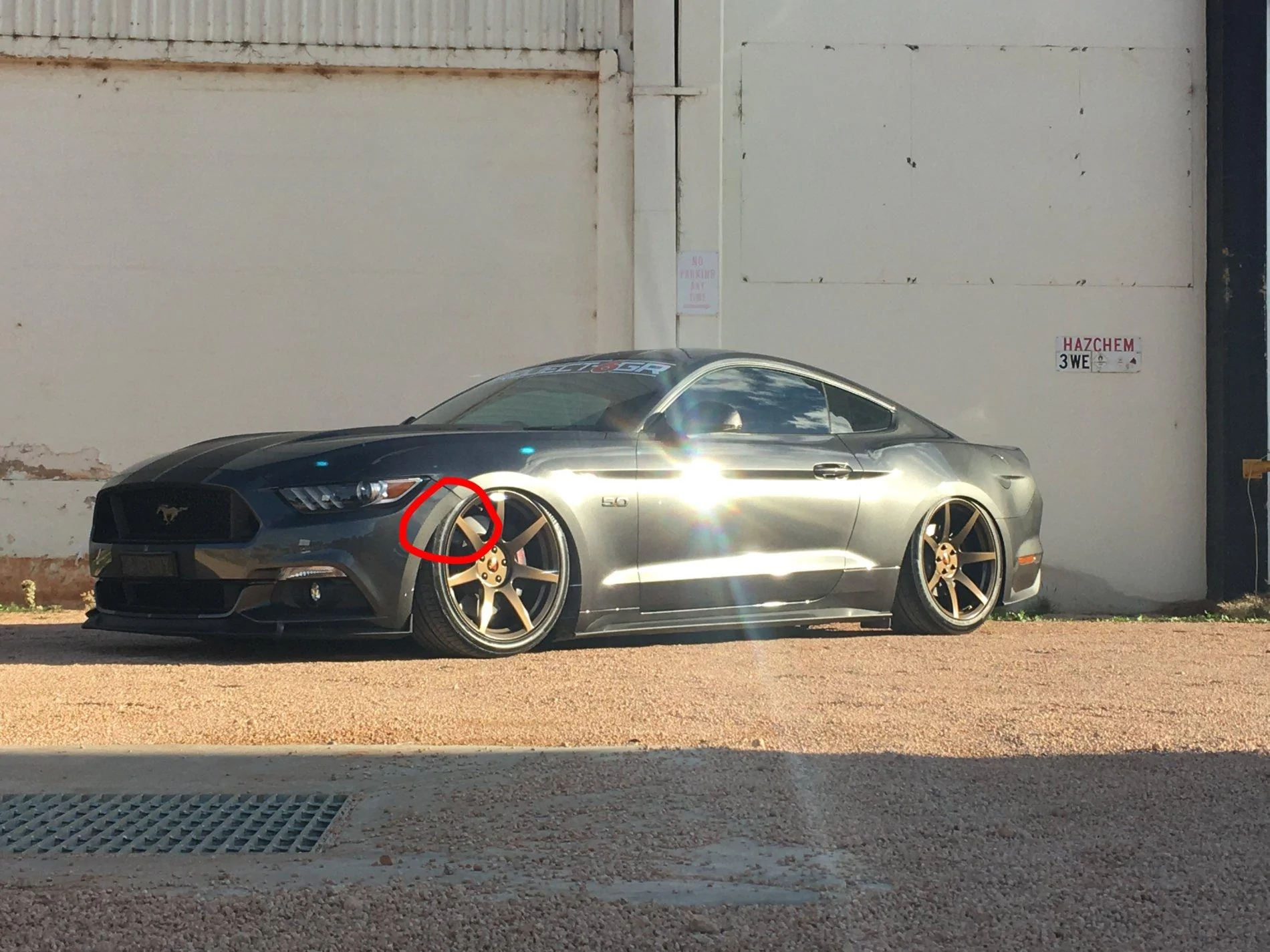

In my experience, the rears are less of a problem than the fronts.
I’m running Project 6GR wheels (10” +35 and 11” +50) with Continental 5p 275/35/20 and 295/35/20.
My daily ride height is 35mm below stock PP
Front camber around -1.8 rear around -2.2
Rears clear fairly easily, fronts not so much.
The problem area highlighted below.
YMMV.
