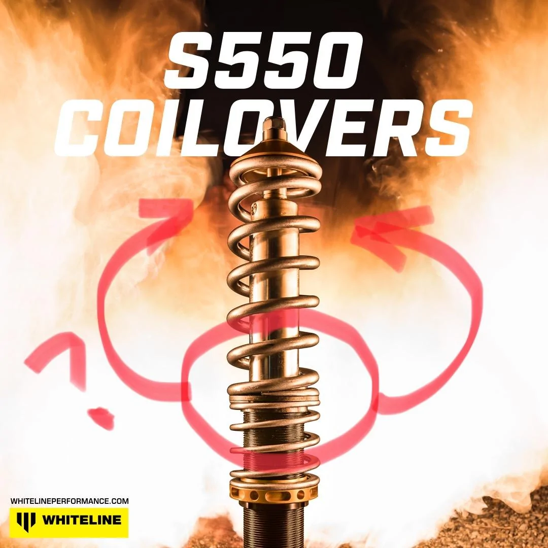

Looking at Roush KW3 or KW3 direct w second set of Steeda Comp springs, how do these compare?
Uhhh, dont we want the helper on the opposite end?
So the main/helper interface cant ride the threads?
Dunno?

Looking at Roush KW3 or KW3 direct w second set of Steeda Comp springs, how do these compare? More performance / track oriented than Roush and KW (Stiffer springs and valving)
So the main/helper interface cant ride the threads? The helper does not interface the threads even at full compression. Having the weight of the main coil ride on top of the helper can make ride height adjustments and corner balancing ever so slightly more accurate...
Dunno?
See responses above. We will also be racing the car in the Optima Ultimate Street Car Series this year. We have a full season of Global Time Attack on them through a customers car.
