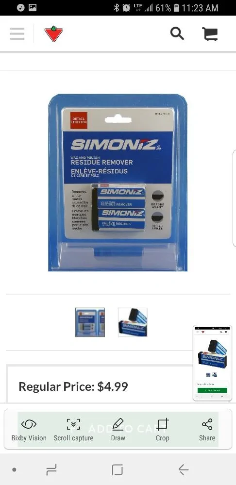

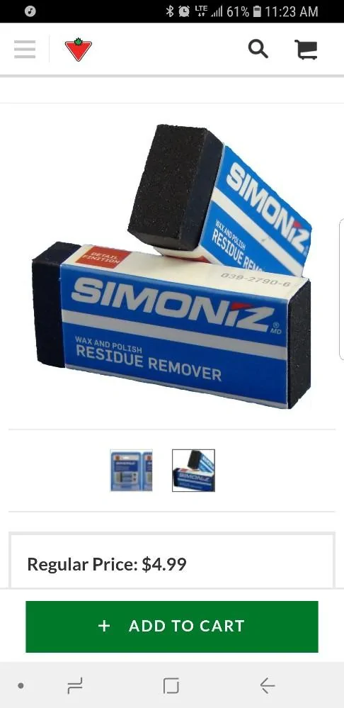

Simoniz makes an eraser type thing for cleaning wax and scuffs off plastic. Used it on my kick panel and it removed everything. Then a quick wipedown with 303 aerospace prorectant and it's good as new.
It doesn't state it's for scuffs but works awesome on them.
