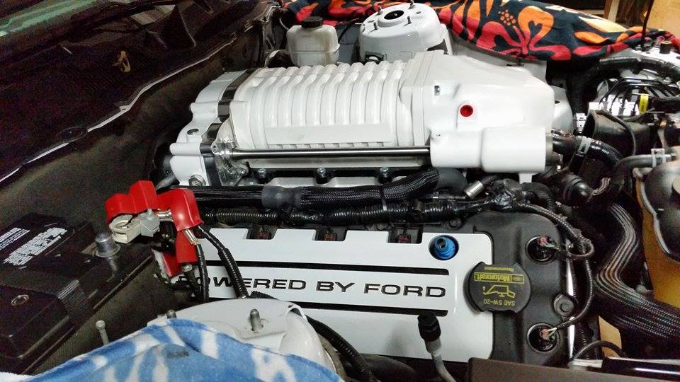

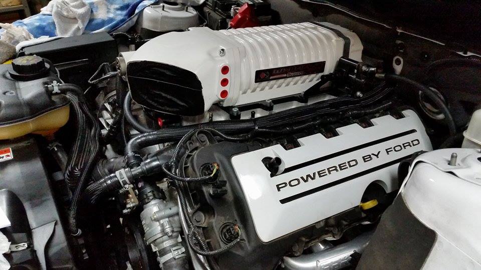

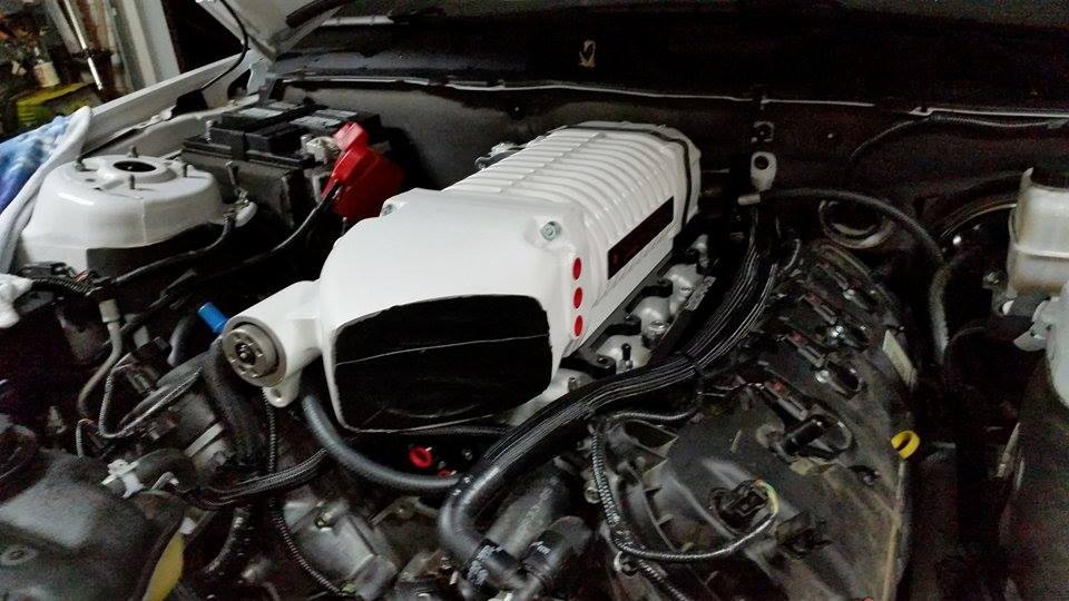

Let me just state here that the Roush/FFRP kit is a really nice kit but imho it really doesn't measure up to the Whipple with its front inlet, dual fan massive heat exchanger, massive TB, far superior intercooler, tune and over all fit & finnish. Please note this is my honest opinion and not meant to offend anyone. Might wanna check your numbers because when you compare apples to apples with the pricing between the 2 kits it really isn't a big price difference.
As stated you might want to consider getting the oil pump and cam gears changed but as far as the engine goes that should be all that needs to be done. As far as non engine parts I would recommend 1/2 shafts for sure and probably a better clutch at some point but doesn't "have" to be done. I also changed to MGW shifter and one piece driveshaft but again these do not have to be done. Wheel hop is something to be addressed but does not have to be done. Technically the Whipple out of the box is all you need and everything else depends on your comfortability and wants for your car.
Drivability with the Whipple tune is spot on. The car runs and drives as beautiful as factory. You most certainly can have stock drivability when not using boost. Fuel mileage will be slightly less due to tune and larger injectors but honestly it's not noticeable to me. Keeping your foot out of the gas is the biggest factor with fuel mileage lol. Yes you can REALLY feel the difference (when in boost). The car is just amazing to drive. The wine is not loud per say. It is such a joy to listen to and you will most definitely enjoy it lol. The factory vacuum gauge acts as normal until the boost comes on then the gauge drops to zero while in boost. I am still waiting for a good option for a boost gauge. I do not like the idea of putting one in the vent and am currently waiting for my ordered ecoboost PP vacuum gauge to swap in to see if it will work. I will keep you all posted on this.
The Whipple kit is a one and done kinda kit. No different stage but you can then build from there with say a custom tune, smaller pulley and long tube headers.
