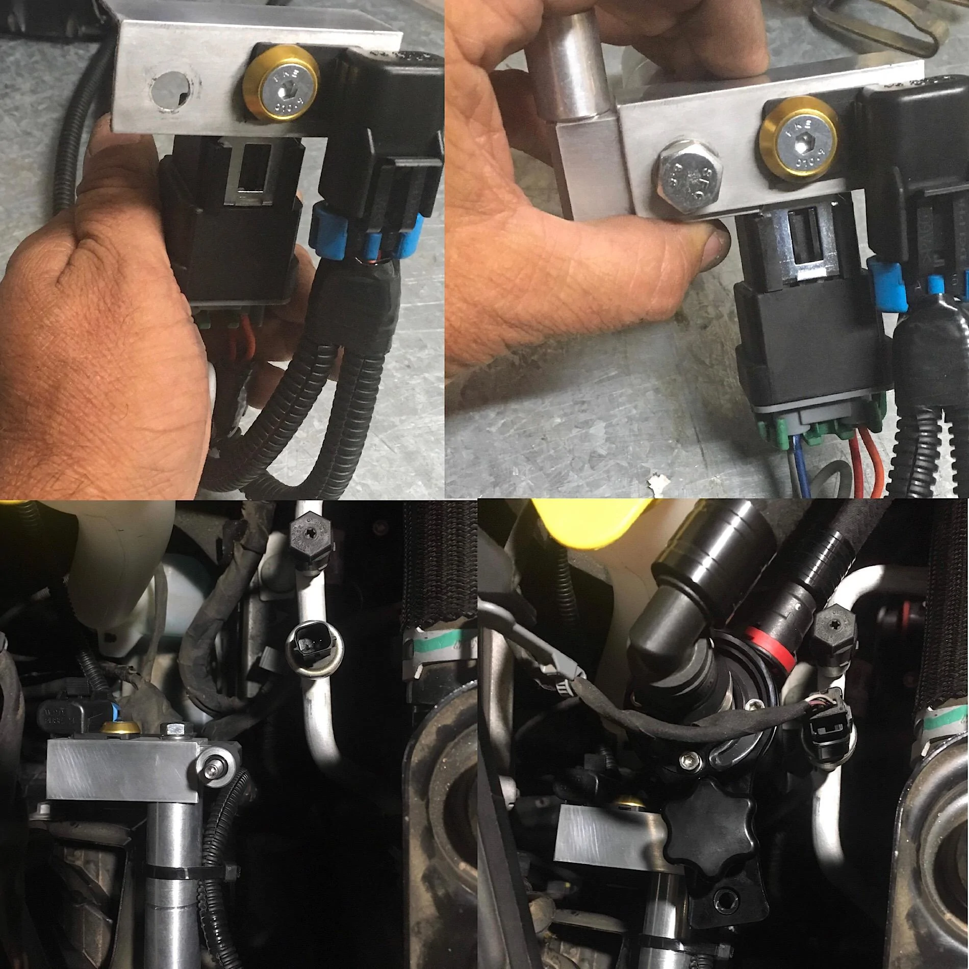

Where did you guys mount the intercooler pump relay/fuse? The instructions didn't say where unless I missed it.
Also, on the passenger side heater hose (front end) where exactly does the safety clamp need to be?? If it's needed?

Funny you should ask...
I just installed mine last night. I didn't like the position that Whipple came up with so I made a bracket and used the UPR catch can mount to hang it.

That looks good nice job fabbing up that bracket
