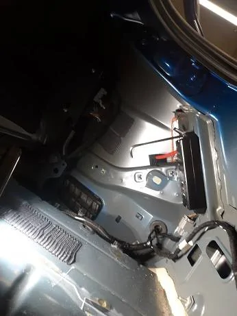

I am at the step where I need to wire my LE1 Fore fuel system. I need to mount the Solid State Relay and run the battery cable to the battery.
My car is not at my house to look over it. I am hoping for some insight
Is there an incognito place to mount the SSR relay.
is there a prefered way to route the 12v cable from the battery to the solid state relay/
Thanks for ideast

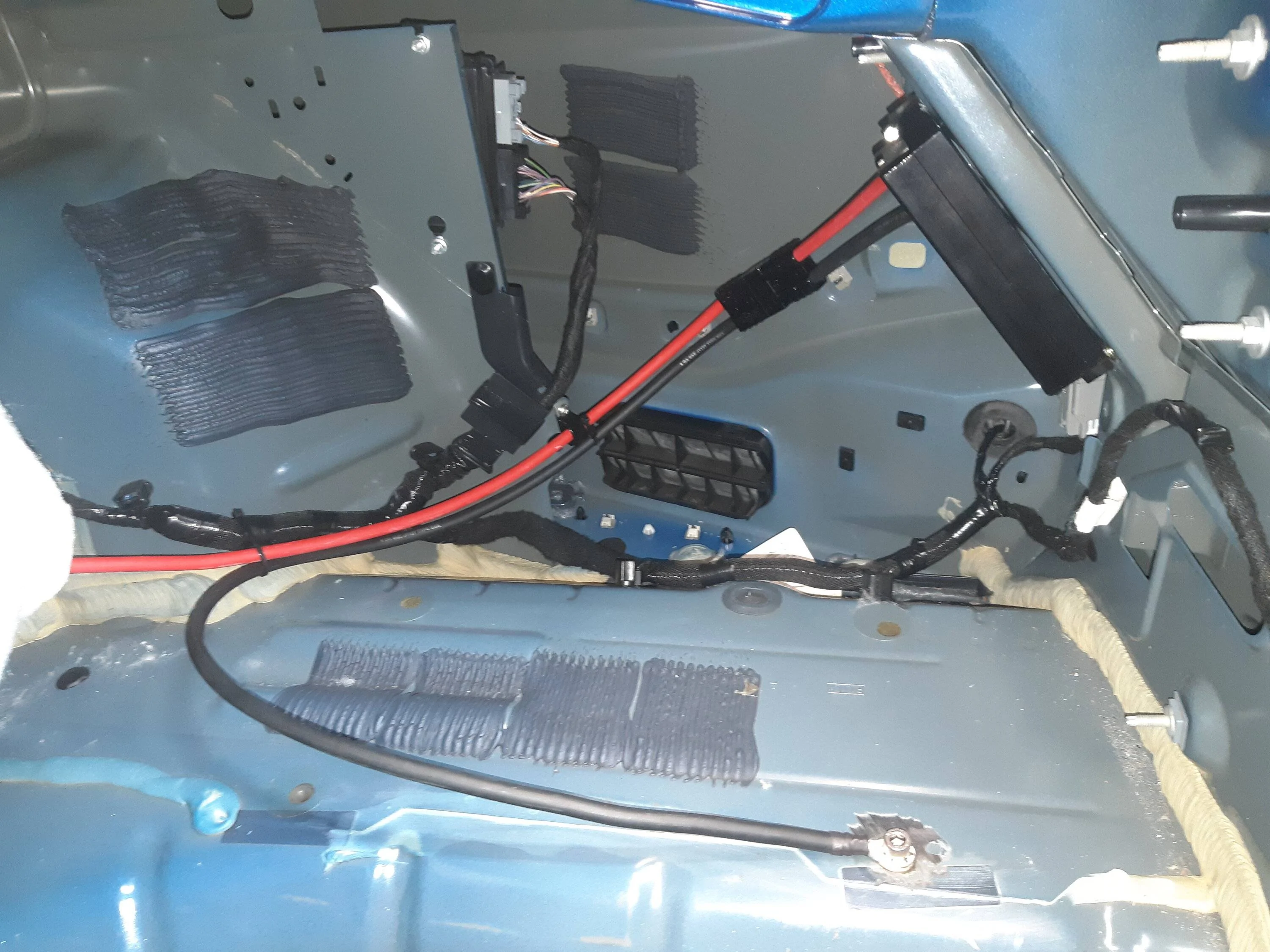

I will answer my own question. I put it in front of the passenger side tail light behind the inner liners. I'm going to run the cable up the passenger side and poke through the firewall below the battery tray.

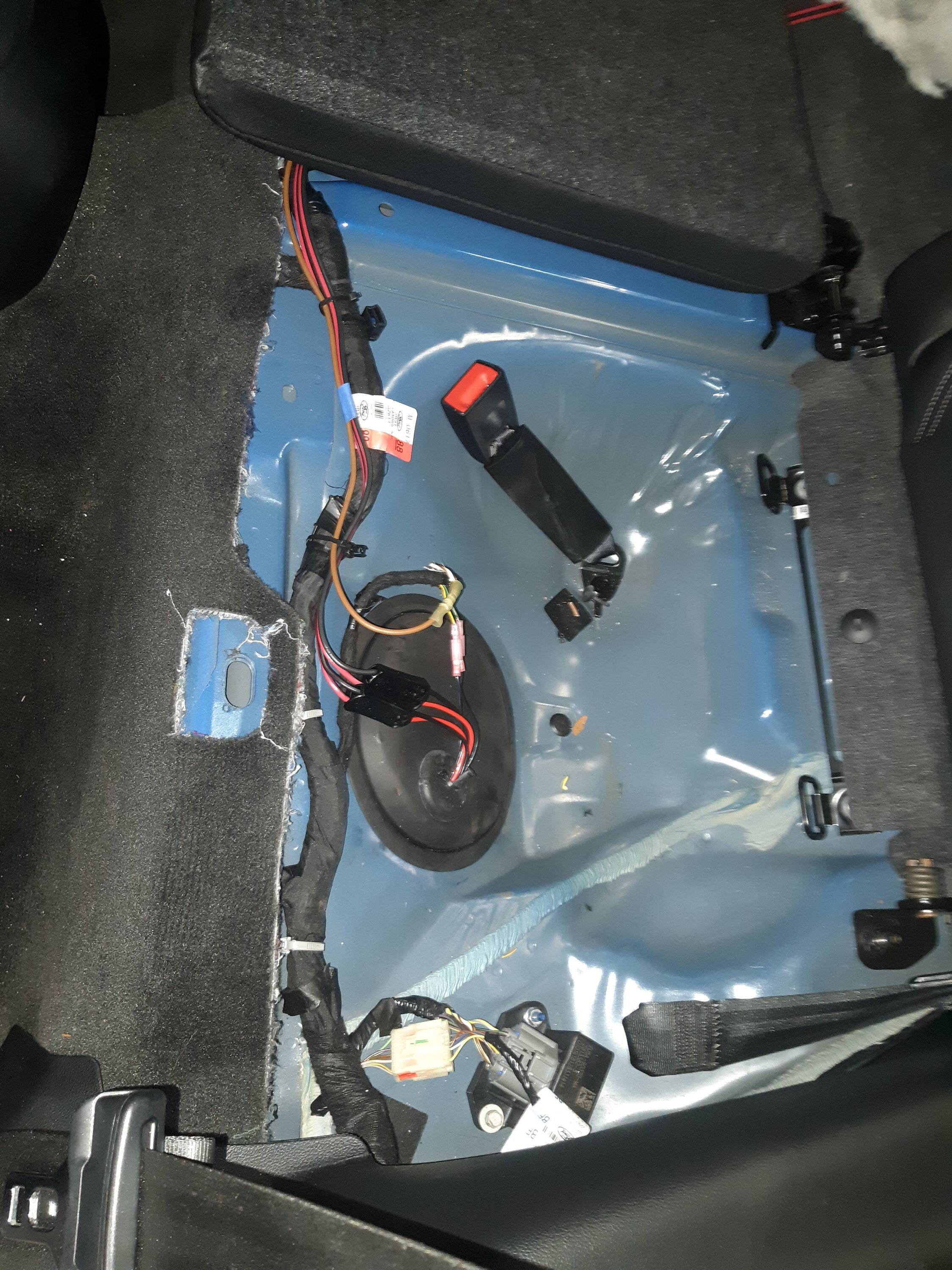

Under the package tray

Mine is under the backseat.

Now you tell me......lol
I was worried under the seat would get squished.
I am happy with the results. I think I have more time wiring it than I do installing it!
