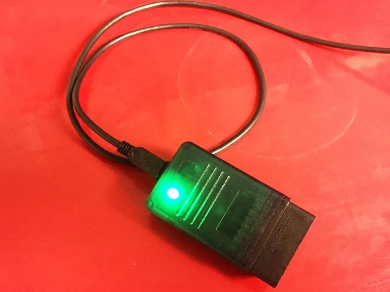

You have the old book. You don't need to send them the ECU. Call and order the flare tool and they will send it to you.

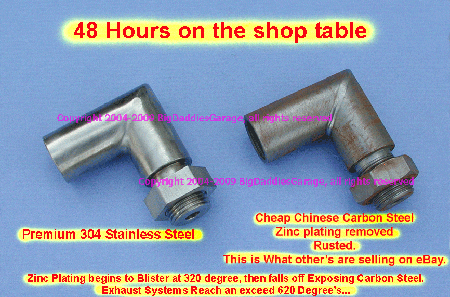

I have Stainless Werks catless headers and I run the Big Daddy's foulers with the Whipple flare/tune. No issues, no codes, no CEL.
