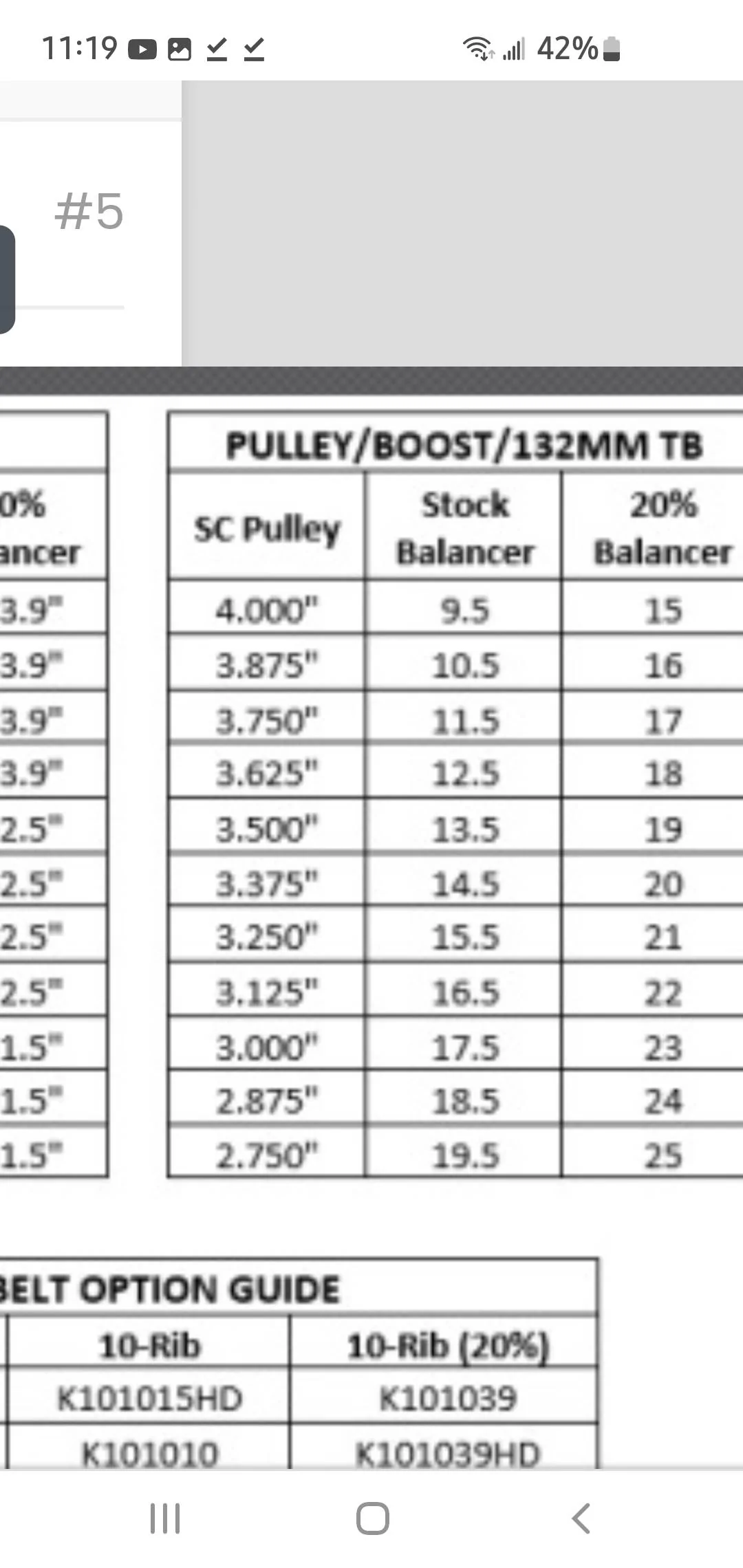

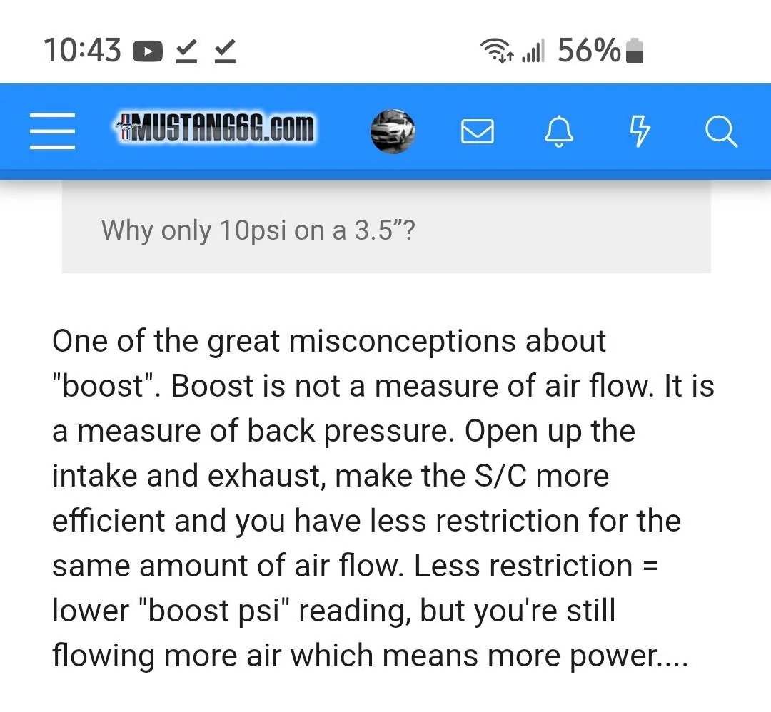

My question is because I have longtubes will this make up for the small difference in octane verses boost? I searched but closest I can find is this.(pic)I'm trying to find info in advance in case I have to buy a larger pulley. Plus I need to learn this stuff.

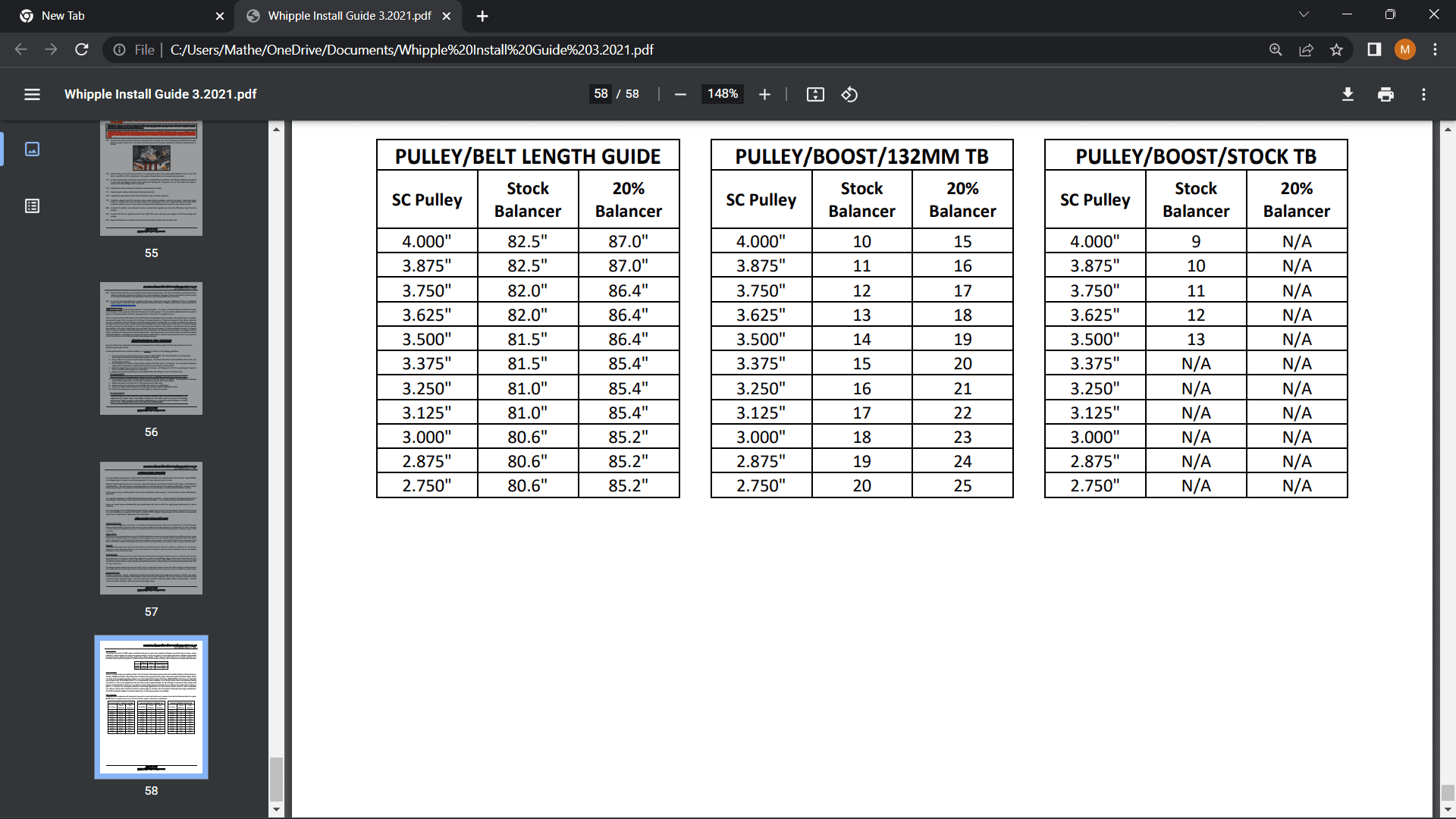

A 3.75 pulley on a gen 3 resulted in10 to 10.5 lbs of boost. It wasnt until the 2.9 gen 4 or 3L gen 5 that the moved to a 3.875 pulley to get the desired 10 to 10.5 lbs of boost

So this graph is for a
gen 4 - 5?
If so I'm good then?

This is the Gen 5 chart:

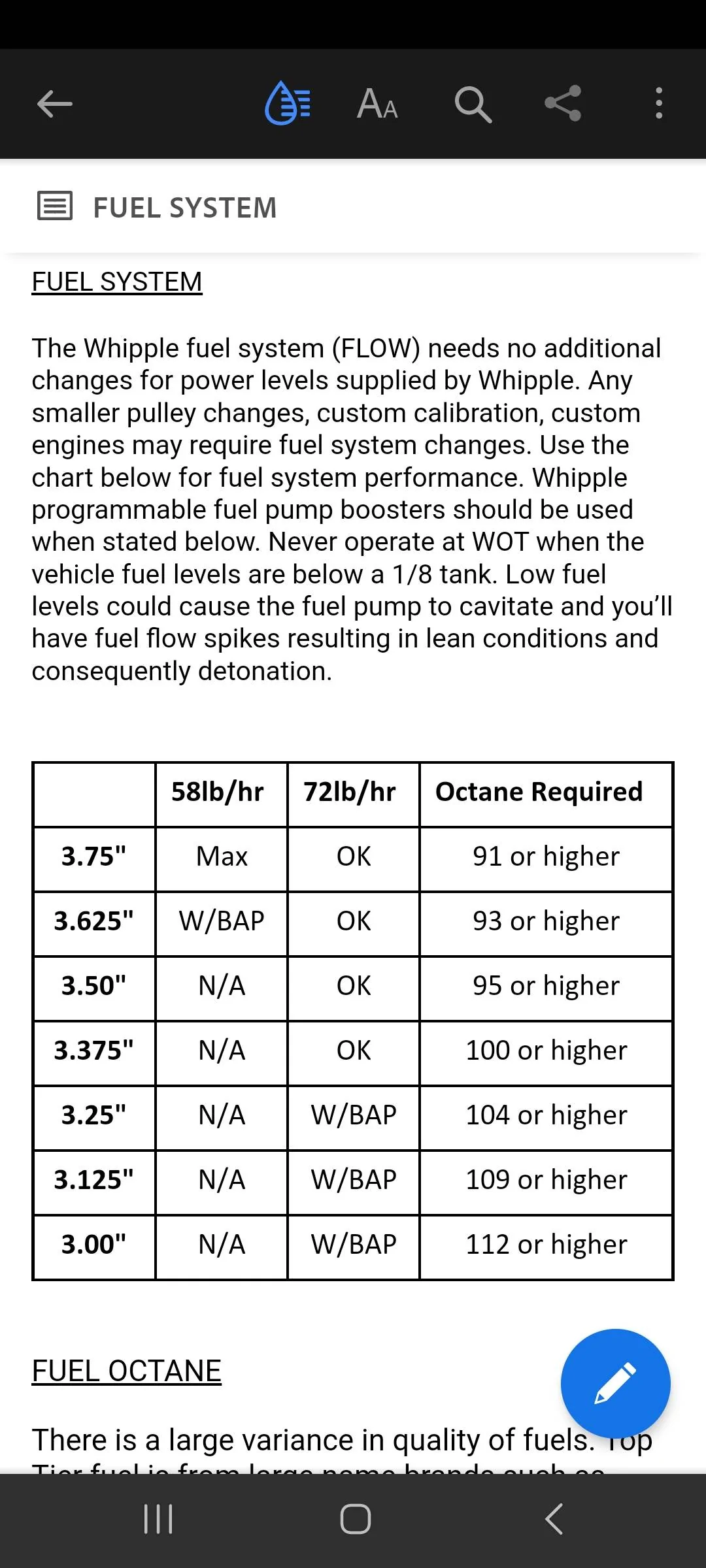

Here is the whipple recommended octane injectors and pully size for a 2015 to 2017 gen3 as well. You should have no issues

[/QUOTE Seems I was reading the wrong boost/pulley chart. I guess the guy that sold the kit to me added the larger injectors and pump because he had visions or more HP in the future.
Thx for clearing that up for me. 10.5lbs will be ideal for what I want to accomplish.
What I'm wondering is what effect longtubes will have.
They won't push the performance past my Octane limits?
How does that work?

You’ll be fine with that pulley on 91 octane.
