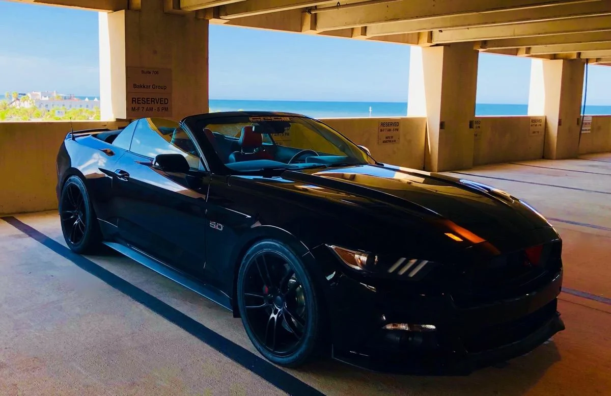

There are a ton of aftermarket options where the wheel has been properly designed based on width/offset/backspace. FWIW, I found 1" spacers a bit too much on PP wheels, I ran 25mm (front) and 23mm (rear), just slightly under 1" (but as small as you can go without contact on the stud pocket with Perf Pack wheels) and even those were a _touch_ too much.
My current setup is fantastic, 20x11 @ 50mm offset, 20x10 @ 35mm, they sit nearly flush, with just the right amount of inset to avoid rubbing and reduce the amount of crap kicked up on the side of the car.
Oh yeah, just to show how it sits vs. the rear 19x9.5 OEM PP wheel: it's 21mm further out (which should give you a sense vs. 23, 25 or 25.4mm spacers). Now of course since it's 1.5" wider (38.1mm), and 21mm is to the outside (of the wheel center), the other ~17mm is on the inside, and this where a properly designed wheel makes the difference since you have to consider clearance to the strut, etc.
Also, I obviously made the leap to a totally different tire setup as well, so that's a factor if you're trying to keep your OEM size tires or OK with replacing (I didn't want just more offset, I wanted a wider wheel/tire setup).
Sorry about the incremental edits, I'm also neck deep in some complicated code - anyway - final couple of things: get into the wheel tech area, there's a ton of good information, plenty of super helpful wheel vendors that can give you excellent information, PK Auto, MRR, etc.
... and lastly, because, you know, it's worth a 1000 words :D

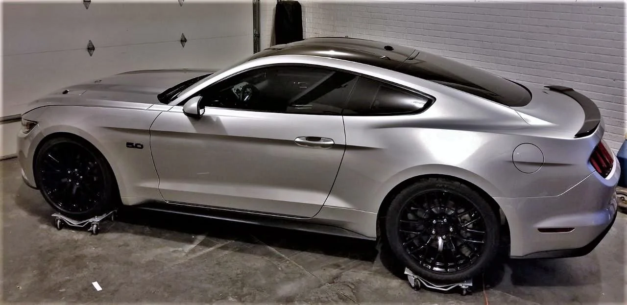

I am currently running American Muscle Performance Pack replica 19"x10" wheels with a 7.4" (188mm) backspacing wearing Nitto 305/35-19 rubber on the rear of my 2016 GT.
On the front I also have American Muscle Performance Pack style 19"x8.5" wide wheel with a 5.93 (151mm) backspacing wearing the stock 255/40-19 rubber combined with 25mm wheel spacer. This combo paired with BMR lowering springs give my car a perrrrfect stance, and fits the wheels/tires flush with the front and rear fenders.
Wish I had a better picture to post...
That's a __great__ photo, really captures some of the lines you don't normally see - I especially love seeing the side strake continue from the front fender, across the door, and then get picked back up at the back of the rear fender.

19x8.5 ET42.5
Thank you. I think the Ingot Silver color really shows the contrasts created by the body lines. I have seen other colors that don't do that very well. I saw a red S550 last week and that color blends the body lines into the body of the car, not accentuate them. While I'm not saying that red car was in any way "ugly", it just made the body lines harder for the eye to pick up.
