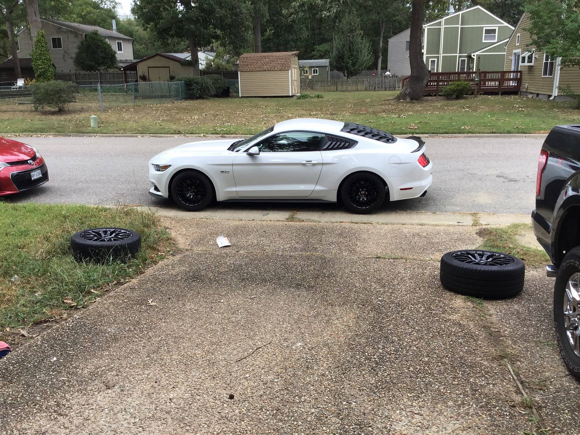

This is my 17 GT pp with 18x10 square and 275/40/18 Nitto NT05 all around, with RaceLand coilovers, dropped 3” in front and 2” in the rear.

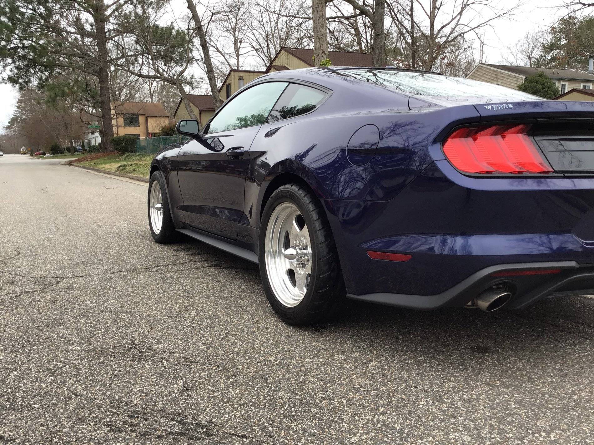

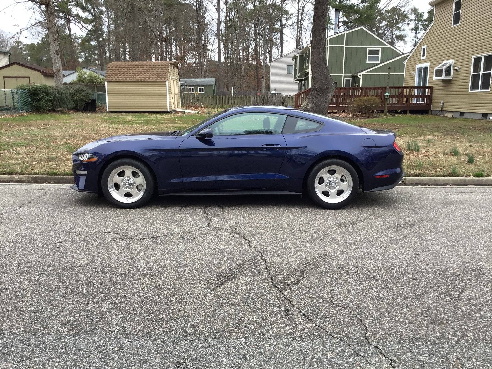

And this is my 19 eco boost with 18x9 front w/ 255/40/18 Nitto Invos, and 18x9.5 w/ 275/40/18 in the rear on stock base suspension.....so far lol! Offset on these centerlines is a foxbody offset. I’ve got some 10th anniversary wheels I’m going to try on latter this week too.
You kinda just have to decide what wheel your going to use and what look you want then do what you have to, to make them work.

....no it isn't. 1-1.5" drop at most.
The coilovers were put on just before the tire change and haven’t settled, the coilovers were measured against the OEM for height drop.
Just going off the picture and tire size you posted. FYI, a drop of that much will pretty much ruin your geometric stability. 0.75"-1" drop is the sweet spot for CG reduction and maintaining good roll center heights, migration and dynamic camber curves.
