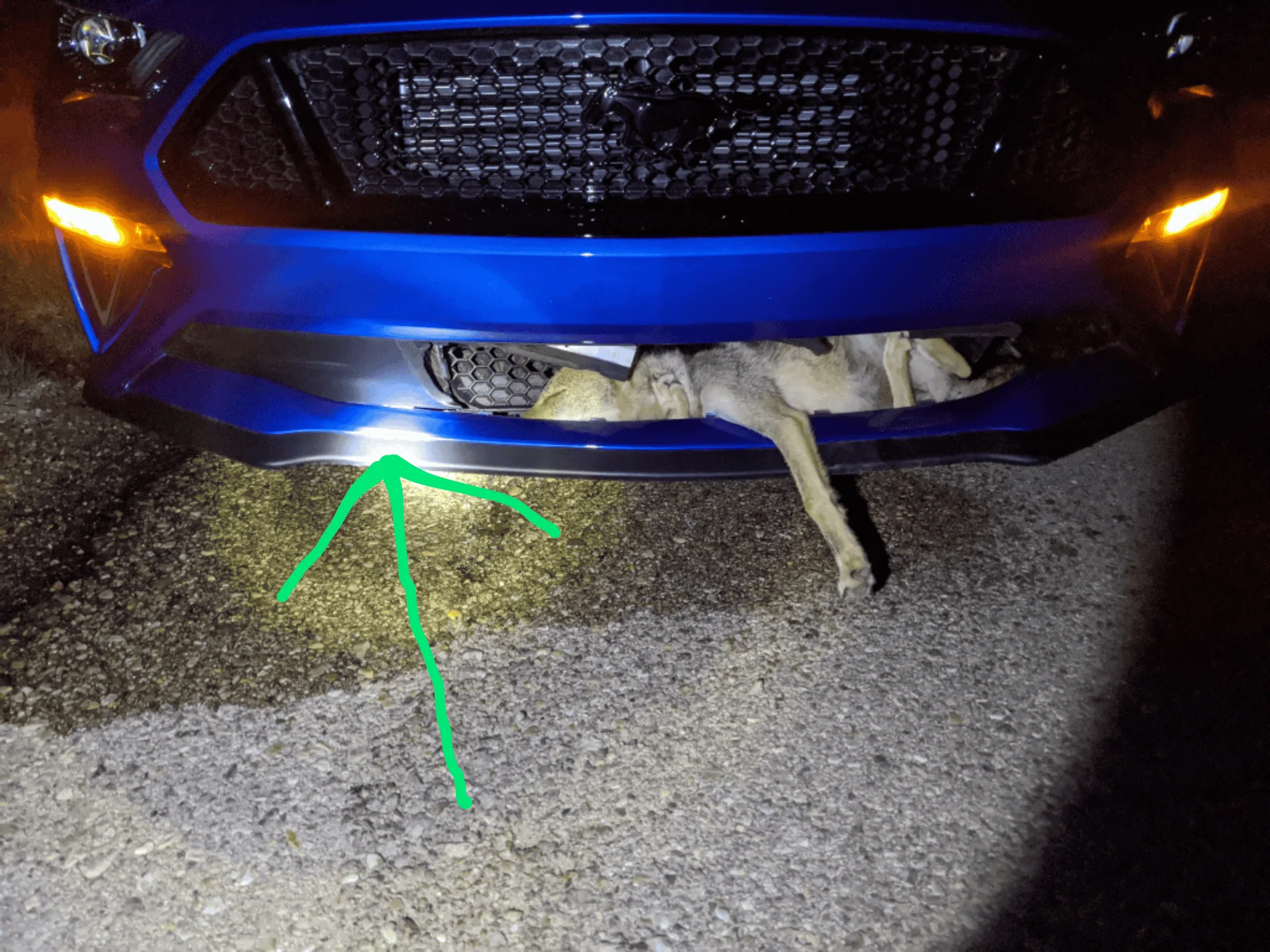

When I was younger I knew all of the subtle differences between years and trimlines of '94-'98 Mustang. Ok, I still do, but these new cars all look the same to me. I need to replace this little black lip. Will any OEM front splitters from a base, PP1 or PP2 fit? What is the best looking part to replace it with in y'all's opinion? Thanks, Jon
EDIT: My car is a 2020 GT base model.

You should be able to add the PP1/2 front lip if you add the PP lower splash shield. Ford part number is JR3Z-17626-B. It's a relatively easy install, just a lot of dang bolts. If you put on this splash shield/under cover, you can also run our front chin spoiler and a few others, so it certainly opens up your options!
Also, the fact that you didn't once acknowledge the coyote in your front grille makes this post kind of morbidly hilarious. I assume he was fine.
