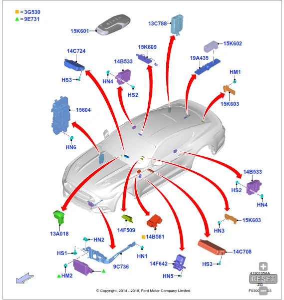

Pretty sure you need to access them behind the white moisture shields.
They are 14B533 in the diagram - LINK (be sure to enter your model year or VIN first). The diagram is under "related parts" tab:

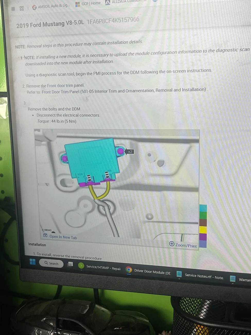

thank you for the response, I found out my car actually does not have one, I found the procedure in all data and noticed it’s not there because it utilizes a different door oanelwiring harness
