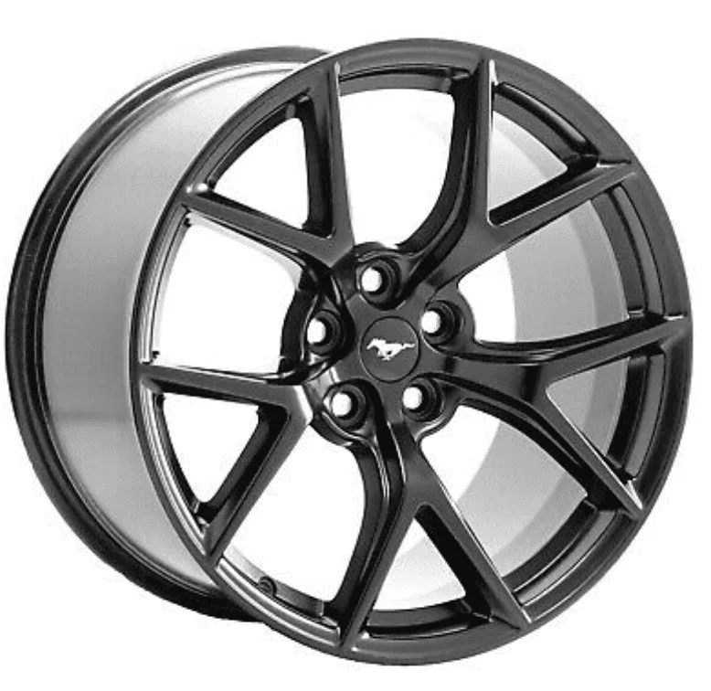

Here is the picture of the wheels. When i look them up on "My Garage" for compatibility it says that they would fit. But what do you think?

Tremor is F150 or Ranger trim. Ford OE wheels are heavy as hell and generally cast, not even flow-formed. For $800 (or less) you can buy 19x10/11 sets that are 10lbs lighter (each) than Ford wheels.
Those look like PP2 rims. 19x11et48 is what the PP2 specs for the rear. You have an ecoboost, run 19x10 square and be happy. IMO. Many a GT does.
are you going to the race track (road circuit)? If so you want 18x11 or 19x10.5/11 or 19x11 sets.
In any event force him to provide detailed/closeup of the casting markings on the reverse side.

I asked myself the same questions. But I think that "Tremor" referred to the "Tremor Package" that was used for PP2 2018 Mustang.

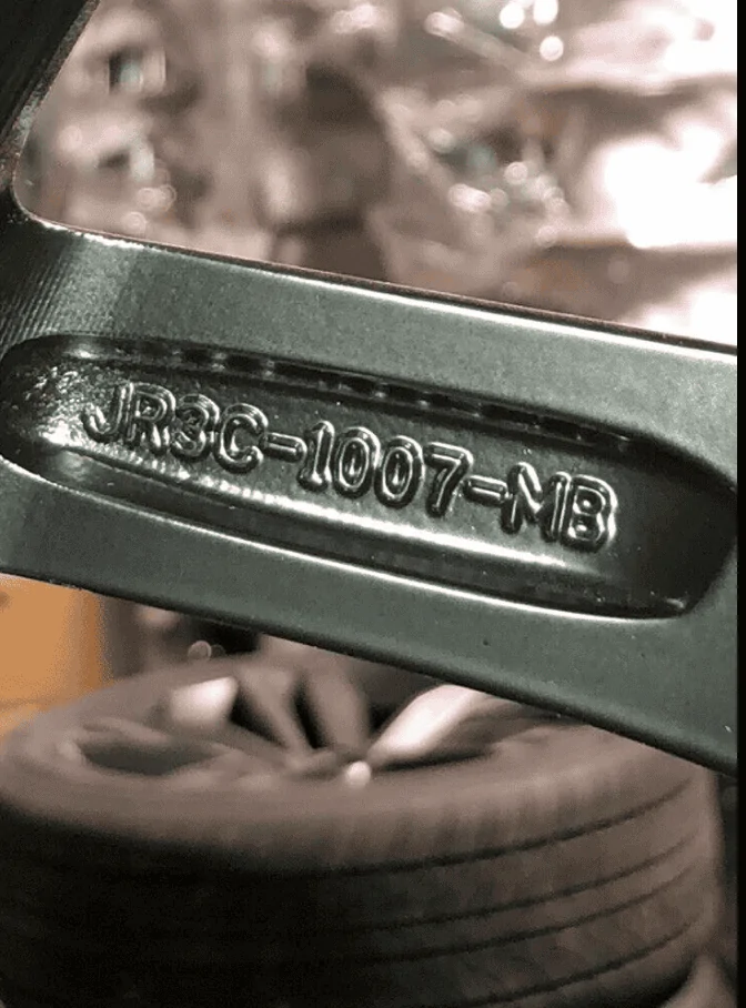

Here is the casting markings.
But I do like your advice about running square and just be happy. I'm not going to the track, just spirited driving. I just love the look of them.

You can get aftermarket PP2 wheels for less and they will be lighter as well. Someone else will need to chime in on offsets.
Thank you Bikeman315 for the tips and for your knowledge.

These are PP2 wheels. Not sure why but the Tremor name was attached to them.
If those are PP2 wheels, the fronts are 10.5 inches wide with +24 offset, not 9.5 with +40 offset as apparently was represented to the OP.
