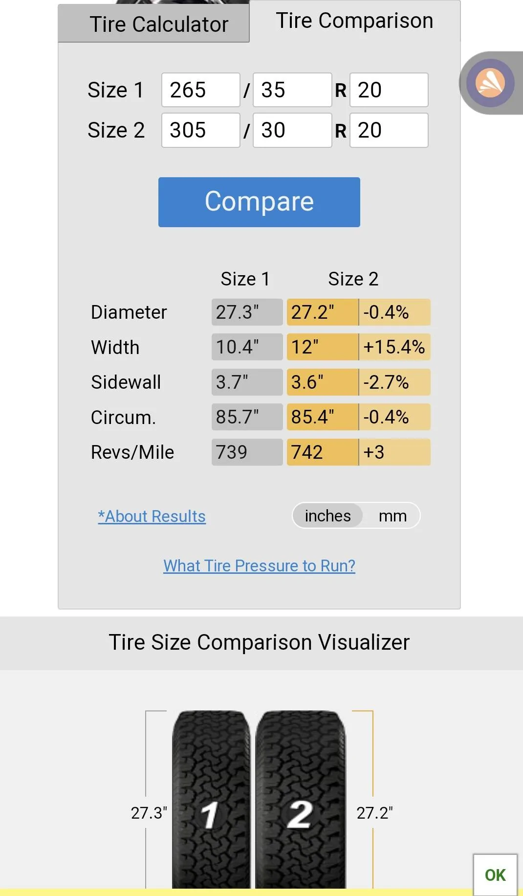

Going with 265/35r20 in front and 305/30r20 in the rear would be a good match for sidewall and diameter.
