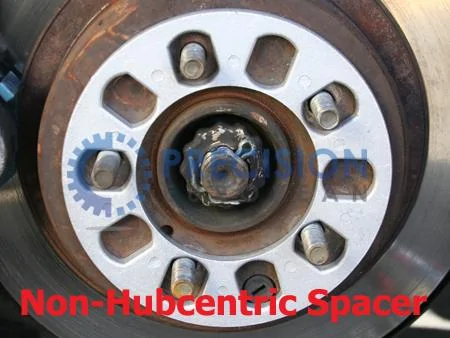

Well I meant the ones I have currently on there are generic like this below. It's not hubcentric and juggles on the studs. Was in a pinch installation day and autozone generics.
Versus a hubcentric spacer with specific stud holes. I figure hubcentric with tight hub holes are better?

go to a 5 mm and the generic are fine man IMO
Ya just letting you know for future Essen orders, maybe there are tolerance differences on the hubs or somewhere there, but 3mm won't fit all apparently. :thumbsup:
Good deal then, I didn't know if generic like that cause vibrations since they may not be perfectly centered.

if it s a good generic your fine brotha

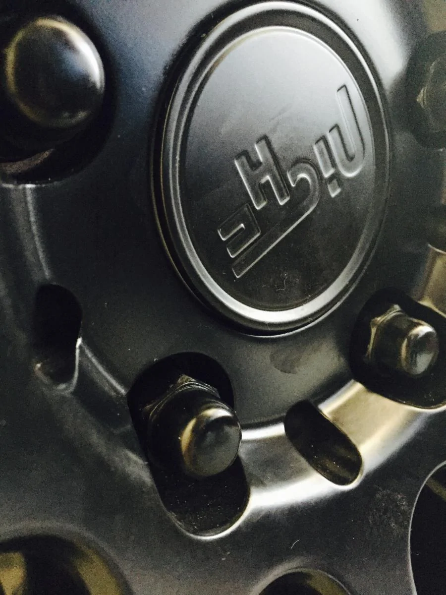

Frankly I'm at a loss here. Got my 5mm hubcentric spacers in and the grease cap is still pushing against the center cap slightly. Doesn't make me comfortable. As you can see in the pic is very slightly pushing on it. The slight gray on the left of the center cap is the side of it popping out a tiny bit
I've seen 3mm which weren't close, 5mm that the grease so is rubbing, and been have 3 sets of spacers now including the 5/16 generic ones a pic a few posts back which make me think is going to give vibrations being loose lug centric
I'm at a loss. I guess back to the 5/16 generics (about 8mm). I did re-seat the hubcentric rings into the wheels and then onto the hub; before I had backed them fully on the hub and then put the wheel on. It seems to look a bit more on the hub now at least.
I even tried to get new shorter grease caps http://www.etrailer.com/Grease-Caps/Fulton/F001606.html and they are just a hair too loose like under .5mm. They would fit perfect otherwise though but I don't have the tools needed to modify them (Or the stock ones)

Brotha love tap the cap in a bit, my guys running the AG 20x10 fitments have done that its not bad to do that just for your sanity so it sits in all the way on the cap.

I tried that but it's really resting on the dust cap tight. If you push on it the other side pops up. It feels like .5mm short
I just went back to the 5/16 (8mm) spacers for now. If I had a press or a better hammer than a rubber mallet in the garage I'd squish the dome of the dust cap and get the 5mm on easy.
I'll prob buy a ball peen and smack it this weekend to get the 5mm on. They fit a little better and feel a bit safer
