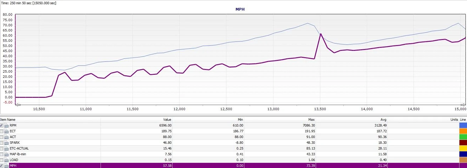

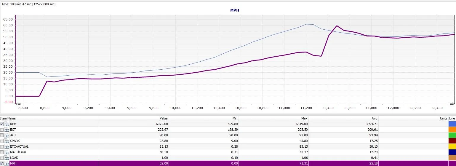

***Below images are two exact same cars. Both GT PP cars, both on the same wheels and tires (drag radials)...both launching with launch control at 3000 RPM with Advancetrac/TC OFF - - ALL variables the same except the smooth curve is with RLCA bearings (BK081) and the wavy graph is with stock RLCA bushings***
