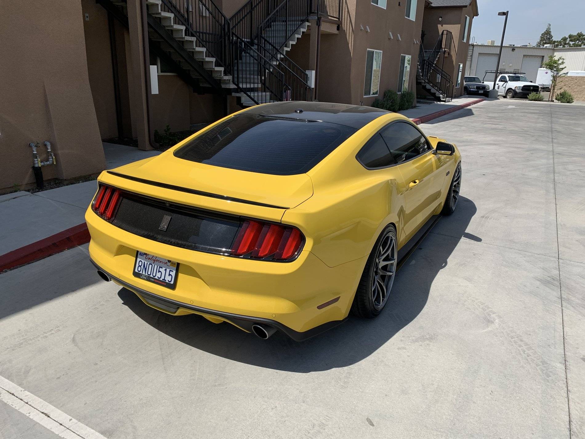

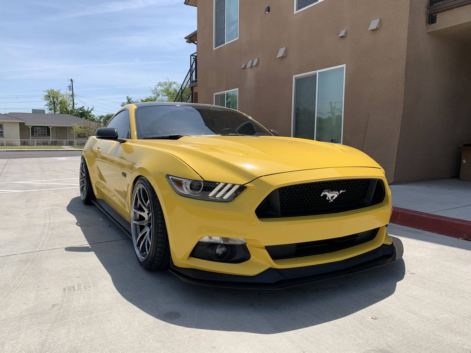

NOT my car. Was posted lasted month by another member in the Aggressive Fitment Thread. I want these exact wheels. They are Kai Reps. Aodhan, ESR, Vordhoven make this rep wheel. I just didn't think a 19x10.5 +22 square would fit so perfectly as these photos depict. Anyone have something similar? What is your suspension setup/ specs and what it took to get them sit flush? Camber? Would a 285 35 19 fitment work (the OP is running 275 and I can clearly see the stretch). I just want this wheel and this fitment. It's the exact look I have wanted since I have owned my car. Anyone help or thoughts would be appreciated.

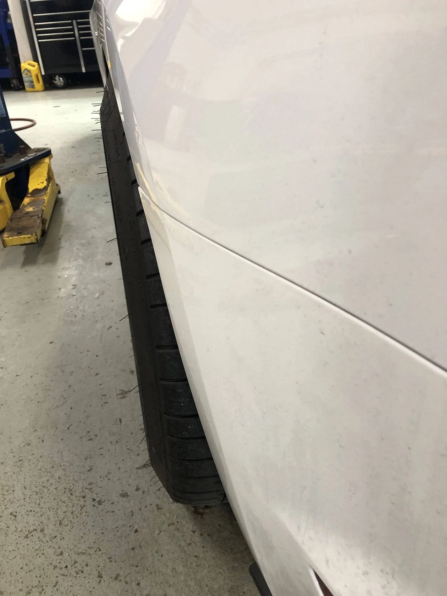

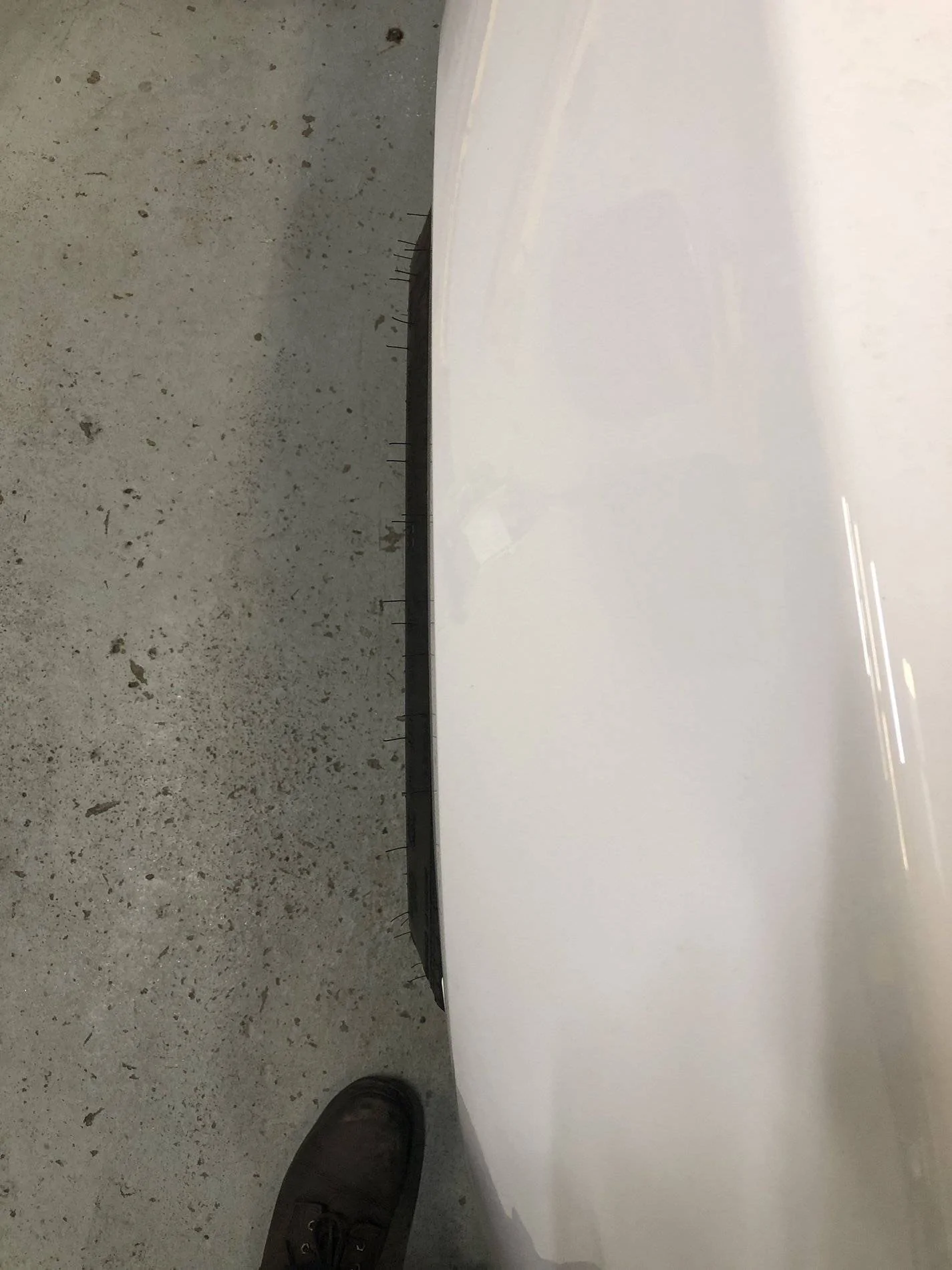

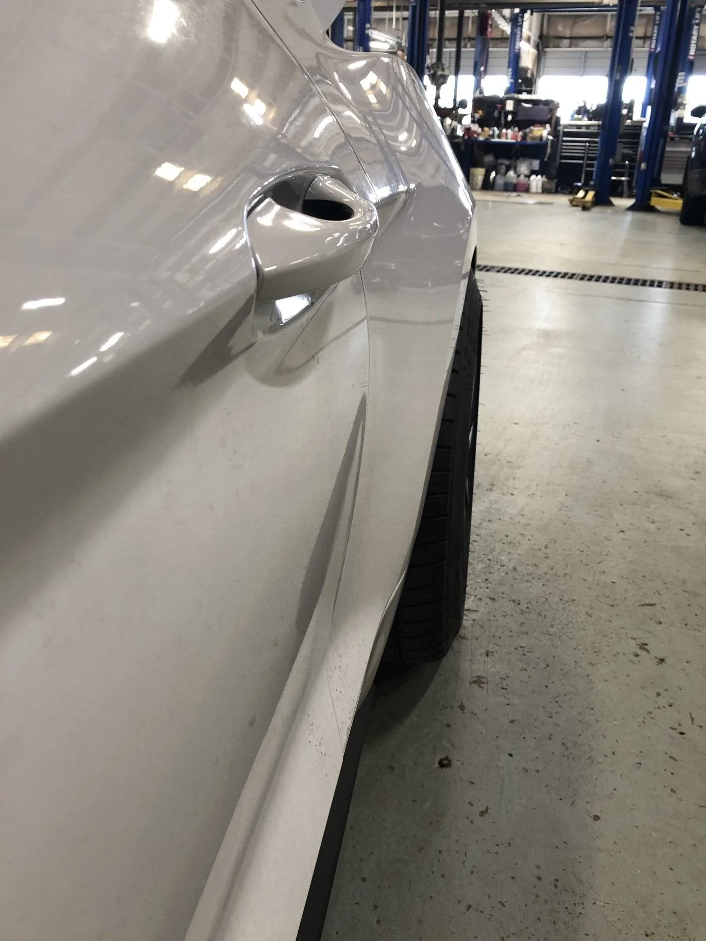

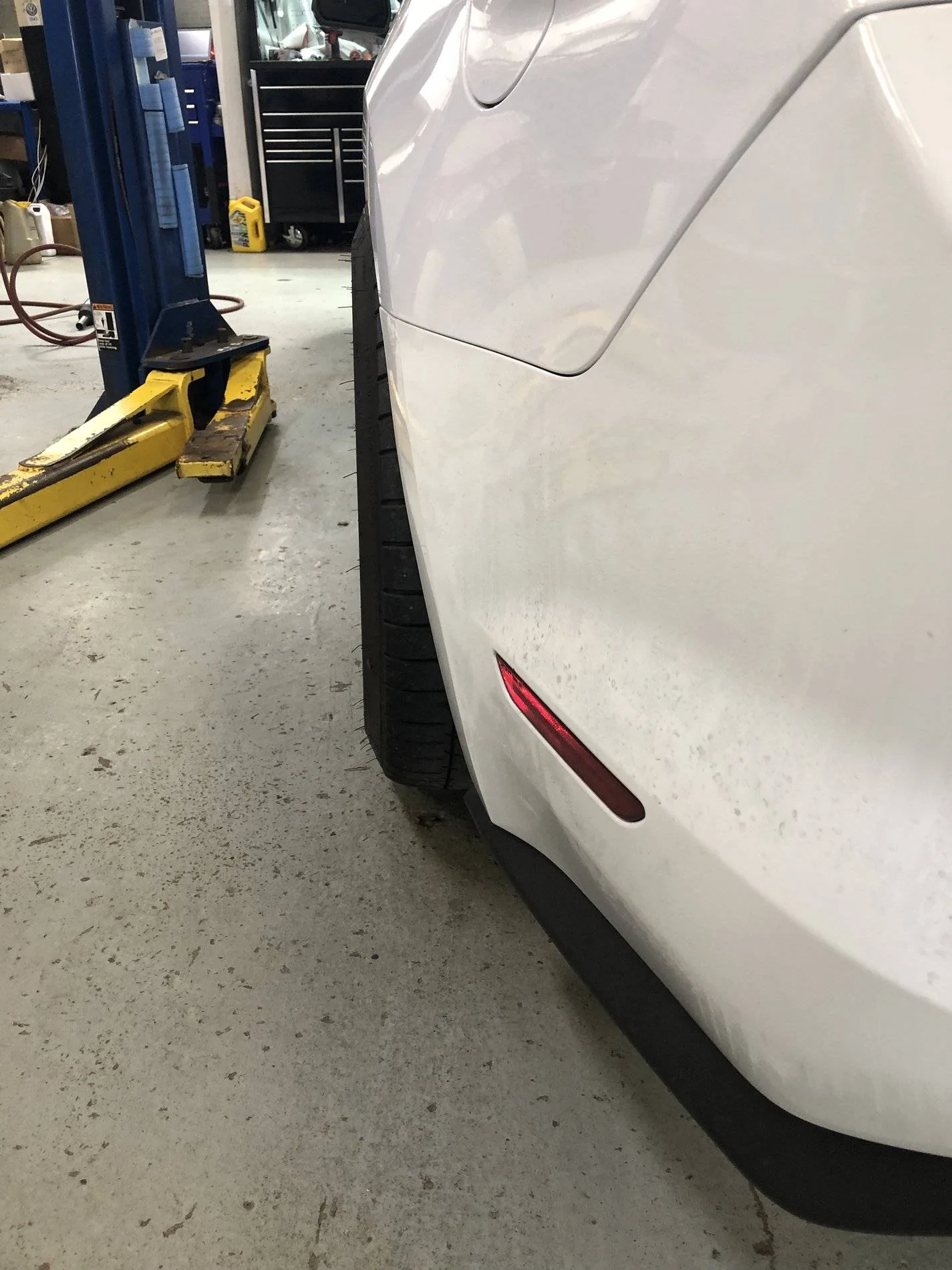

You need a good amount of camber to get a 10.5 +22 to fit. Most aren’t into the whole ā€œstance/tuckedā€ mustang thing, so your replies will probably be slim. Also depends on what tires you use. Not just the size, but the characteristics of the tires. The actual Work’s come in 10.5 +30 I believe. I’ve seen a few pics of 10.5 +30 wheels with firehawk tires and the fit in the rear was good. I had 10.5 +30 gt350 wheels (with the factory 295/35 MPSS) and they poked in the rear. Mainly because of the large wheel protector built into the tires, and that was with -2.2* camber. Pics below

I’d just go with a 10.5 with an offset somewhere between 20-30. Lower the car to the ride height you’re looking for, then have e camber adjusted to get the fitment you want. With how low that car is, they already had a ton of negative camber so there probably wasn’t much adjustment made
