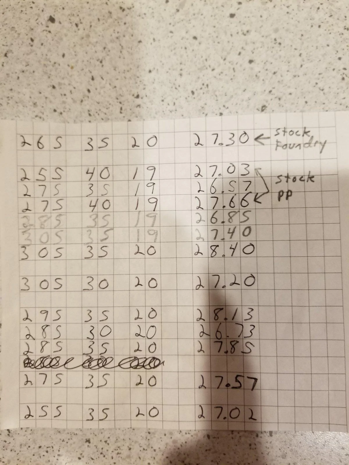

OP, here is the overall diameters for a bunch of different sizes. I got bored and made it a while back. Also I made a thread about tire sizes but not very interesting, you could search it. As far as rim/tire size I just recently been convinced by Bmacil to not go too wide on a rim. So your above sizes would be correct. From what I have been told, basically a 275-285 tire for a 10 inch wheel and a 305-315 for a 11 inch wheel would be good. Of course each tire manufacturer is different. Personally I just decided to go with a Firestone Indy 500 275/35-20 tire on a rovos Pretoria 20x10 et 38 rim for my sqaure summer set up. I never ran Nittos and people either seem to love or hate them so I went with the Indy's because no one hated on them. Good luck!
