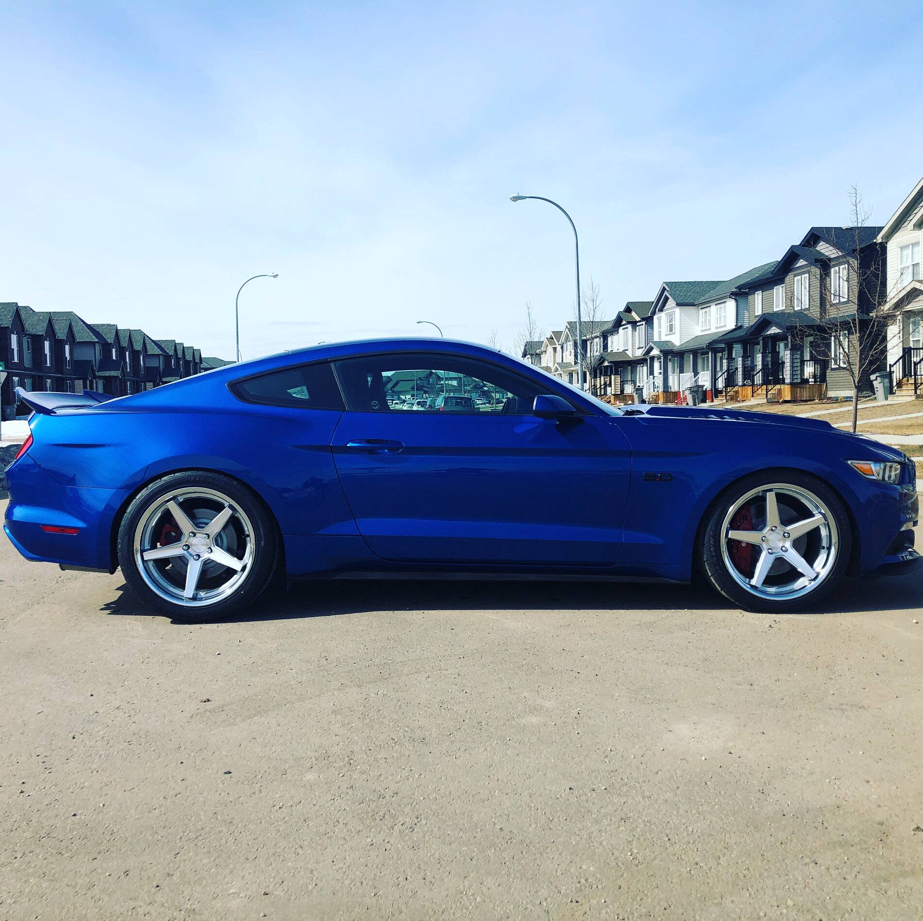

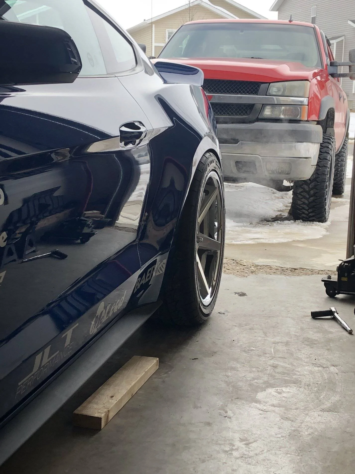

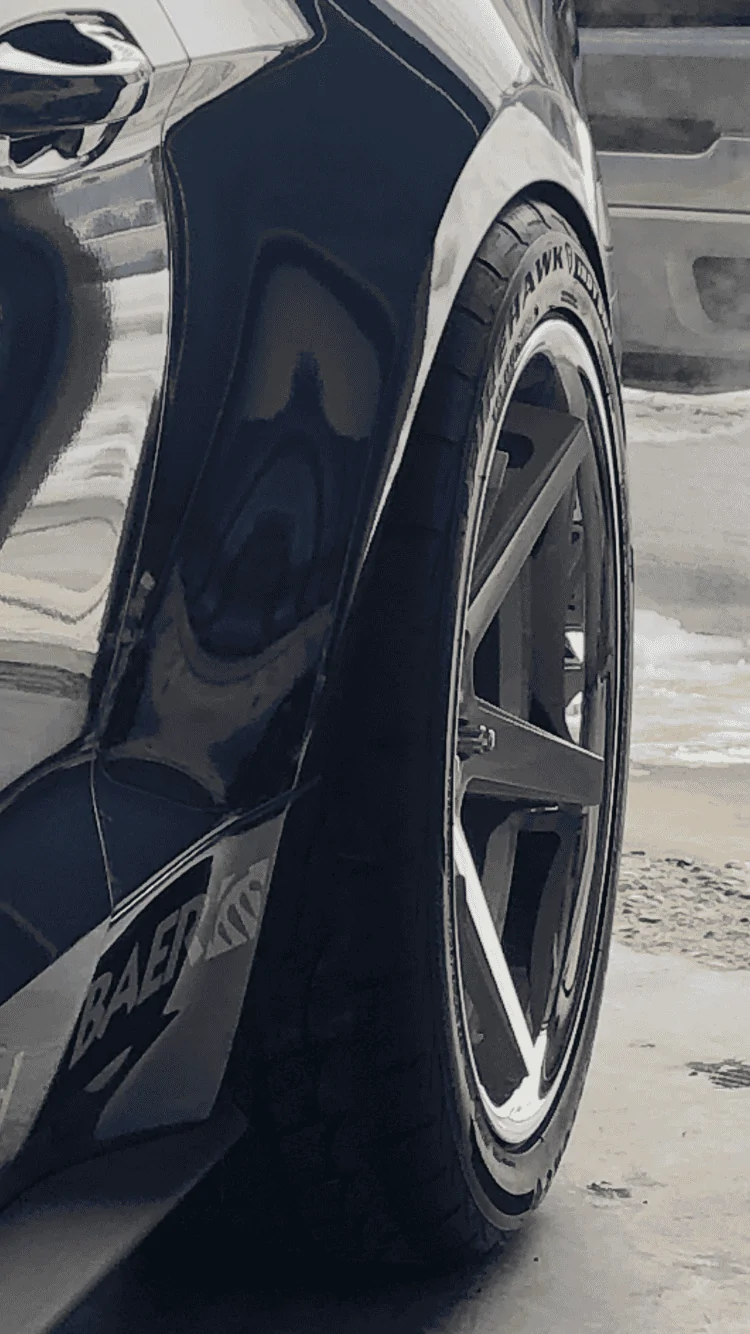

Hey everyone , got a 2017 roush charged gt , one inch steeda drop with new ferrada fr3 20x10 +40 and 20x10.5 +38 285/35 and 305/35 rears put steeda camber kit in still rubs with -1.5 love the looks of these wheels but they dont fit or work on 750hp car , whats gonna fit the rear , stretching a 275/35 tire ?? Im lost or ditch the ferrada wheels n get project 6gr with proper offsets that will fit a 305 , thinking that ferrada wheels on a s550 are just for show ??

Yep, not a great rear offset is it?
You could go to more rear camber (-2deg) but you won’t gain any grip, and I’m not sure it will solve the bad fit anyway. Probably more camber and a smaller rear tire might be enough, but getting a proper 11” rear wheel with correct offsets for this platform would be the right fix.

Those wheels have the wrong offset. You need about -52mm to make it work.
