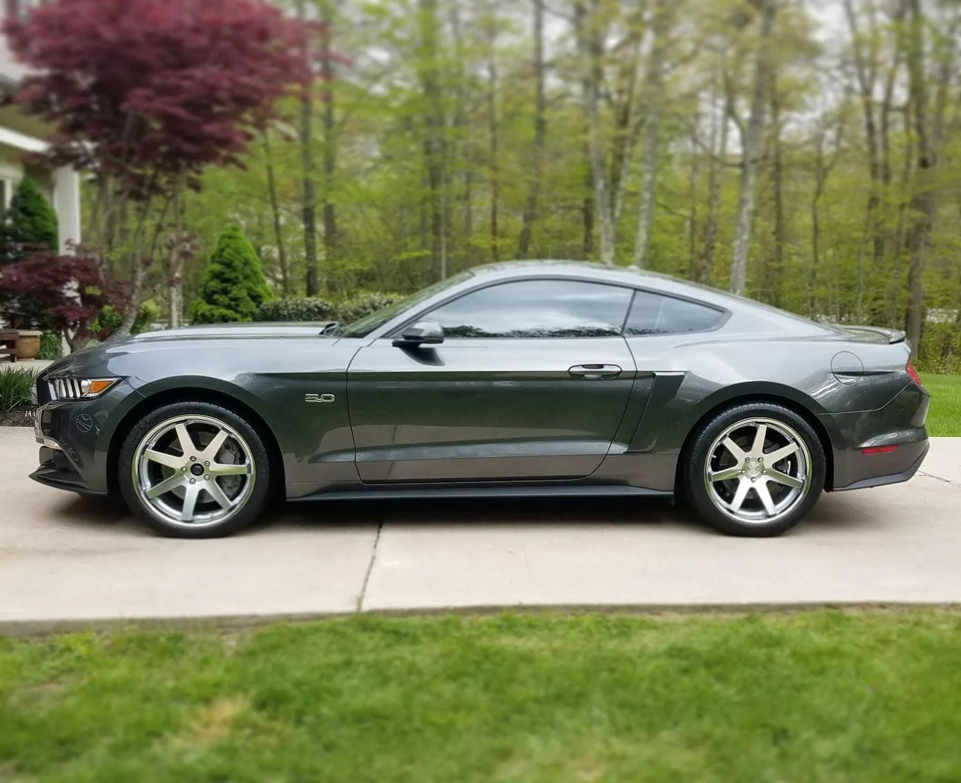

I just bought FR1's, same size (20x10.5) and went 295/35 instead. Looks like plenty of meat for my liking. I'll send you a pic later tonight (because UPS only delivered 3 rims for some reason!?!?!?!)

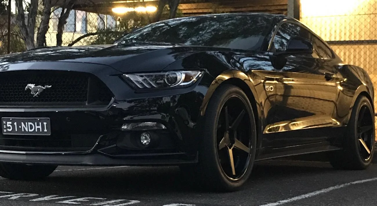

So, I finally went with Front 275/35/20 and Rear 295/35/20 Nitto Invo
I am in Sydney and the roads arent really the best. so to be safe I went with 35 profile.
I am second guessing myself and should have gone with 30 Profile.
