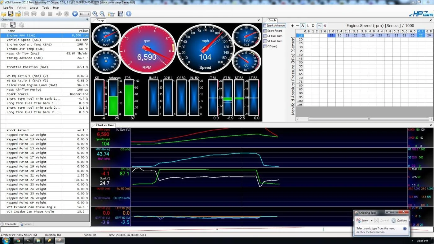

Have you checked to see if you have any false knock from maybe the exhaust being loose?
Yes, I can send you logs if you wish. Sometimes I get a little knock but it's not repeatable. I took some timing out just to not get knock.

What do you change? I run HP tuners.
Do dial in VCT you have to bracket the cam angles. Set exhaust to 0, start at 0 and advance your way forward on the intake cam until max advance and see where peak is at all RPM breakpoints to determine an intake cam phasing profile, then with the intake set, you retard the exhaust in the same manor, then build an exhaust cam phasing profile. Then you have your VCT dialed in for your setup. It takes time. Imagine a dyno pull for each cam position.
Your not running headers so it's odd your seeing false knock.
Kris
I have cat-deletes.
