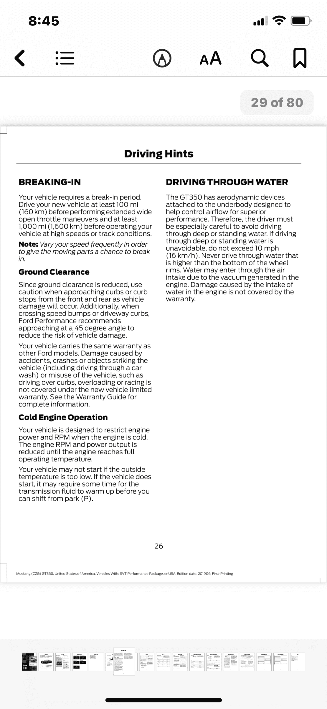

Here’s what the manual says. Vague enough for you? Looks like nannies are built in to protect us from ourselves.

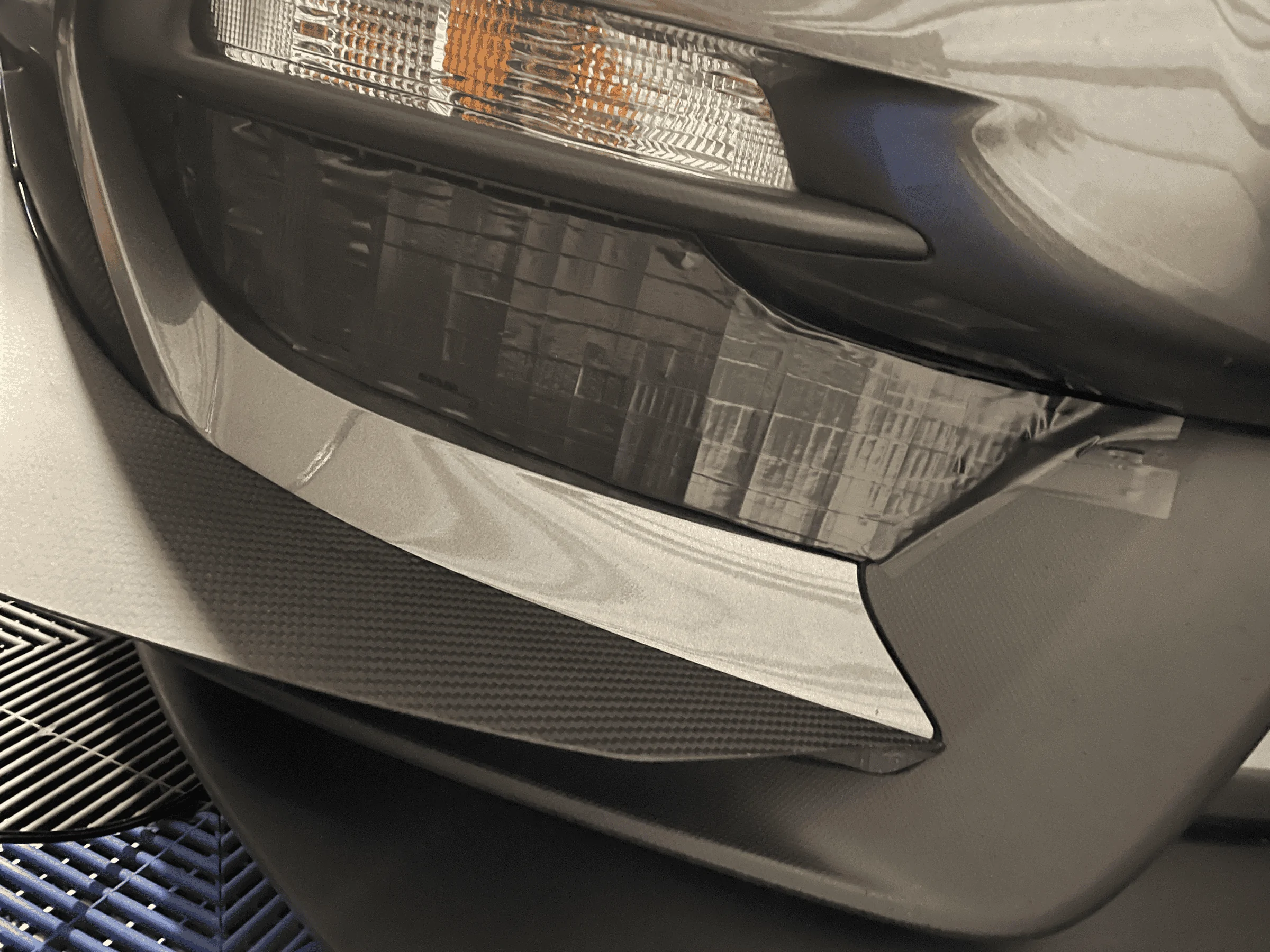

I've been dailying mine through the Midwest winter and used black painters tape to cover about 80% of the oil cooler grille. It's been helping a lot on these colder days, though the oil temp still never gets above 200F.
I crafted a simple cover for both the engine and trans side. It definitely does help and make my winter drives more enjoyable.
