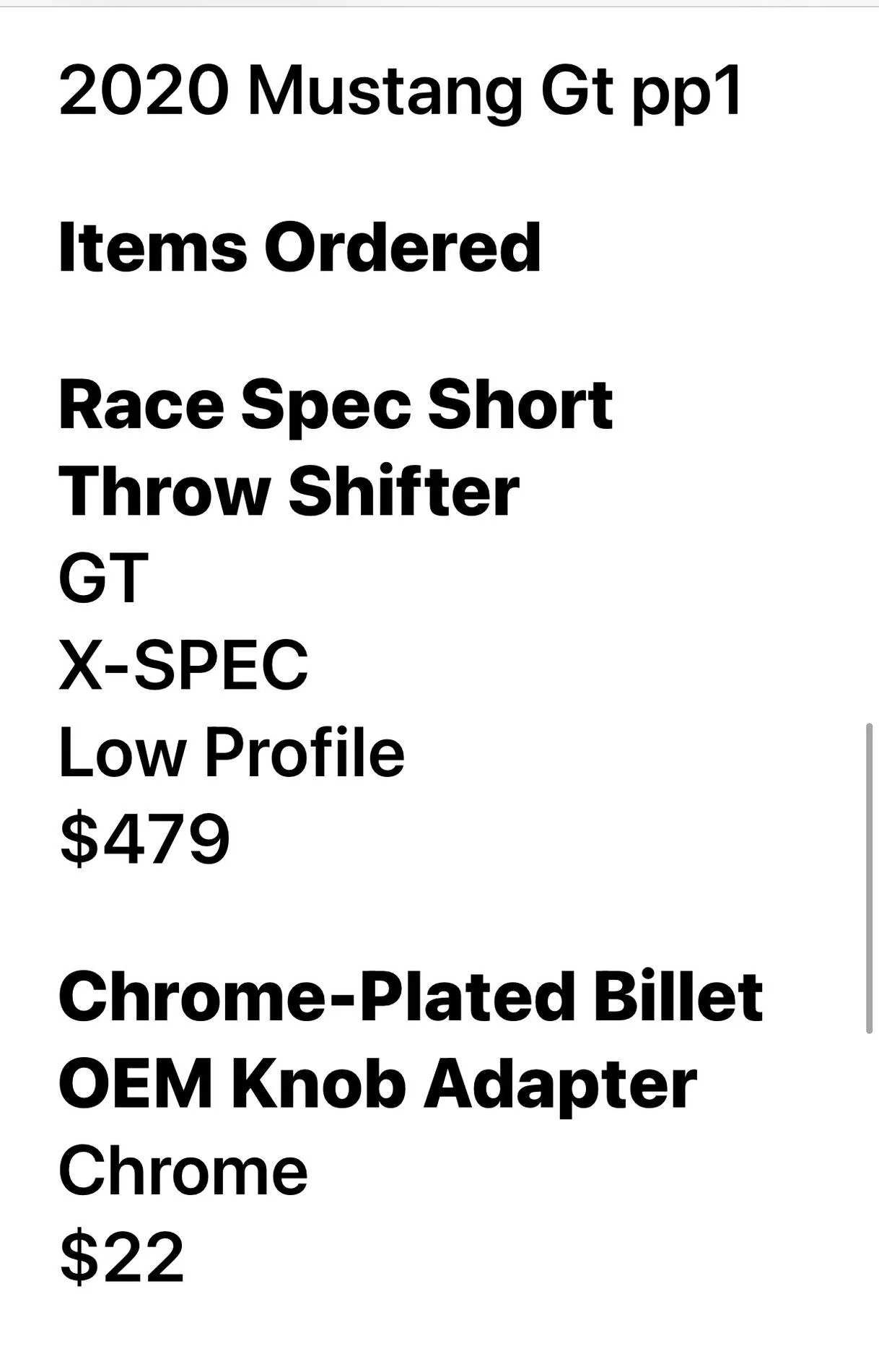

I ordered a low profile xspec shifter as well as the adapter for stock knob as I was planning on using a Ford performance knob on the xspec. My thinking was the ford performance was a direct replacement for the factory knob so I would need the adapter.
MGW called today to say the adapter doesn’t work on the low profile shifter. Does that mean this knob will not work ? The nice lady from mgw said I’ll need a knob that is threaded all the way through. I am unfamiliar with differences in knobs. The ford performance knob as a nut with it as well.

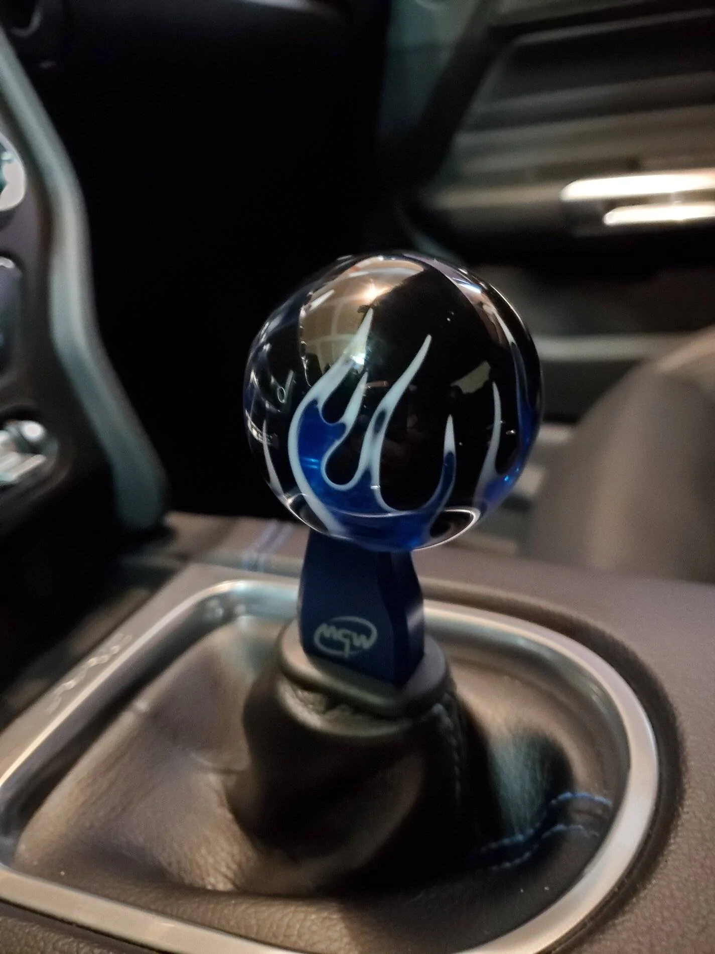

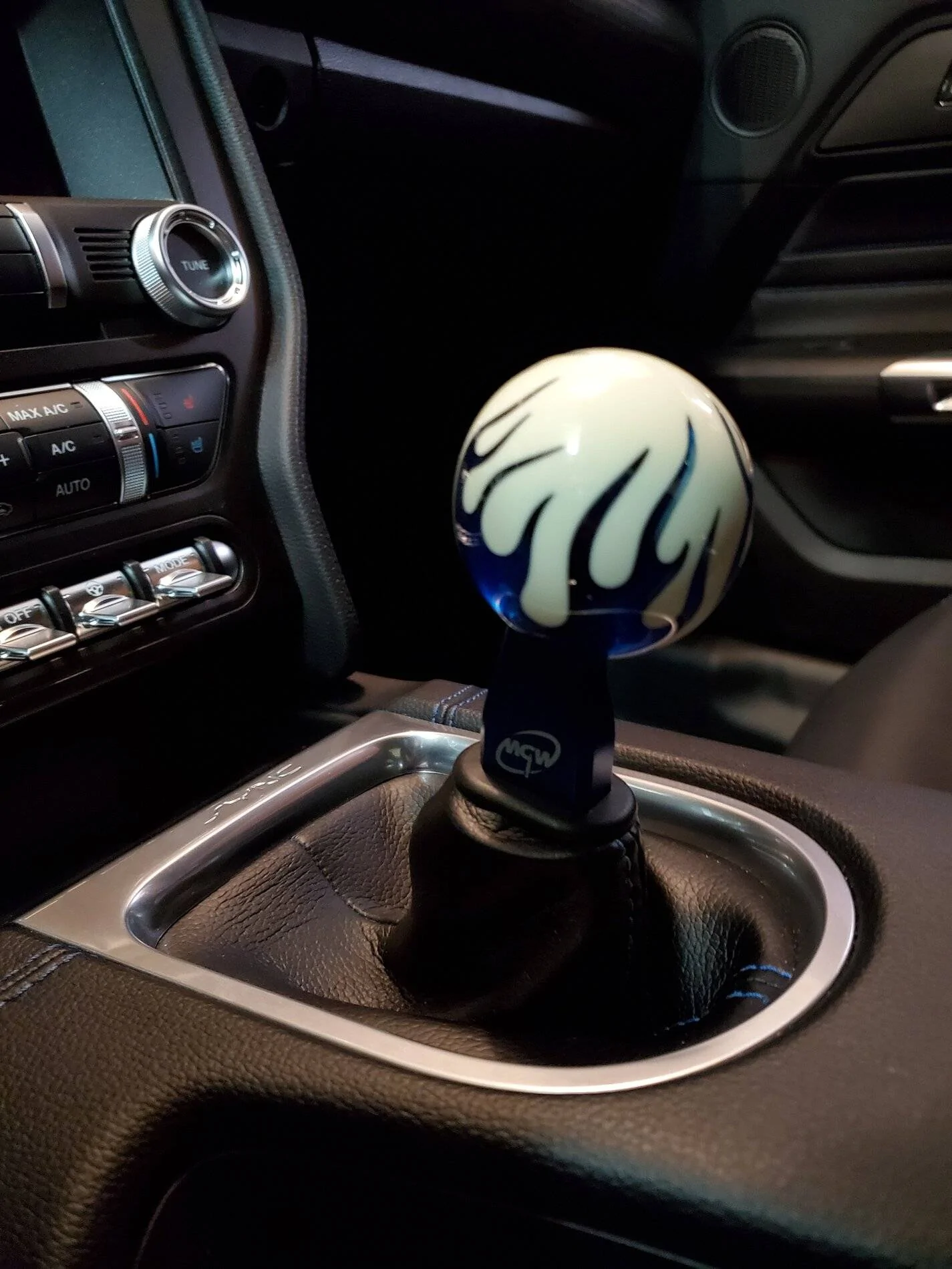

I'm running an MGW X-spec flat stick, which may or may not be threaded the same as yours. I emailed MGW to check on the thread size and pitch, and the lady there responded quickly with the information I needed (3/8-16). My stick has about an inch of threads and I wanted a knob that would screw down with no jam nut or adapter, so it needed at least an inch of threads. I have experience with Flameball knobs from using theirs on a suicide clutch/jockey shifter for one of my motorcycles, so I contacted Gene at Flameball and he made me what I needed. Flameball.com

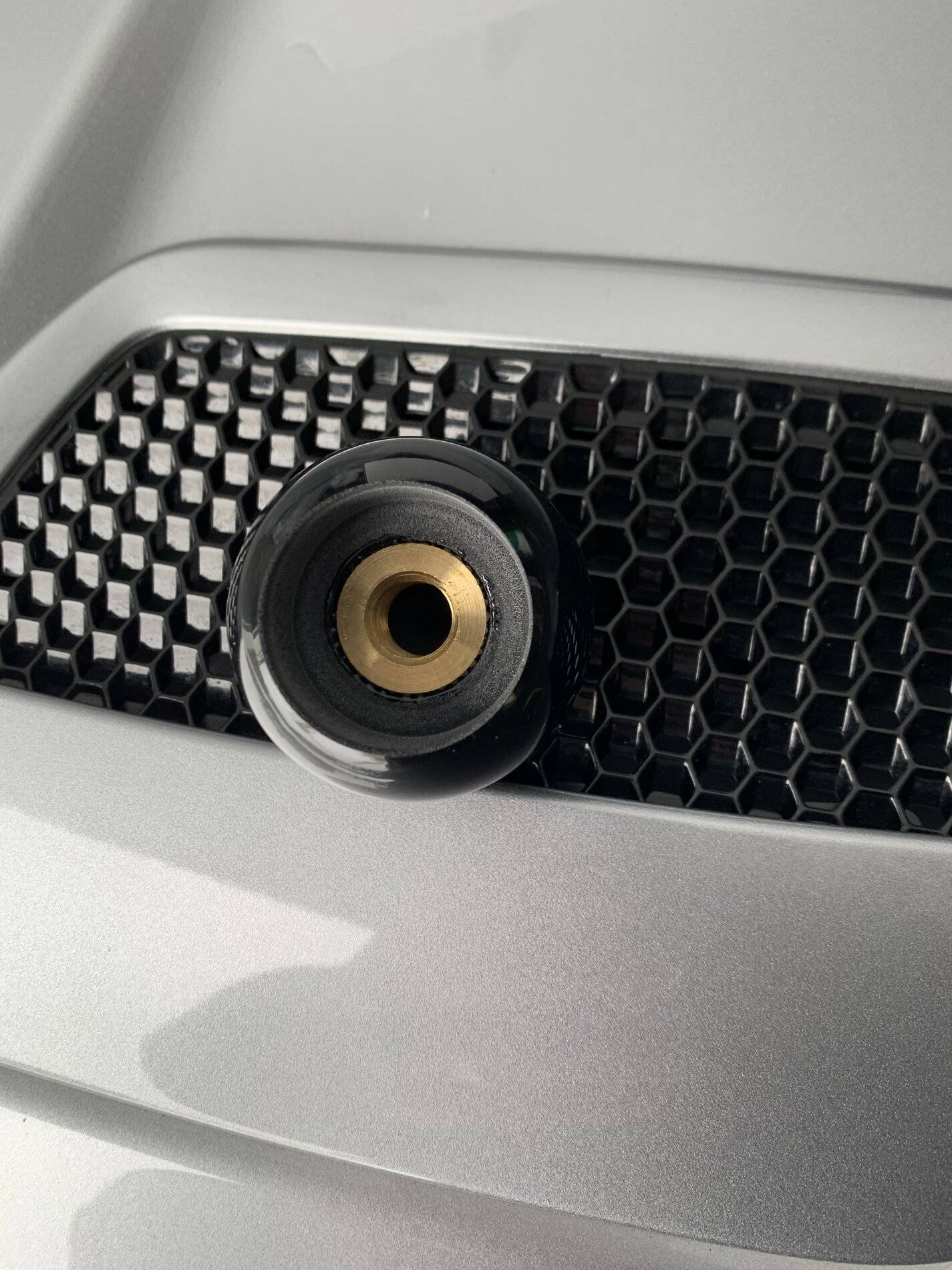

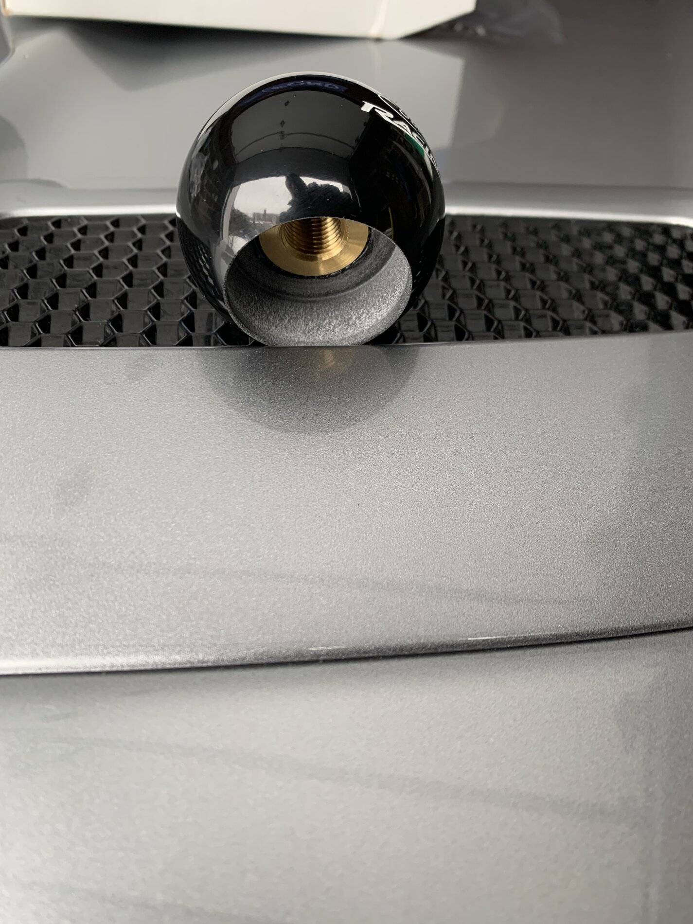

I think that is same as what I’ll need. She said ā€œfully threaded). Looks like ford performance only has 1/2ā€ of threads. Is know a full ball/circle, not flat on bottom ?

My knobs are fully round, not flat-bottomed. Flameball has many different designs - solid color, translucent, pearl, multicolor, etc. Gene has a disclaimer on the site that says he's not taking new orders due to health issues. It's been there for almost a year, but he was available last summer when I ordered mine, and we communicated multiple times thru email. Be sure to specify that you need at least 1" of threads; that'll add $10 to the price. (FWIW - Like you, he's in Pennsylvania). Other manufacturers might also be willing to work with you as long as you can tell them exactly what you need.

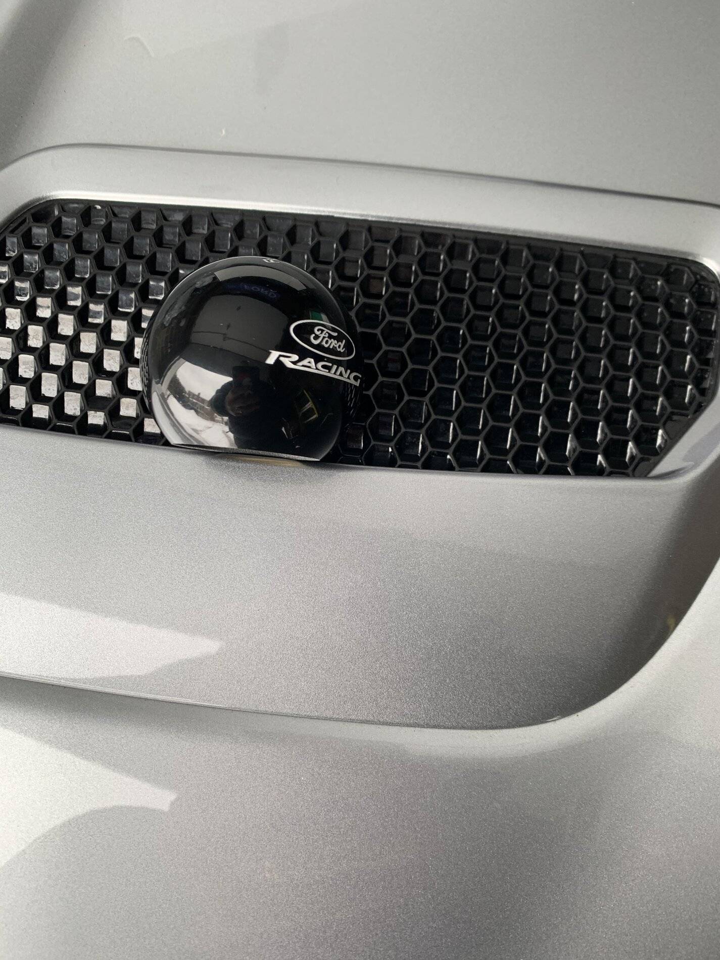

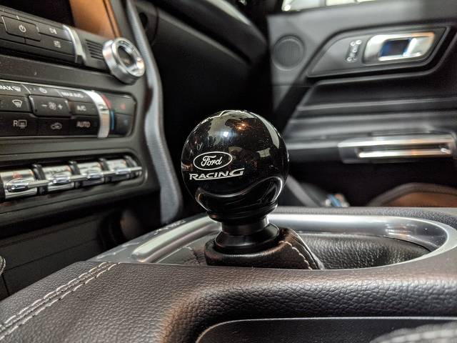

I have the MGW Race Spec with the standard handle. I have the same Ford knob and would not want it any lower.
I agree. I can’t picture it much lower than this. I’m going to message them and call in morning to see if I can correct my mistake.

It is a great shifter!
