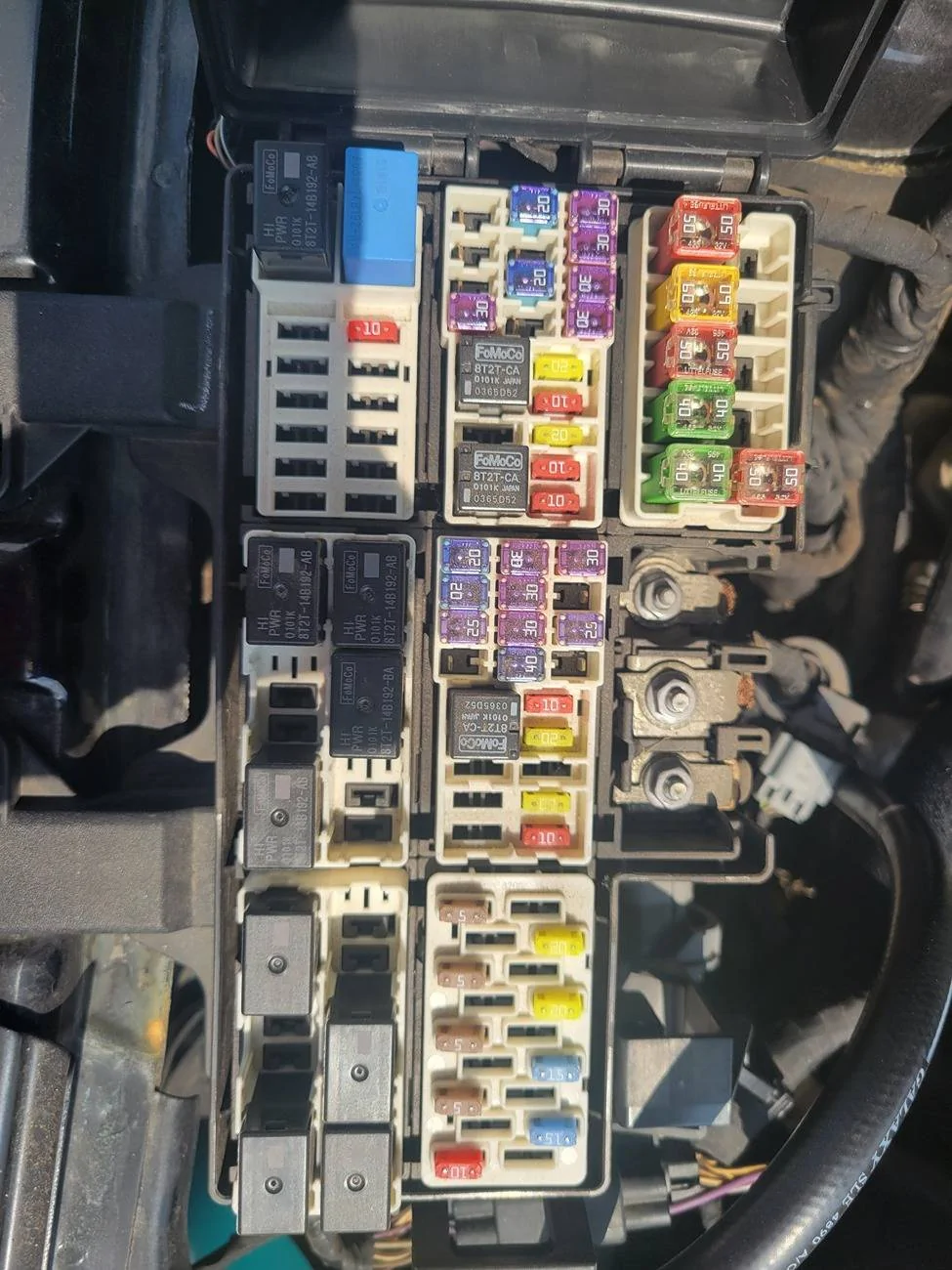

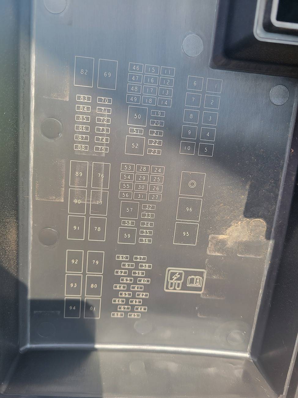

My fuse 27 is already out and I didn't do that

Wrong fuse box, it's the one under the dash kick panel on the passenger side inside the car.
