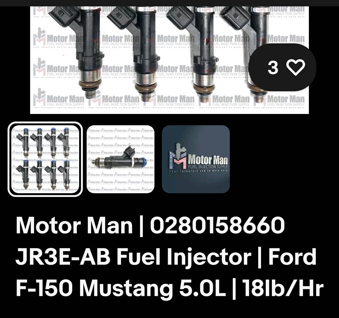

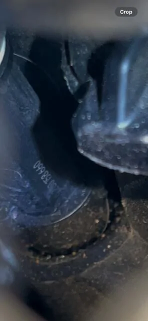

Ok so I am still new to this world (please excuse how dirty these are, when I get time to replace the vvt solenoids in a few weeks i am deep cleaning the entire engine bay) but I am doing what I can to learn as I go. Until then i wanted to confirm what fuel injectors are installed on the car. I was able to find a model # or some kind of idenfication on the side of one and got some crappy pictures. Tried to search around on the web but I could not find any definite answers, was hoping someone with way more experience would be able to help. In the first picture I am seeing 0280158660, the second picture i see 3-20-05-19, the third picture I see 065437. If anyone has any info they might be able to provide I would greatly appreciate it, just want to confirm if these are stock injector size or not. Thanks!

Stock 19lbs 43.5psi are you going to change them

I am thinking about it, looking at lu47 when I switch to e85 tune. Gotta replace a couple parts in the engine bay so figured I might as well do it while I’m in there.

Go with the fic 1000cc because when you go boosted you will need some bigger than the lu47, (cry once)that's what I did when I was on E for about a year then o installed a ESS kit.

I'd say if all he needs is lu47 for NA and e85, just get lu47. It would be ridiculous to run 1000cc injectors NA.
