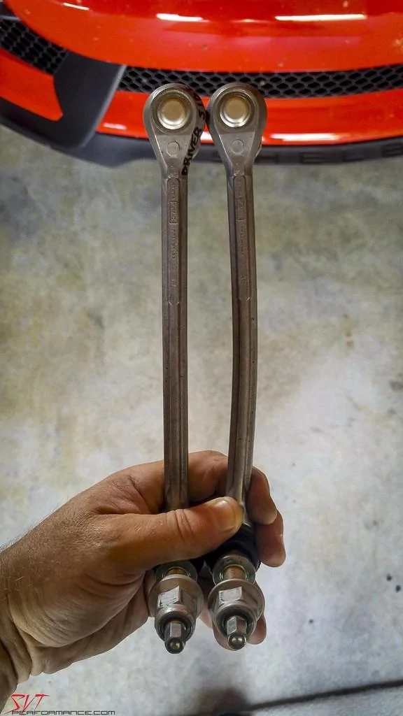

I usually recommend people throw adjustable end-links on with stiffer sway bars, for a few reasons.
1: Due to the stiffer rate of the bars, combined with how heavy these cars are, the OE links are very susceptible to bending. As a matter of fact, the stock links have and do bend without aftermarket bars....
2: Preload. Due to all of the manufacturing tolerance stacking (I call it compounding tolerances) - there is a very good chance that you can have excessive preload in the bar. Often times, cars will come from the factory with preload - especially when you have a full tank and are sitting in the car.
I typically suggest setting stiffer bars up in the neutral position with you in the driver seat - which will ensure the bar is not giving you the effects of excessive preload with all of that increased bar rate.
Attached is a pic, thanks to "Tob" who posted these over on svtp.

All S550s come with sway bars and end links.
I am on the phone as I type, with a customer who just bent a stock link badly with a 35mm front bar.
