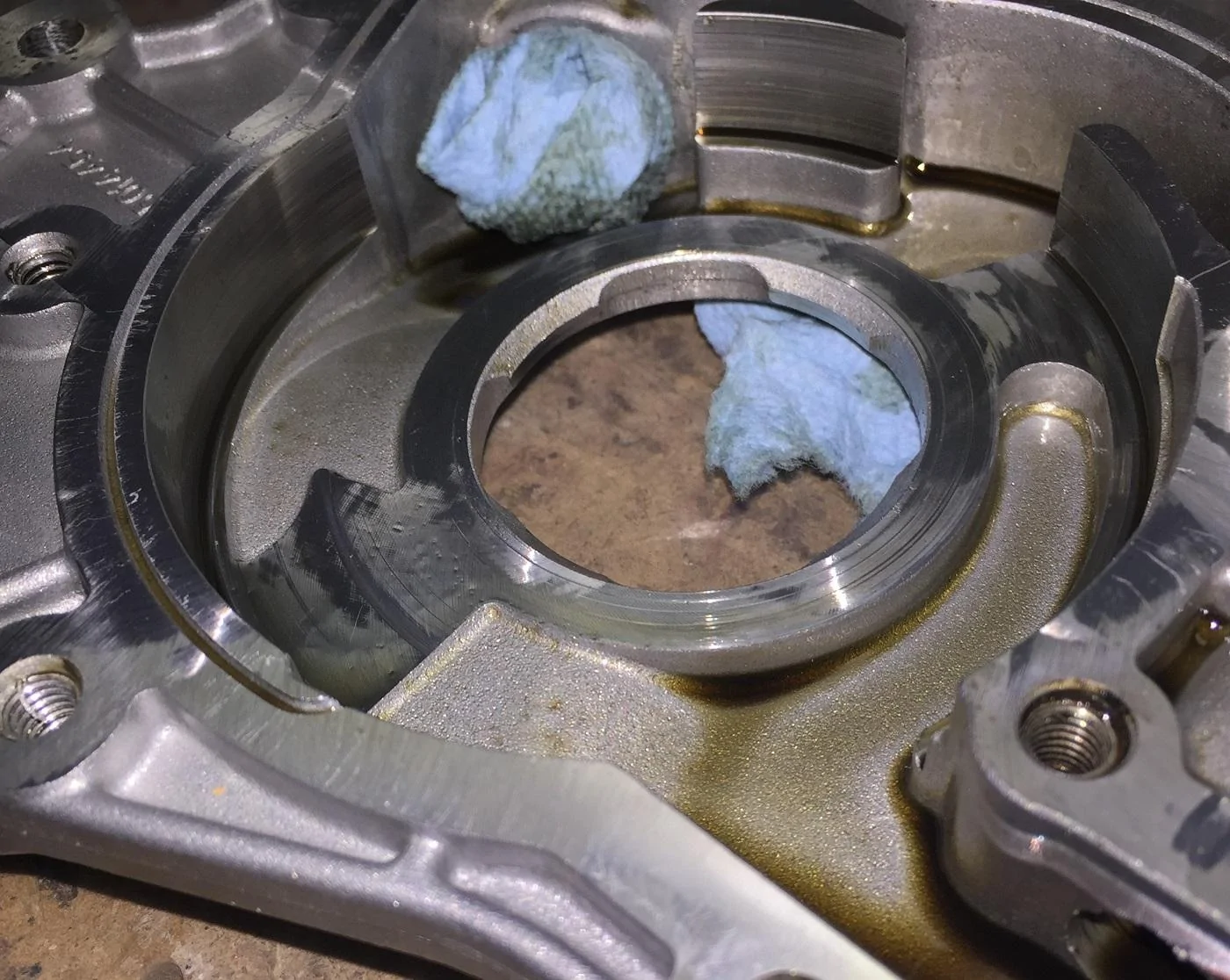

Ohhh...so now we have determined this is what causes oil pumps to break..:doh:
Lol right? Freakn aliens man. ;)
Ford engineers say its the crank damper. http://www.mustang6g.com/forums/showthread.php?t=53571
I am prolly wrong, but still suspect cold heavy oil contributes since ALL the broke gears seem to be within first couple minutes coming from a cold start. Maybe the cold oil has less damping effect on crank. Dunno..
I never found any OPG failures on S550 that had CHT above 200F for at least 30 min CONTINUOUS prior to failure.
Seen any posted up like that?
Any broken OPG w ATI damper stock size or 20% over?
Again, have not seen that either.
Total silly speculation but.. It could be that anyone smart enough to run an ATI knows not to run 5w-50 at the strip with a cold motor? Awww who the hell knows..

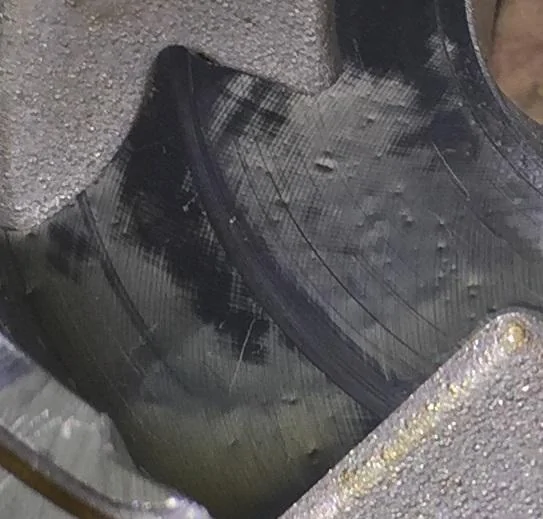

Seriously though: I was told I could run stock gears all out with an ATI no BS. So I pulled the TSS that I installed with a second stock pump housing and put the factory STOCK OPG and original housing back in and ran a weekend of testing w STOCK OPG on a road course (MSR Houston) to the point of tire abuse. I was pretty sure it would be ok considering the advice and that if the pump went I probably would not have to worry much.
8x20min sessions, 5W-20, 3.625 pulley Whipple... Totally thugged some MPSS.
Gears did not break.
Found light grooves in housing on tear down and a little metal.
Maybe crank snout deflection?
The OPG floats on the crank to accommodate crank deflection somewhat, but not sure if it could be maxed out.
After that, put a new GT350 housing and pan on with the TSS gears.
Sorry Op, can move this post to the "Ford's word" thread.

So your oil pump gears didn't break in one weekend so you think you found the cure-all? Seriously..
Hell no! Not sure how you got that.
Sample size was 1. Found metal. Pictures of grooves cut in housing.
This may have NOTHING to do with broken gears.
Just sharing info.
Changing OPG takes a little time so most people would not do this. There is risk with how many times you forge crank dampers back on snout each reassembly. I was already pulling front cover to inspect TG and chains; pump isnt that much more work at that point. Some would say I'm an idiot who risked a motor even trying this. Just posting up what I did, images and thoughts.
