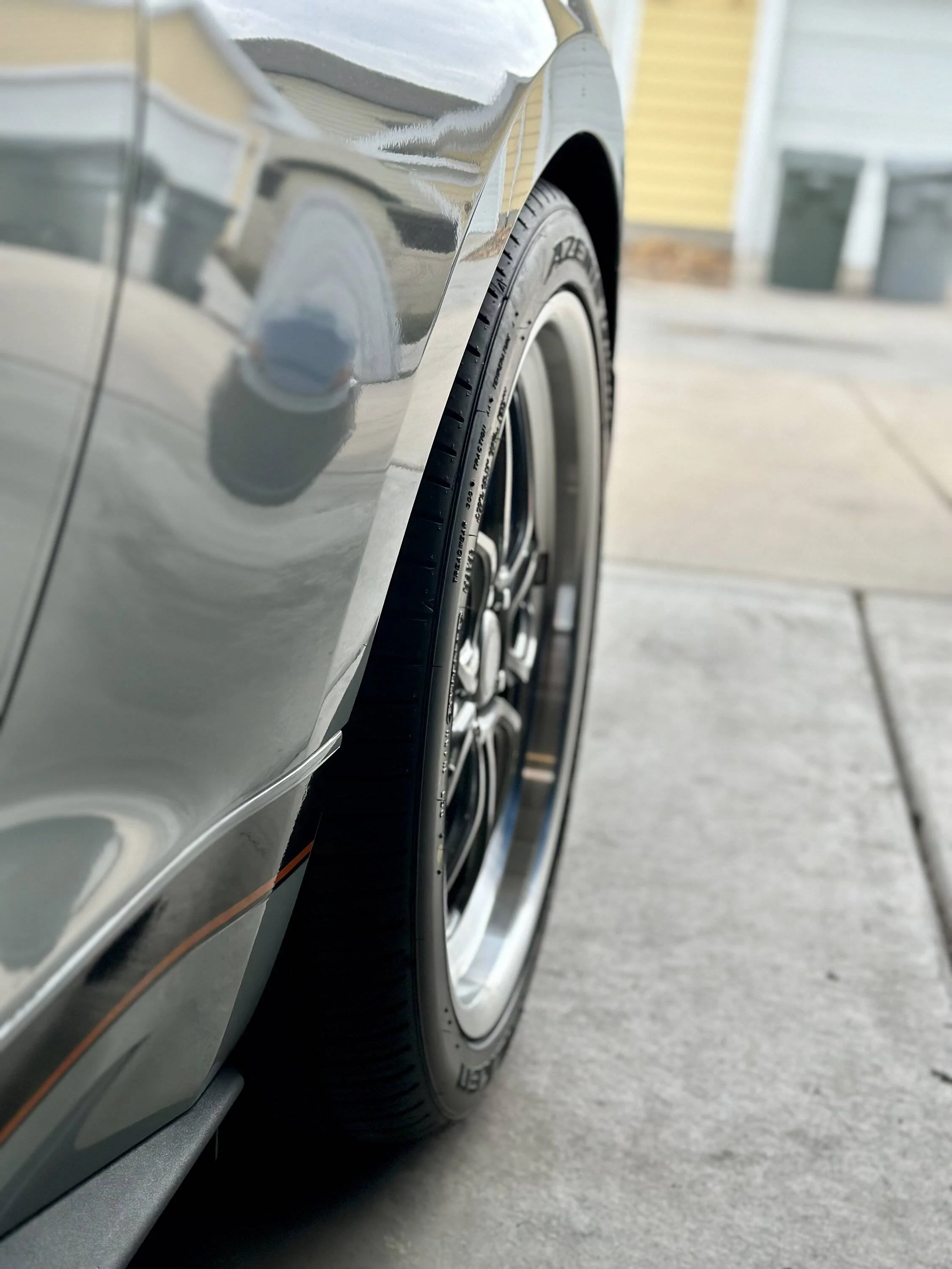

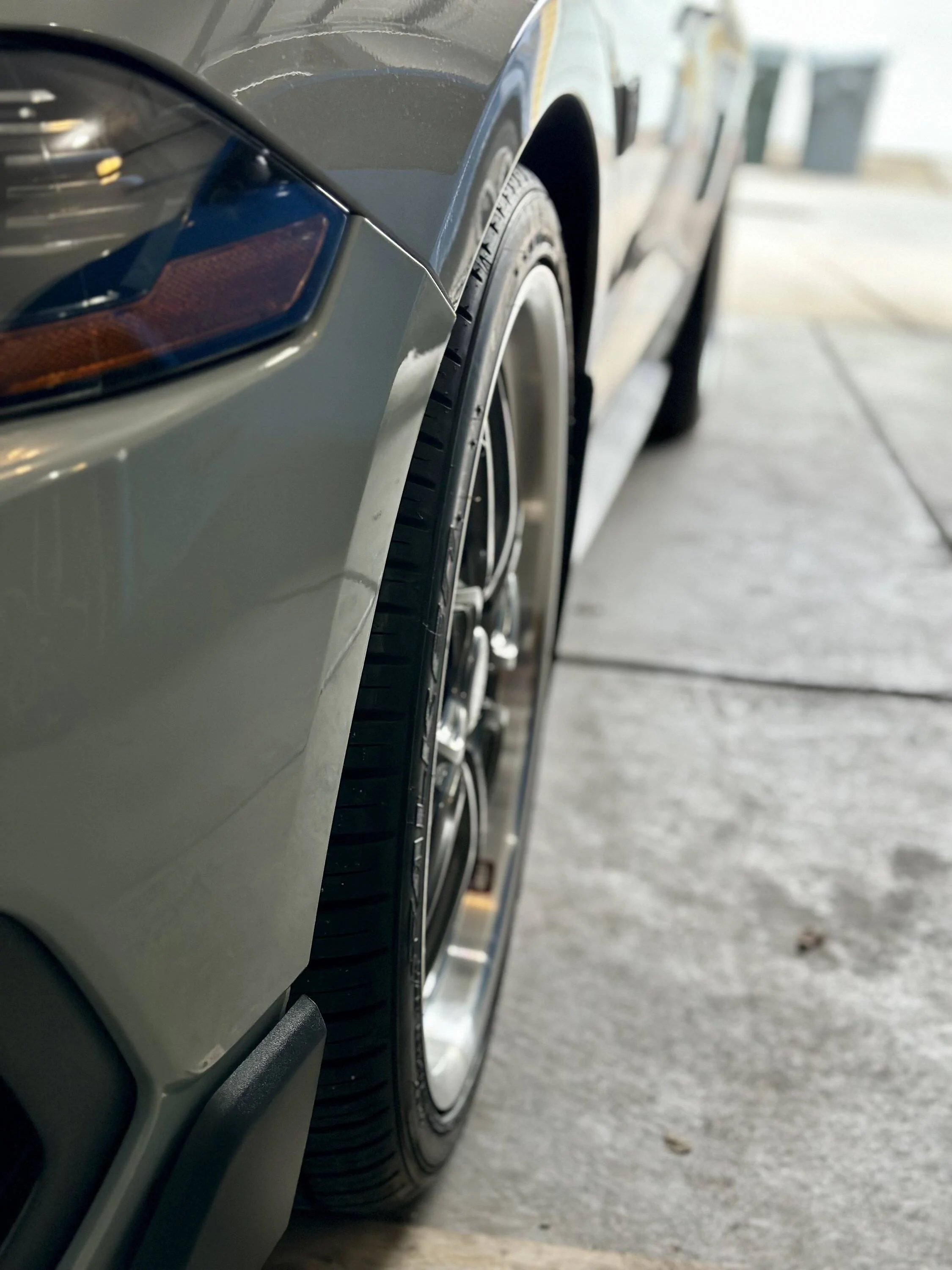

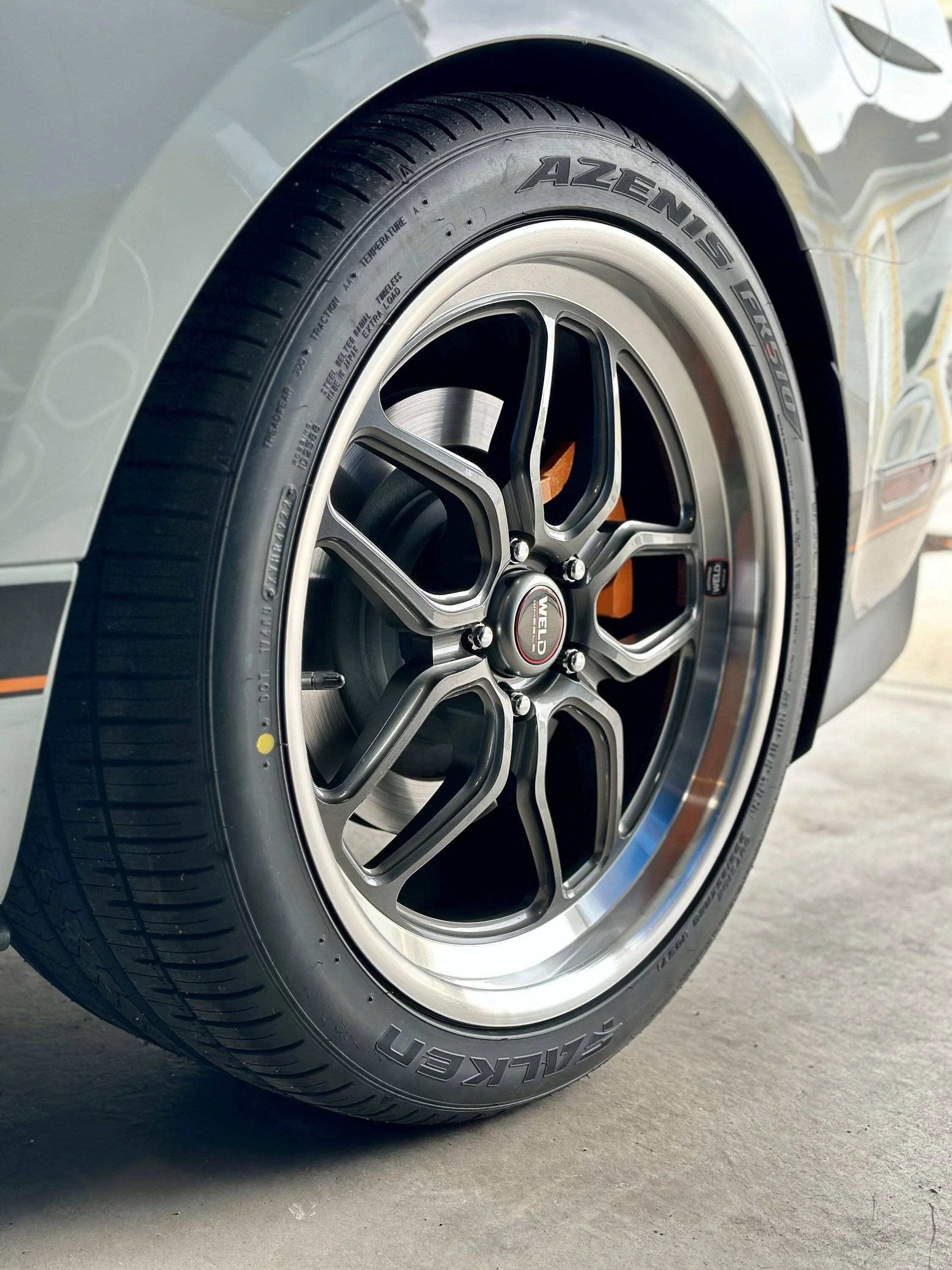

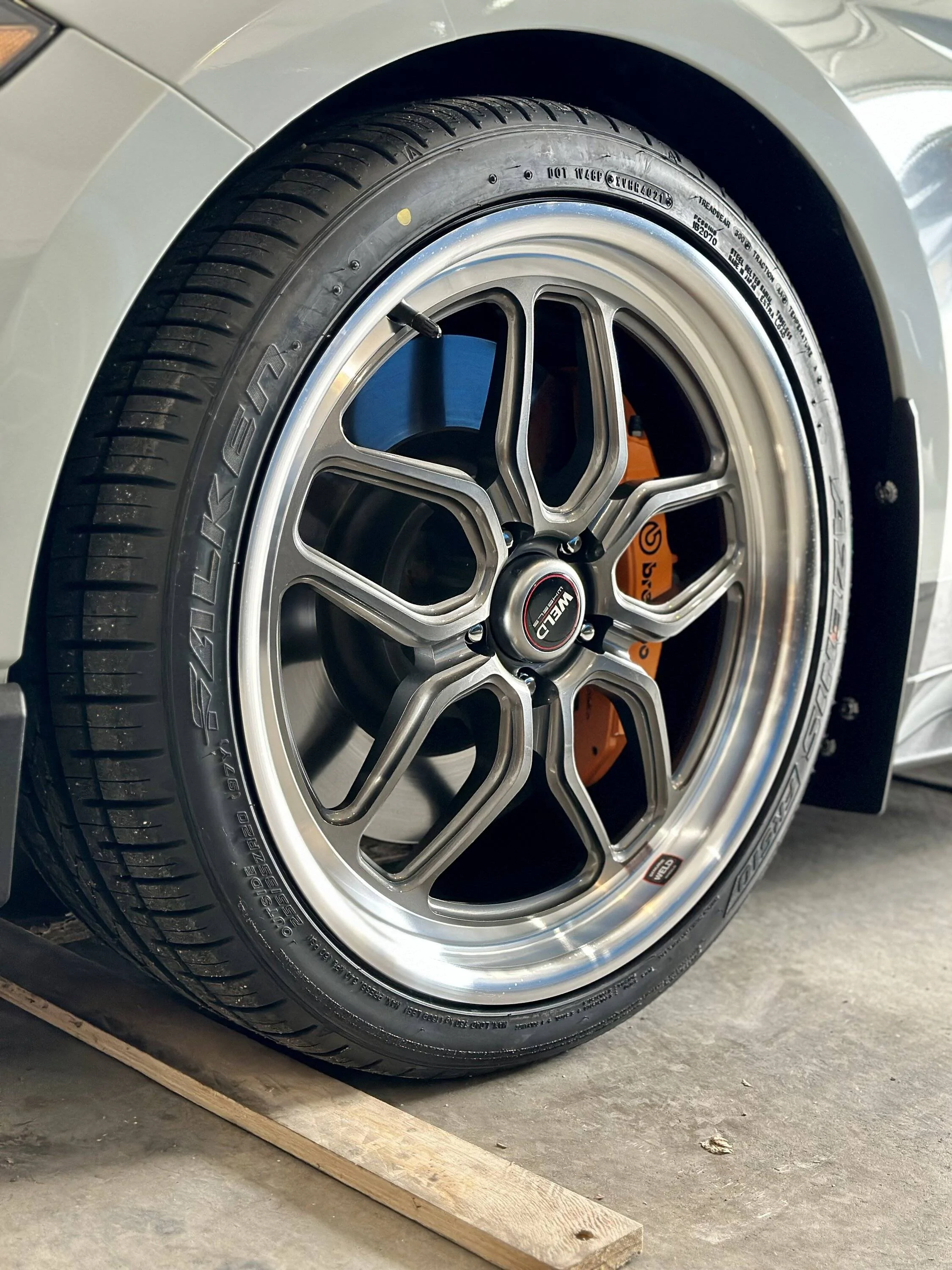

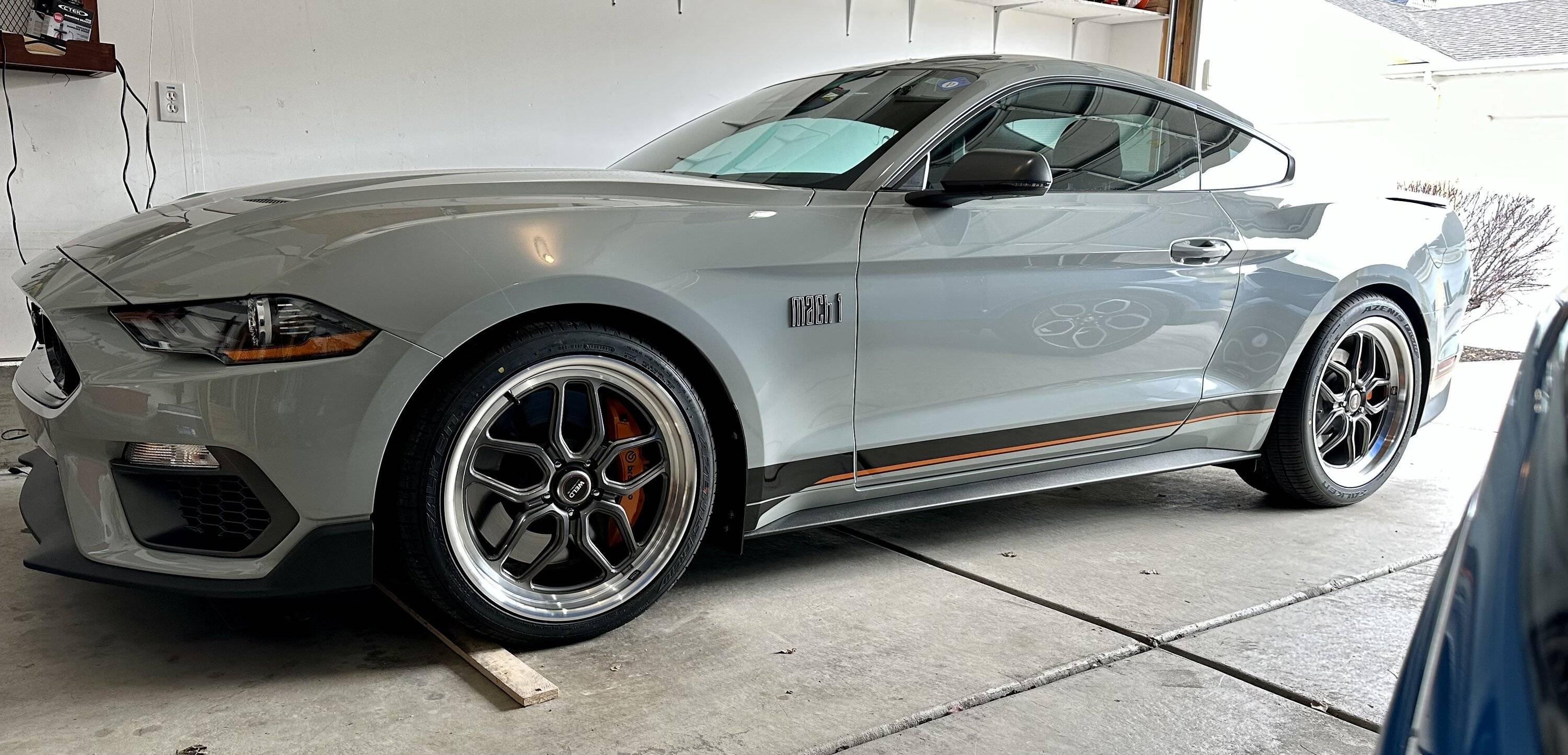

Took a risk and tried something different with my Mach 1.
Weld Racing Laguna S108 from their rotary formed line and Falken FK510 tires.
F 20x9@29mm & 255/35
R 20x10.5@50mm & 295/35
The wheels are approximately 5-7 lbs lighter than the factory set up, do not poke (look at those offsets, beautiful!) need hub centric rings, and filled up the visible wheel wheel by approximately 7 mm front and 14 mm rear.

Great looking set up. Thank you for sharing the info and pics!

I've always loved the look of drag style wheels in 20". That fitment is chefs kiss perfect as well.
