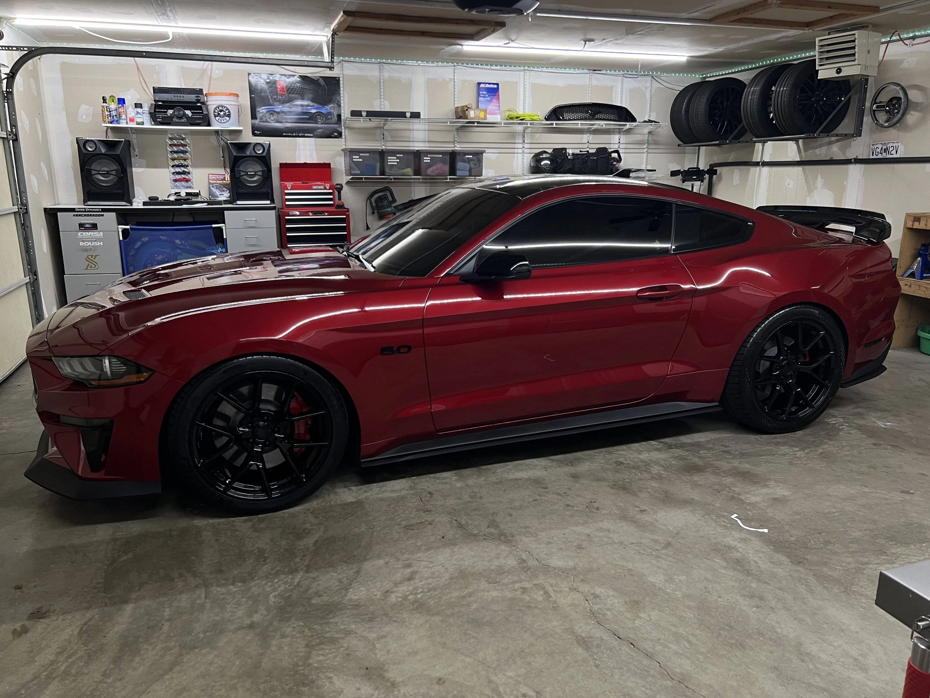

Gorgeous color, BTW!

thank you for all of the replies! the color is amazing i would have to agree. the only thing i could think of was the actuators cause i do have active on mine. i havent had time to get under it yet. i thought i could be the fuel pump but ive never had any weird idles or surges. there was a time where the valves wouldnt open on startup for about a minute then they finally opened up. i might check there first and see
