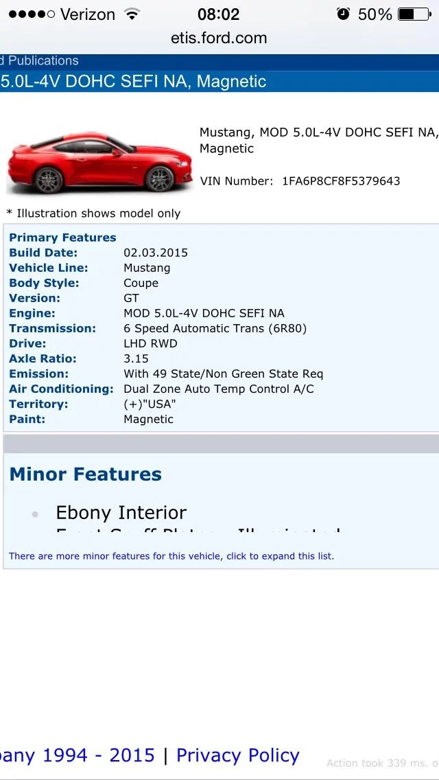

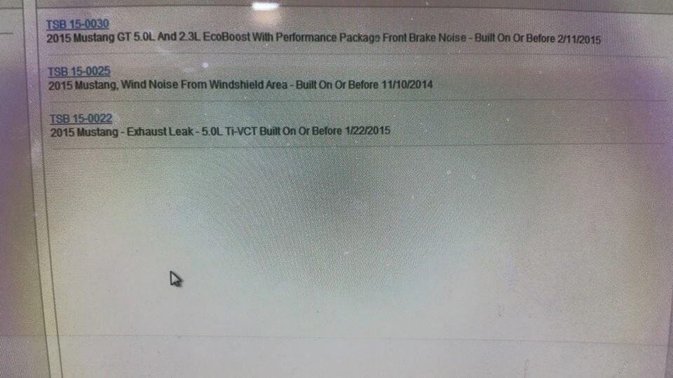

I'll try that. I'm also going to look into getting the TSB done on it due to the brake noise. Looks like they are replacing the rotors with a new part number
