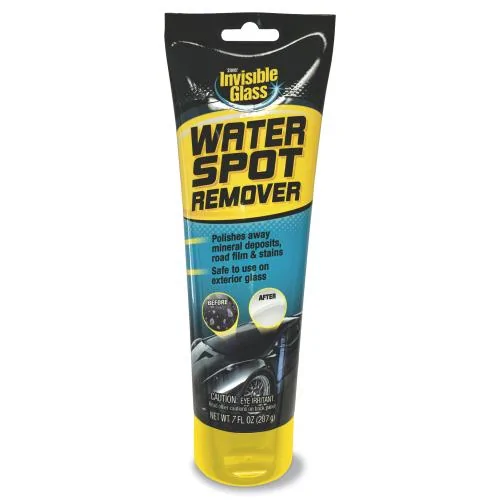

Have you tried this? It takes a bit of elbow grease but it works.
