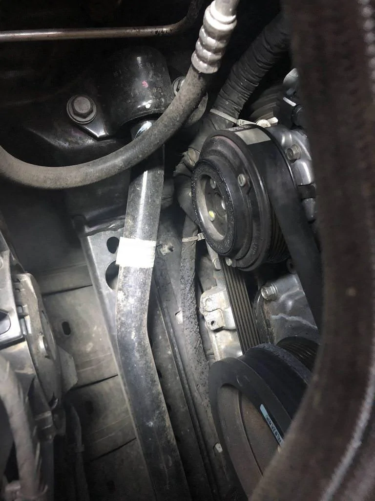

Its definitely the compressor (or compressor failure is a symptom). They had the car for five days and couldn't find anything. In 15 minutes of driving, it failed on me twice.
I pull two bolts on the overflow bottle and move it out of the way in 5 minutes to see this:
There's bits of rubber everywhere, and some liquid or grease on the radiator support and timing cover along with the face of the compressor.
