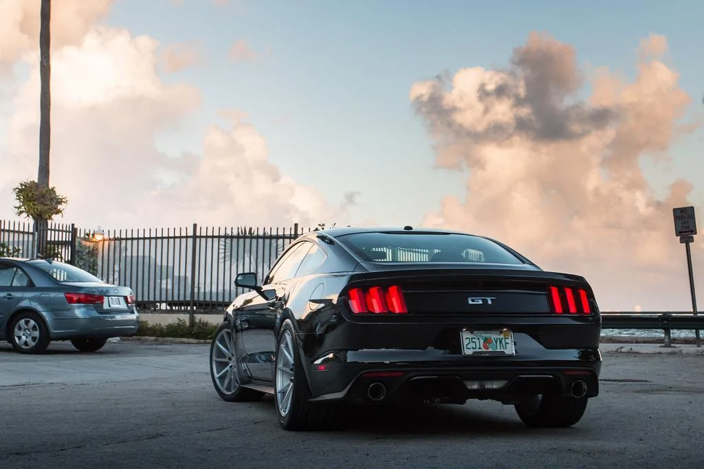

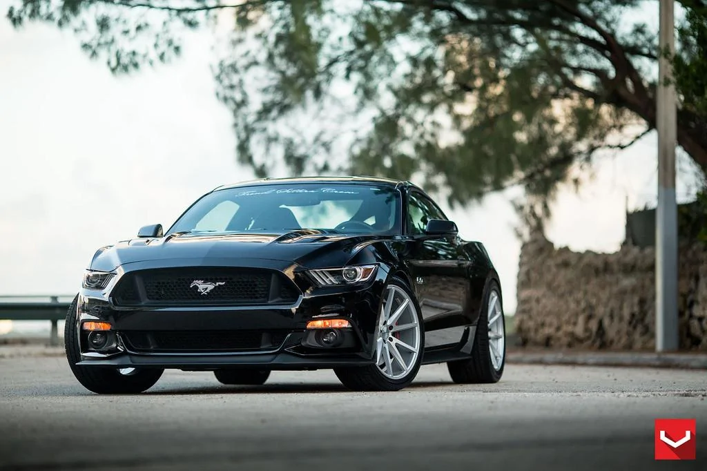

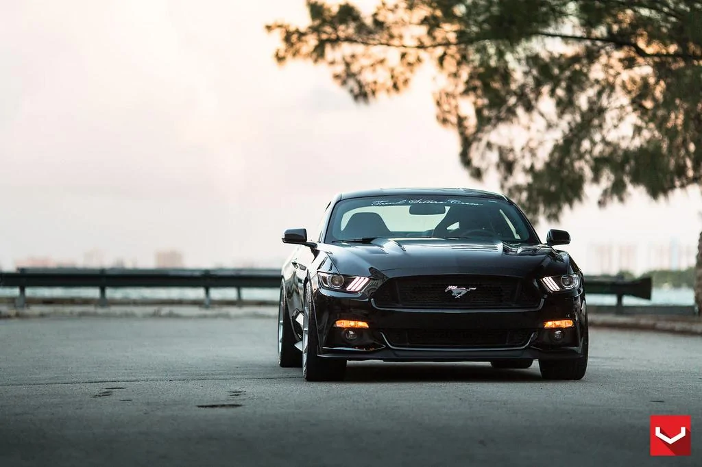

Glad to help. What tire size are you currently running and how low do you want to go? It all depends on the look you are going for. If you go with a 1" drop all around (Eibach Pro Kit) you can rock the 275/35/20 and 315/35/20 for a meaty tire setup. if you decide to go lower you can do a 275/30/20 and 305/30/20 and still have a good stance and have the car sit lower. With the car poking out a little bit more on one side it could be the alignment. The camber on the one side could be more positive on the one side.
Some photos with the eibach pro kit (1in drop) and the 275/35/20 & 315/35/20 Tire setup

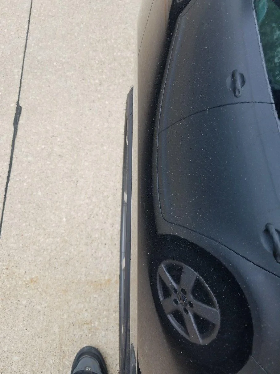

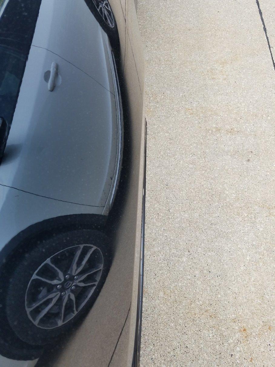

Here's a show of left vs right. Kinda hard to capture on camera haha.

The sportlines would be a perfect drop with the tire sizes you currently have on the car. Oh yea thats just camber. That can be adjust and I would invest in the toe arms as well. Give you alot more room for adjustability
