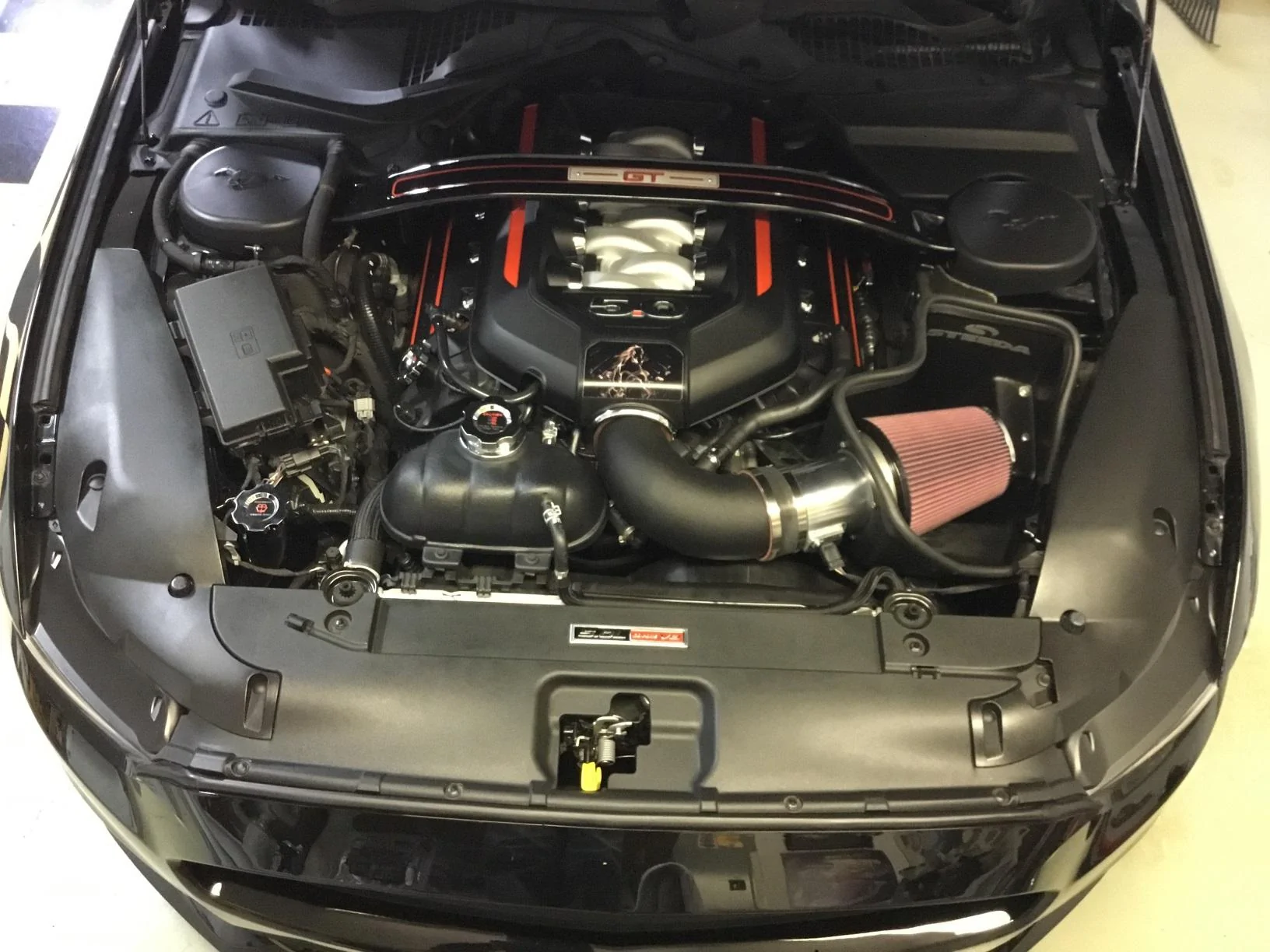

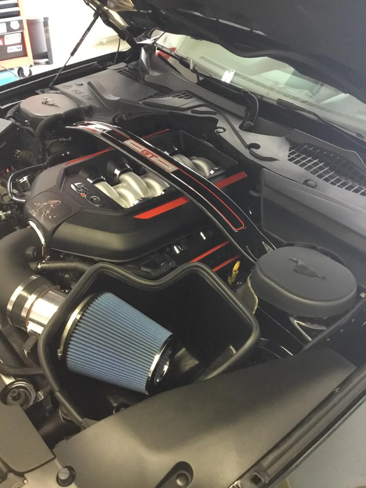

Well, after a year and a half.... its done!! Pls note, I do not like our crappy engine bays....so did a few things!...Yes, it' a 2015!!

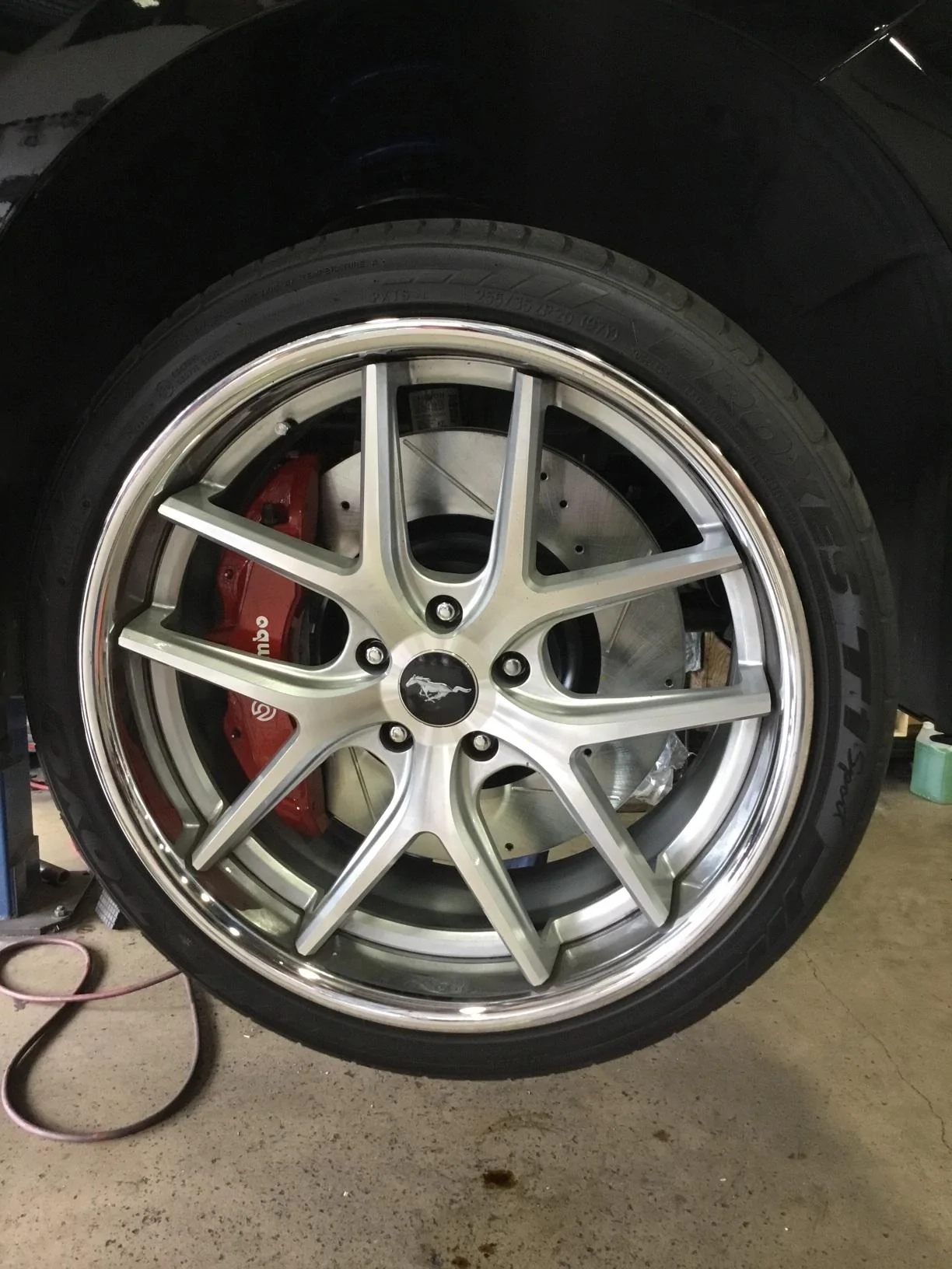

Finally got around to installing these puppies....just aesthetics!! Nothing wrong with original set up! Just can’t help myself! lol
When you came over the other day, I was druling when I saw under the hood! now even more!
Nicly done, The CAI finished her off nicely, looking forward to seeing all the billet caps once you get them on! And yes, I can see I need to dig deeper into my pocket book if I'm going to keep riding on your shirt tails. ... lol...lol...
Let us know how that CAI and TUNE PERFORMS after your furst run. I'm sure you be calling me later today to gloat!!! :cheers:

Underhood Detail

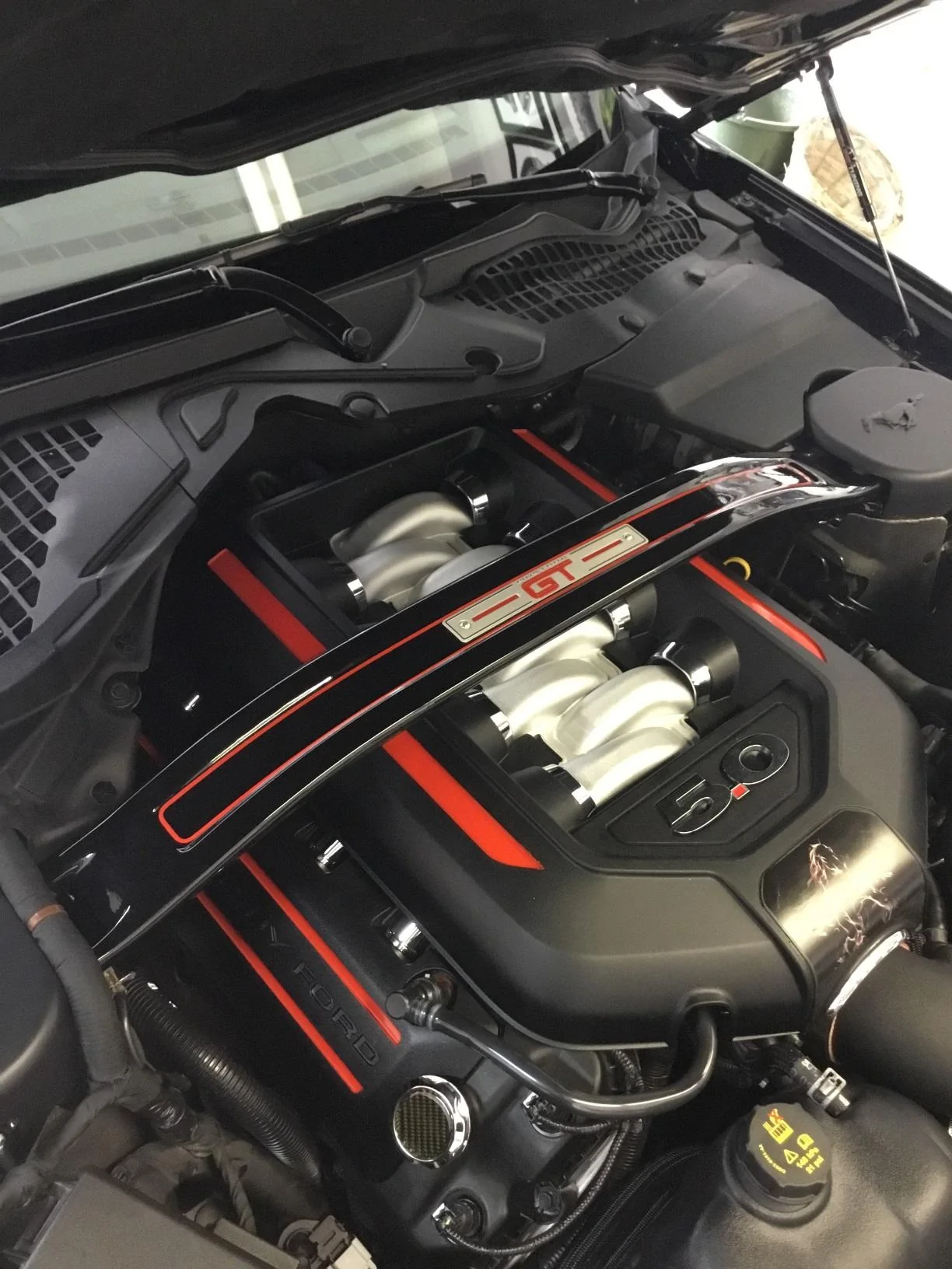

Got some Black Magic going on under the hood!!!

Excellent Work Buddy!! :headbang:

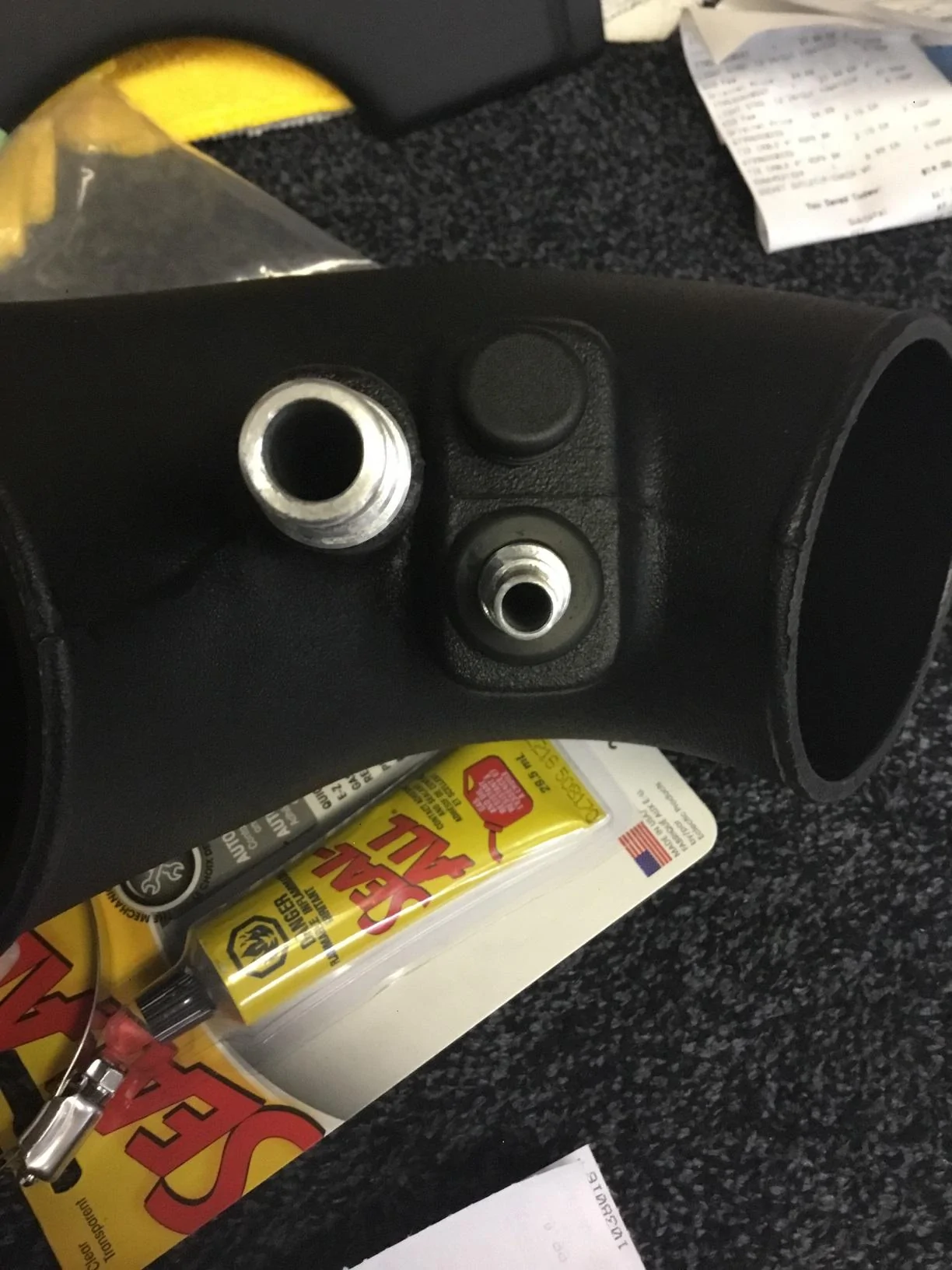

Interesting that the S197 engine cover worked for you. Details?
I tried one with no luck (Roush CAI), the front wouldn't fit around the intake tube, no way no how.

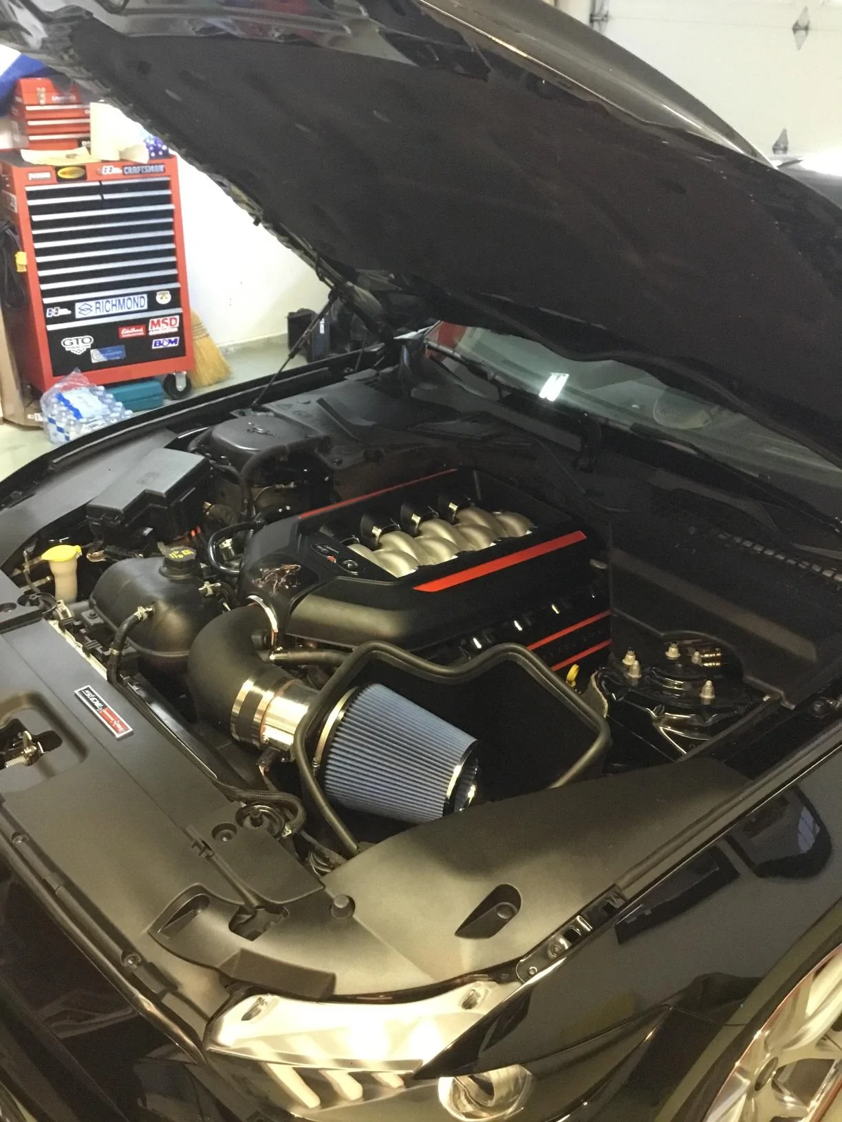

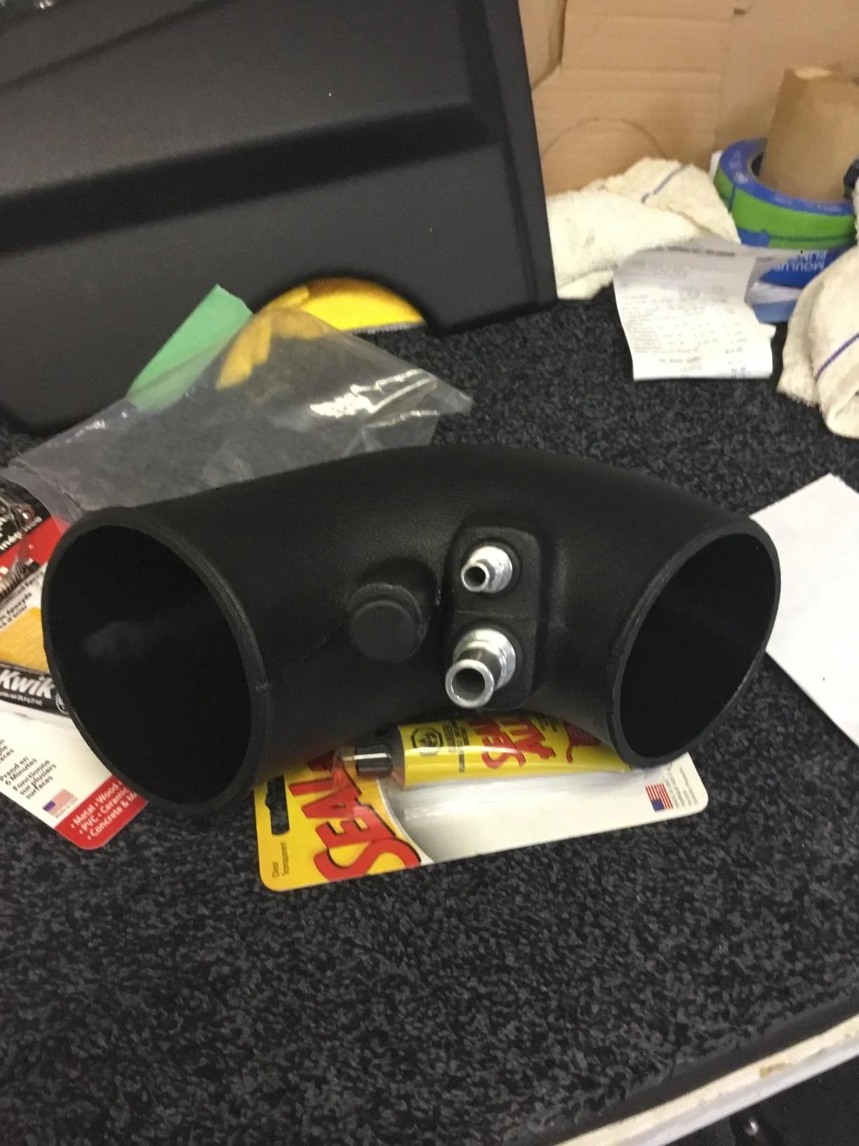

Curious...did it just not sit down all the way because of the MRC tube?? That was the only issue I had up front!
1st off..yes they do fit. The attatchment pins to the intake are exact, I relieved the drivers rear corner a bit for clearance back there. I have a Steed CAI as you see and it sits on it when all the way installed!! The issue I had was the MRC tube running along the drivers side intake was impeding the fit. I relocated it as per the pics....my sound tube was already deleted, I moved the MRC tube to the bottom input on the Steeda tube, relocated the coil cover tube to the sound tube deleted input and I blocked off the original input hole for the MRC tube at the top of the Steeda intake tube. The MRC was discontinued by Ford in 2017, initially the thought it was an emissions thing...but no it wasn’t !! Top pic is how it’s supposed to be hooked up...bottom pic was my mod to make it work and sit down where it should!!!
