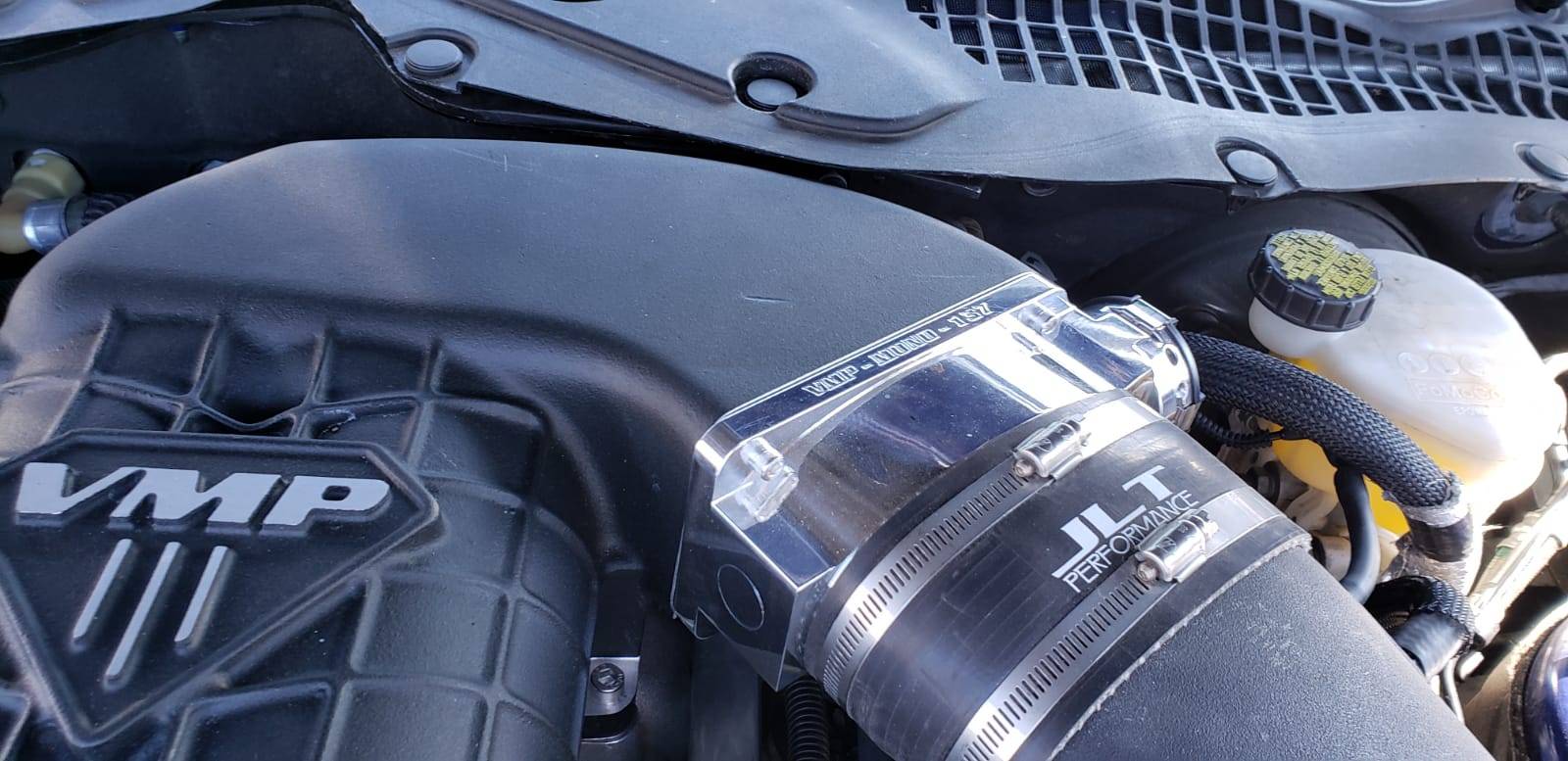

First, I had to completely remove the K-brace and grind it flush to the body.

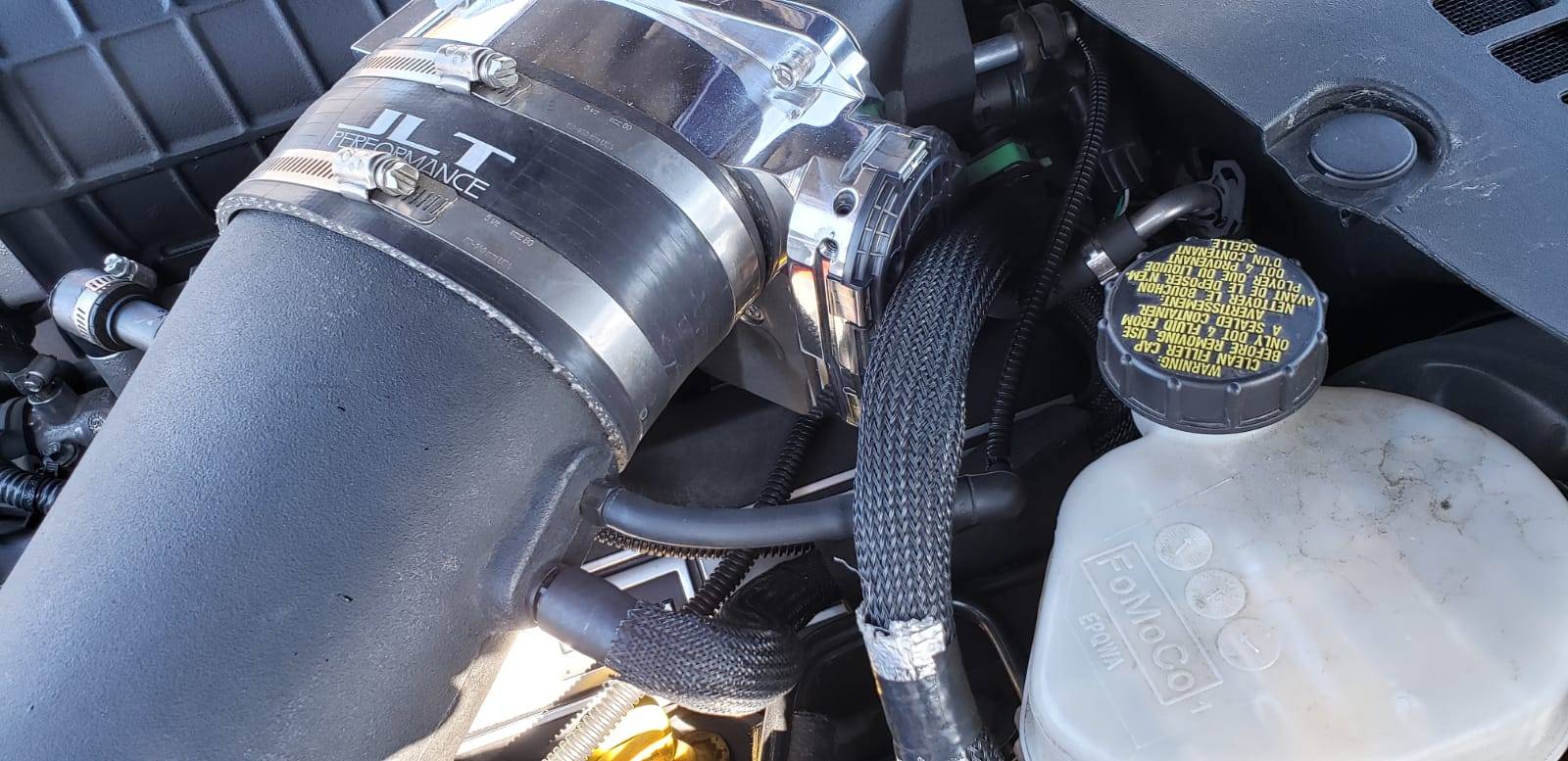

Then the vacuum line from the solenoid to the CAI is to short.
The stock serpentine belt would not slide over the 85mm blower pulley.

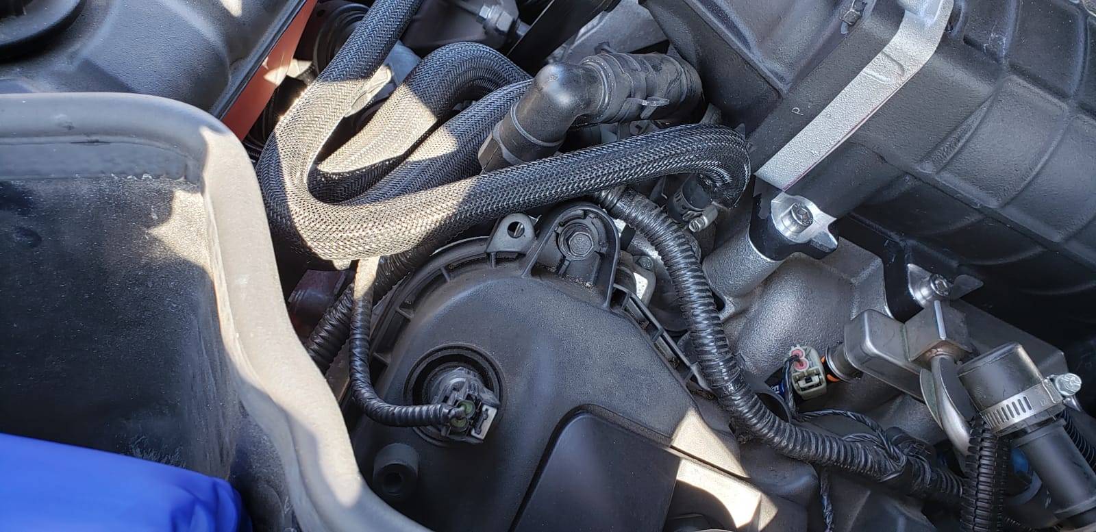

Noticed the hose from the expansion tank to the intercooler is up against the blower.
Then after a couple of days saw where the hood liner clip was rubbing against the blower inlet (I did find supplement instructions referring to this, but I already bent it up).
