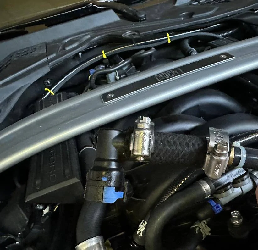

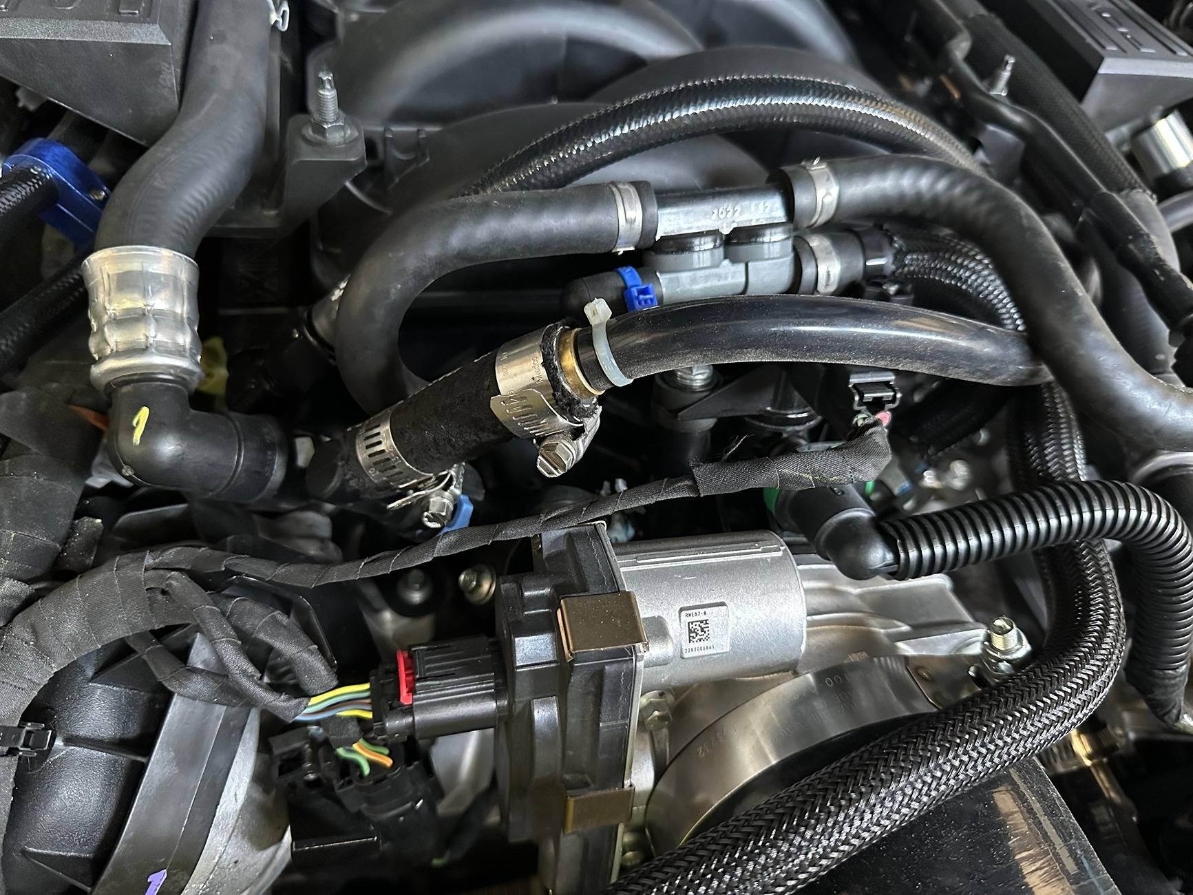

Absolutely. If you are using breathers then your PCV port in the intake manifold is the perfect source. I did the same thing.
Use the OEM push lock 5/8" fitting that is on the OEM PCV tube from the passenger side.
Cut the hard plastic line off of it.
Call Jeff Bezos and Order some 5/8" silicone vacuum tube, some 3/8" vacuum tube, as well as a 5/8" to 3/8" barbed reducer. Depending on what your Paxton kit came with, you will also likely need some 5/16" silicone vaccum hose for the BOV and Pressure regulator.
Order a vacuum block. - you don't need anything fancy for this, just one that is aluminum and has aluminum fittings.

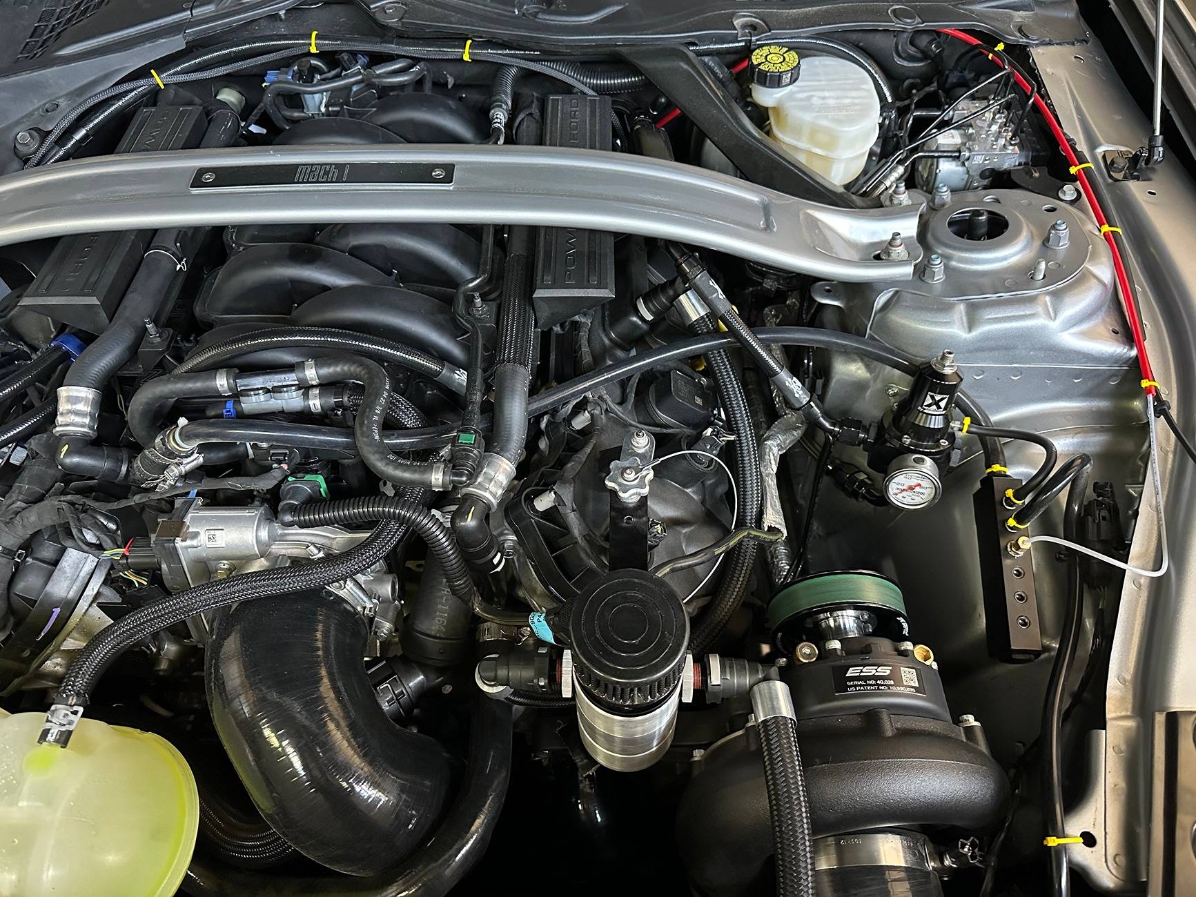

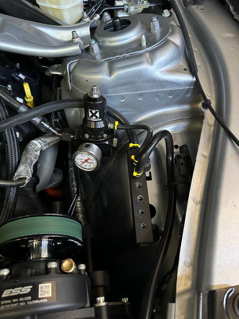

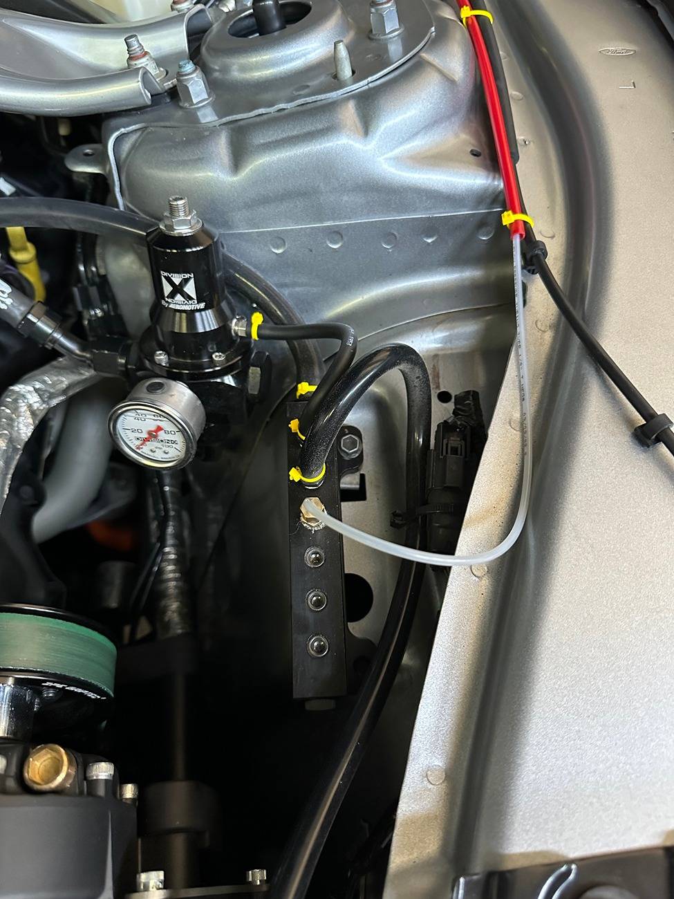

Here are more recent pictures after I added a Boost gauge
