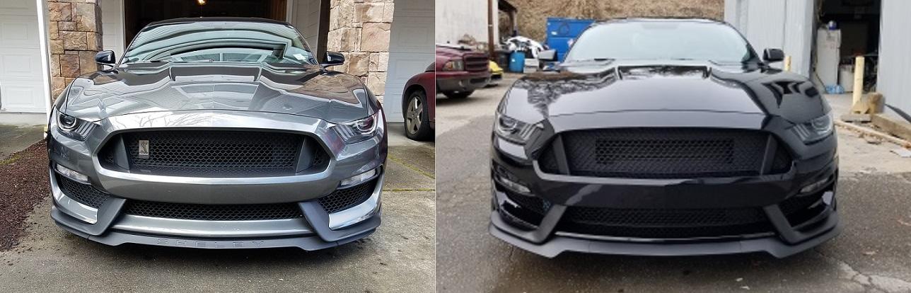

Yes I am well aware they aren't the same. It's why they call them GT350 "styled" or "inspired". I mean it's your car, and if you want to throw down 1000s more on OEM parts by all means. I just dont see the sense in it when many others have used the GT350 styled options with great results. Heck, you could potentially sell those OEM parts and have enough money to fund the purchase of the GT350 styles bumpers and fenders completely.

To complete an OEM conversion you will need...
350 Hood
350 Fenders
350 Bumper assembly (grilles and brackets)
350 Radiator core support
350 wheel well splash sheilds
350 rocker panels
misc bolts
A complete OEM swap will likely set you back around $5k US.
