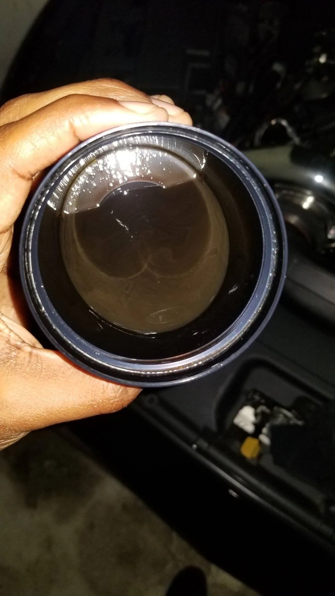

Hope I didn't blow this bitch up. Did a couple pulls tonight with some friends. Noticed oil spitting out my breather cap on top of my catch can. Normally it blow a little smoke but they say that normal but this time the filter was soaked in oil. Is this something I should be concerned about? @UPRSteve

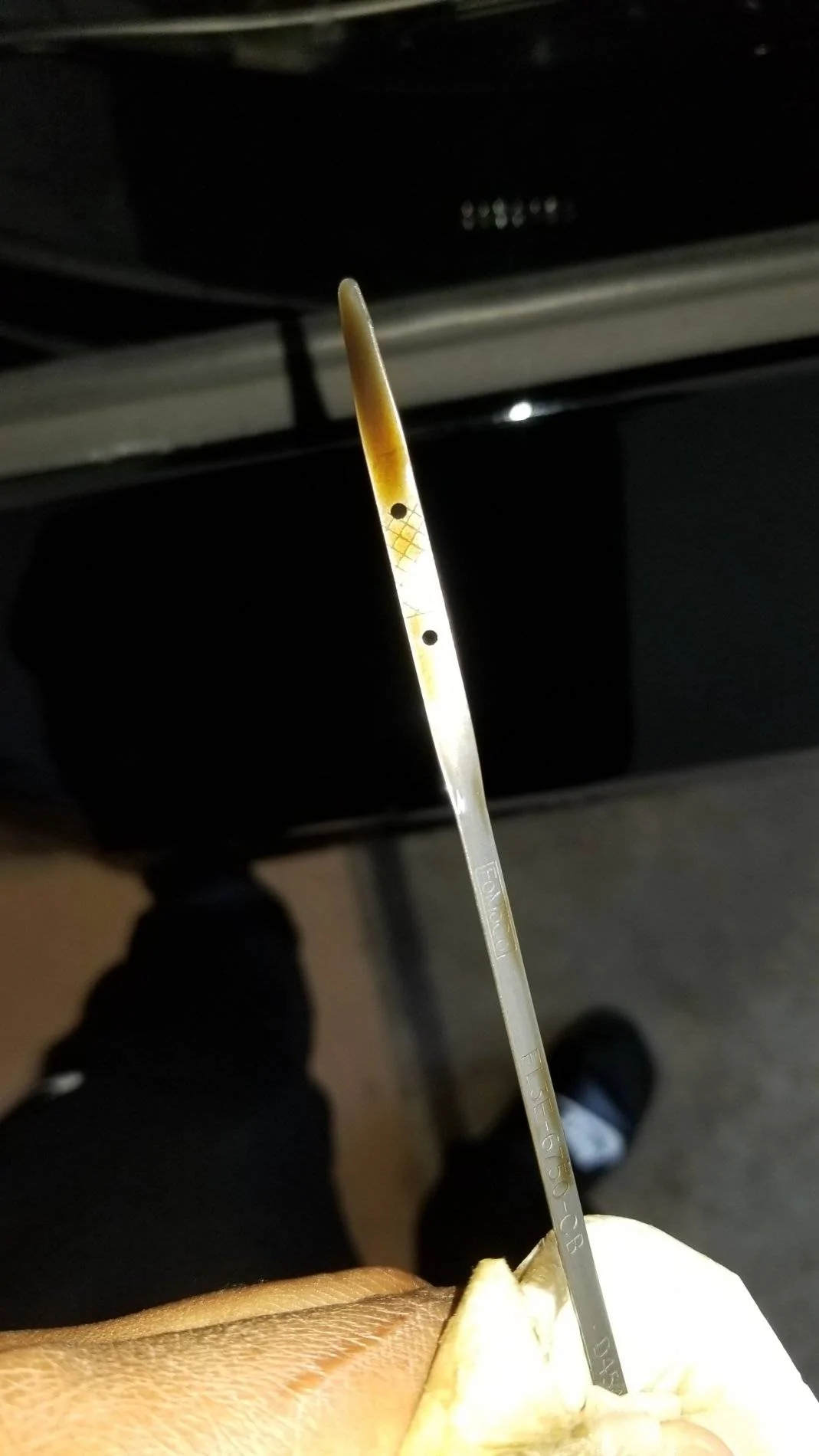

Check the dip stick and see if the oil looks milky, if so, you need to be concerned.

Hard to tell from pic, but looks to be some glitter in the catch can and the catch can will always look milky from all the fuel and water that gets into it, and the dipstick oil does look milky. Oil blasting out of the catch can be indicative of excess blow by pressure. I'd run a quick compression check on all the cylinders.
