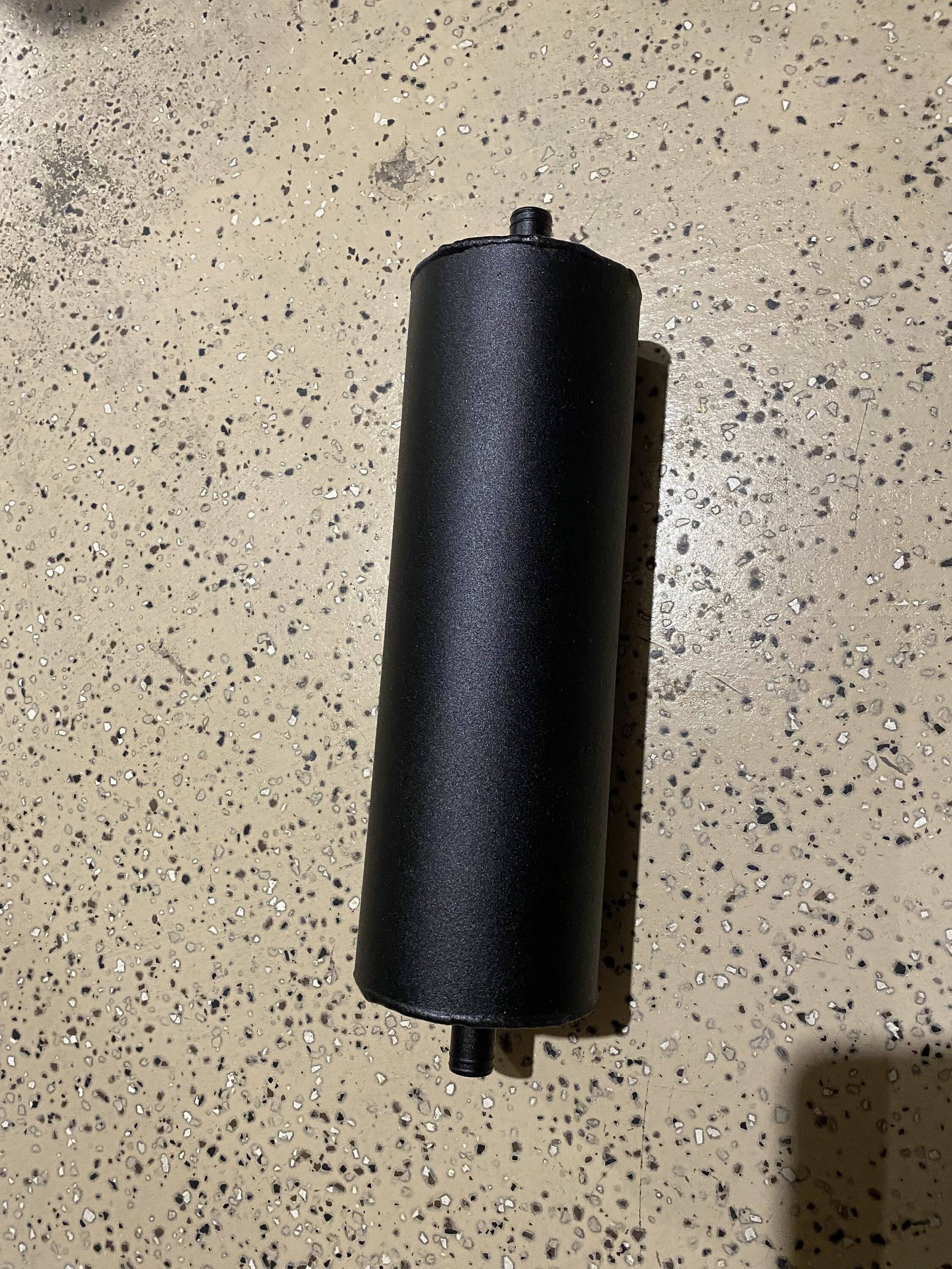

Kincaid has a cylindrical reservoir tank that I'll most likely attach to the bumper. I believe it holds an additional gallon. I ordered my kit about nine months ago and finally got the last of the parts about 2 months ago after half a dozen phone calls and emails. I have absolutely no motivation to install it. I don't know what happened to Joe. I bought one of the first kits he ever made almost 20 years ago and his customer service was outstanding. He sent me upgraded cores for free as he continued to develop the product, but it still left a lot to be desired back then. I only considered going with one again because the reviews and a conversation with him indicated that the product had come a long way in quality since then.

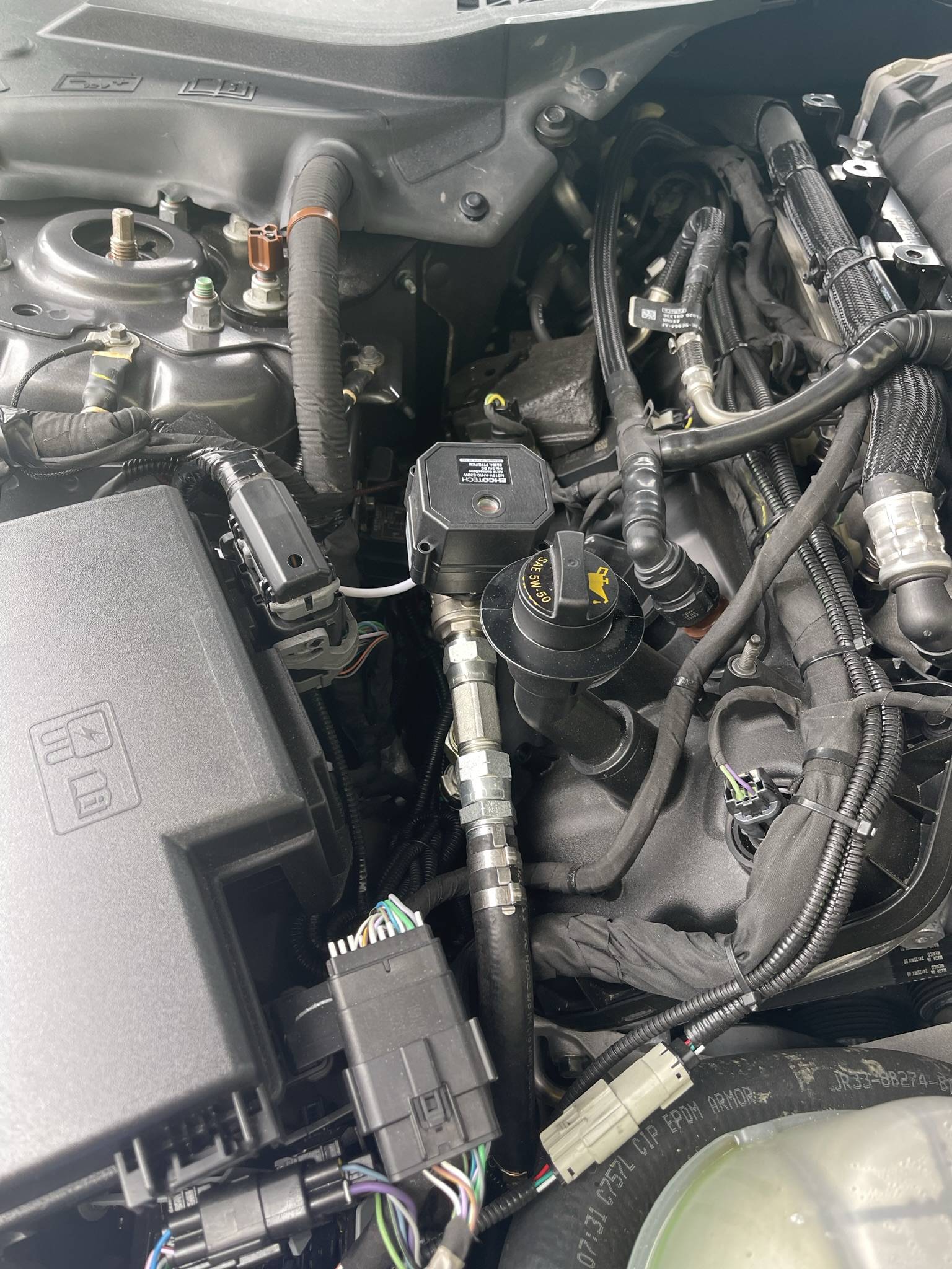

@bankyf Nice! I can't find one without a tank cap.
Did KC recommend where and how to mount that one? Will likely mount mine under the headlight.
I've been looking at these plastic tanks and fittings on usplastic.com. Unfortunately most of the small tanks and unvented caps are out of stock.
Also found some plastic fuel tanks and meth injection tanks that could work, but I don't trust the caps to not leak.

I think he mentioned mounting it to the bumper, but so much time lapsed between ordering and receiving all of the parts (5 or 6 different shipments) that I can't remember. Not sure what I'm going to do. I really have no motivation to install this kit. Nothing about it looks enjoyable.

If I had to guess, that tank should gravity feed into the Roush reservoir tank.
I should be receiving my kit in the next week. I'm not looking forward to leak testing the AC system.
