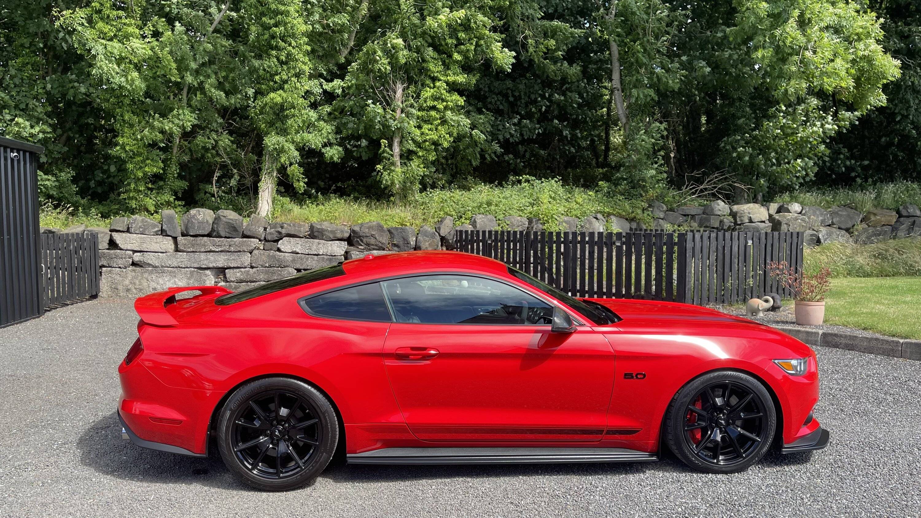

Don’t bother with Ford, of course they’re going to say they should fit them, at a premium, apart from needing to undo the subframe bolts to get the oe rear springs out it’s very simple, I did mine myself but any half competant mechanic could do it easily, then check the alignment, I needed camber bolts to get the front back into spec
mine sitting on them
