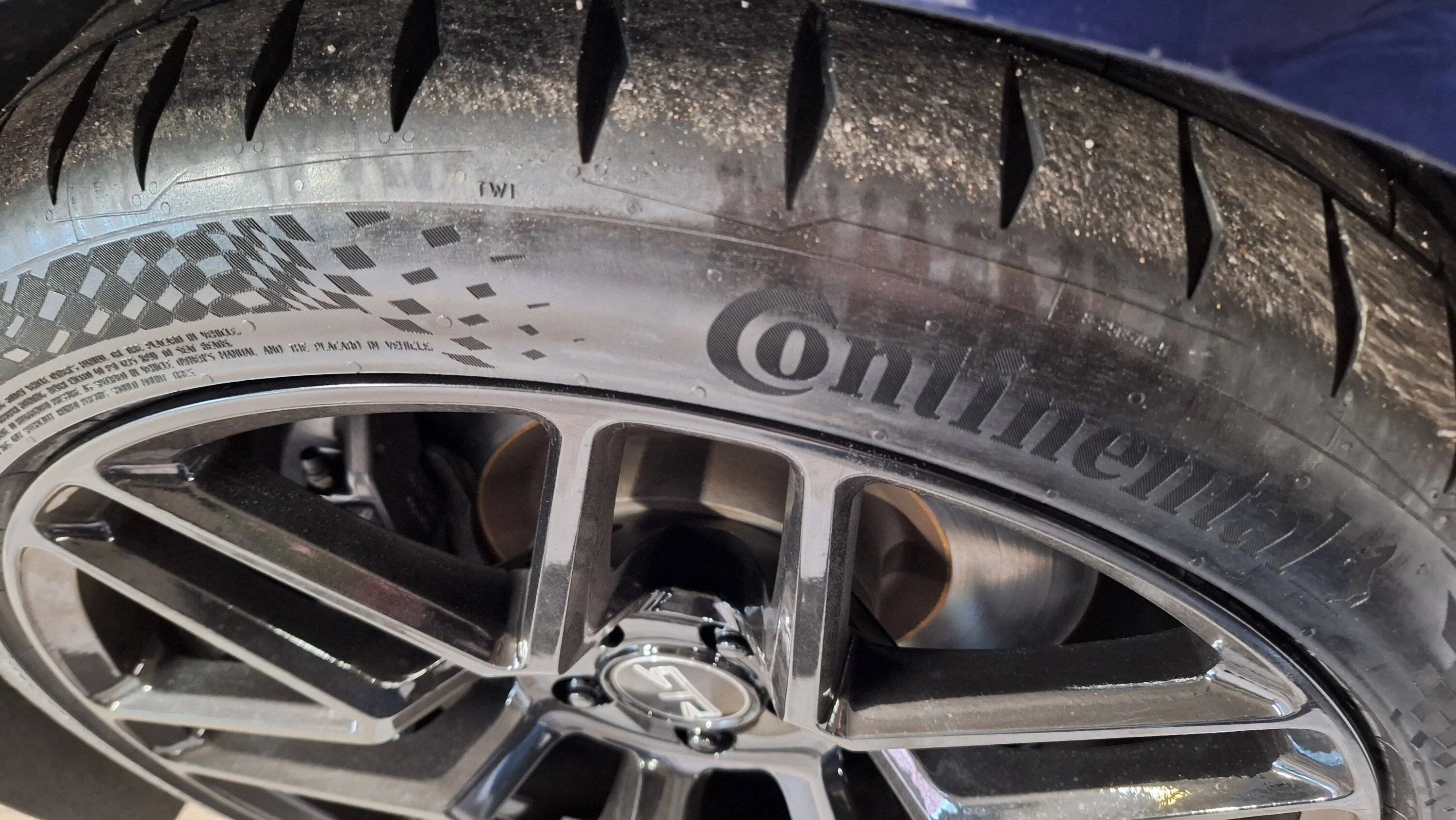

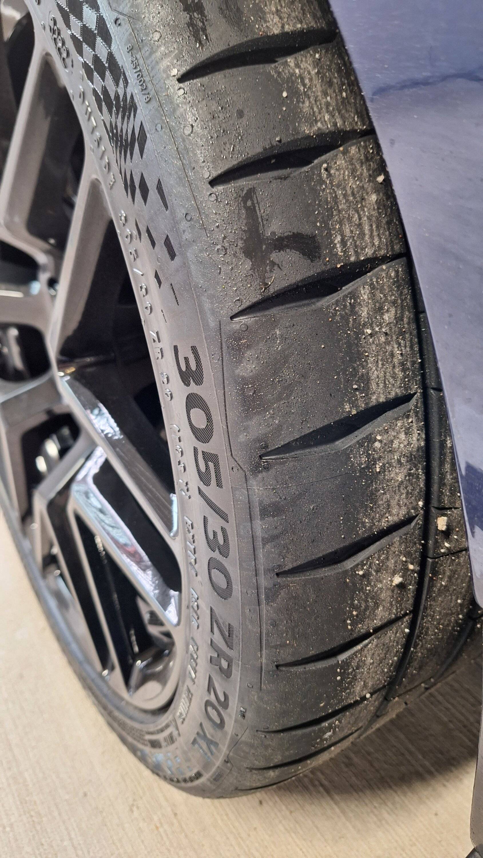

Just looking at how my new tyres are running and I think, the rears may need some pressure removing, what do we think?
Looking at where they are running the fronts at 32/33psi seem correct. The rears seem too high at the same pressure. I'm now running 305's on the rear so I'm guessing book pressures don't apply. I put a clean line on with my finger to show where I think it should be reaching.
Front.
Rear.

Do a burnout.. it will show your exact contact patch. If not happy lower the psi a bit and repeat!

I don't think you want to be down quite that low if you are just driving straight. Allow some room for cornering loads.
That said, dropping the rear pressures 1-2 psi should be fine.
I was thinking about trying out 30psi. 🤔

I run 30lbs all the way around (275/315) on the streets with no issues. 30lbs of pressure should give you a tiny bit more contact patch no big difference.
Edit: I will say that 30psi makes for a bit softer ride also.
