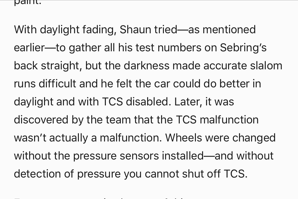

2.) Which brings me to my second question. Is there a connection between traction control/AdvanceTrac and the TPMS sensor? The reason I ask is because I once read a test of a Z06 Vette on one of the car magazine websites and the lack of TPMS sensors caused issues with the traction control system (screen cap of what I'm talking about below). Now I know that was a Chevrolet and not a Ford but I figured that it was a possibility that it was an industry standard to tie the traction control system and the TPMS sensors together.

The sensors weigh next to nothing. I don't use them on my drag radials and there is zero impact to ability to turn off traction control and advance track.

The weight is 9.6 ounces for all 4. Negligible. They have no bearing on the traction control or advance track system. The reason I don't use them on my drag radials is because I only use those tires at the drag strip and run them at about 20 psi so the warning light would be on anyway.
