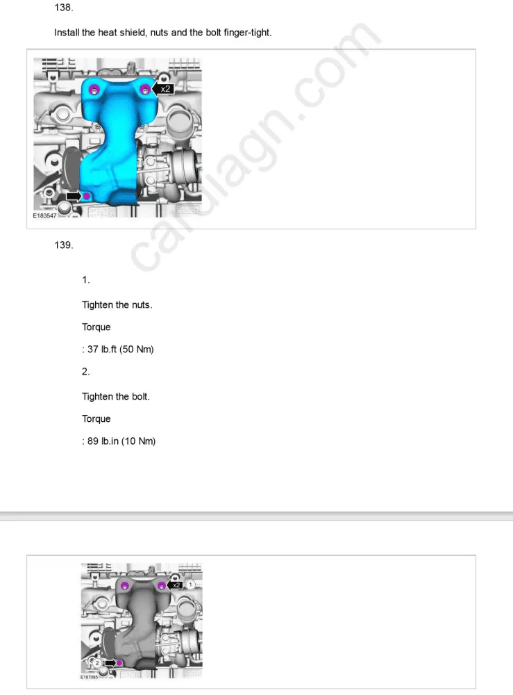

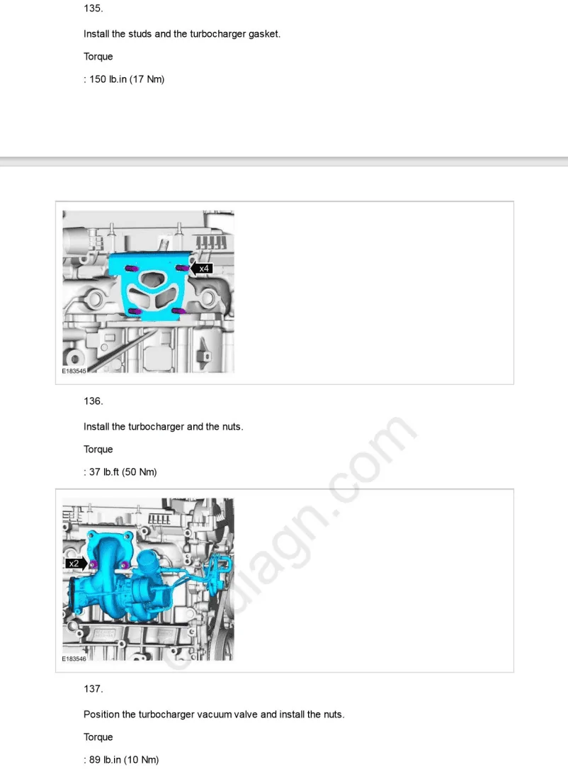

not sure which year range this is for but its the one from cardiag.
i looked at several times too then i saw they go 1) lb-in, 2 lb-ft, 3) lb-in

Studs and lower cover bolt are lb-in (12 lb-in = 1 lb=ft) and turbo mounting nuts and upper cover nuts are lb-ft stated above.

Thanks ihasnostang and bd, 12.5 lb-ft is a lot different than 30 lb-ft. Hopefully I haven't stripped out the threads in the head...
