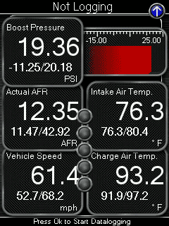

I think I have the correct PID I just went out for a little drive - and my Charge temp is higher than I expected, and I can see where it may hit 100 or above. Sorry as I remembered it being lower. Here is a screenshot for just a few minutes ago. Mine seems highest at stop lights.

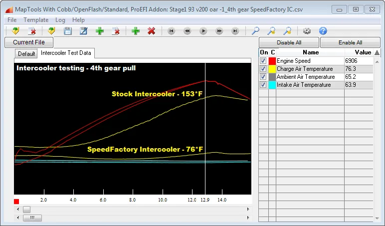

Hmmm where at in NY are you? Around NY, NY? I wonder if yours isn't reading correctly. Seems to be an issue over on the Focus RS forums with accessport. It's not too bad though at about 25 over ambient over what I can find on NY temps atm. Now increase that temperature to 90...you'll start to see 110+. Under spirited driving it's pretty common to start seeing pretty terrible numbers. Here's a pull from speedfactory.

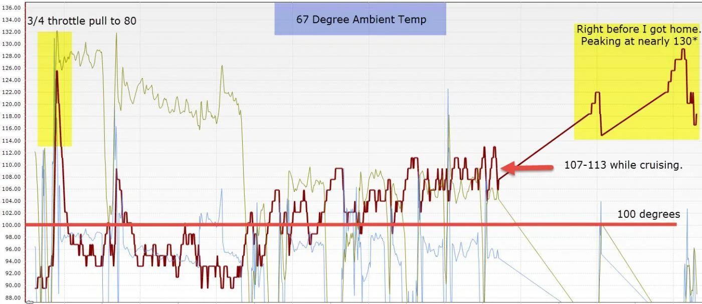

Here's my log while coming home from work with the ambient temp going between 65-68 degrees. 50/50 city/highway. You can see it start closer to ambient, and a (not even WOT) pull to 80 pushed it straight to 130. After the motor finally gets up to temp you can see where the IC starts to fail at it's job and get higher and higher. At the end of my 20 minute trip I was cruising at around 105-110 on a 67* day. That's damn near 40* delta. And if you look at the end it only gets drastically worse getting into 130* at a stop light. Those two are short stop light stops that I stopped the log for due to log maximum, there's only a 3.5 minute gap between the continuous log and those two. It does get high pretty quick. They aren't edits. If I would have been able to keep the log going longer, the average cruising temp was around 120*.

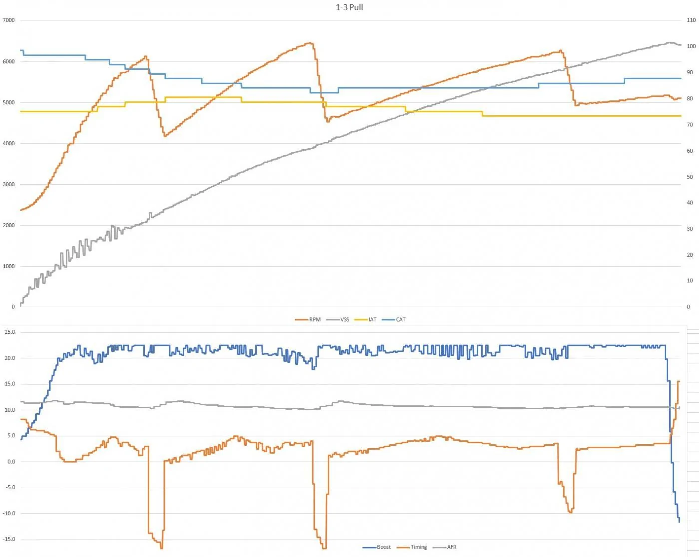

I found this datalog from not too long ago. I can't remember what the ambient was, I think it was 70*. You can see when I started the charge air temps were near 100*, going slow and no boost. I have the Cervini's Stalker hood with functional ram air that diverts the air in the scoop on top of the open GT350 intake from the FRPP Performance Pack (tune and intake). When I get up to about 50 MPH, you can see the intake air temps start to come down closer to ambient and level out just a couple degrees above ambient. You can also see how quickly the ATM FMIC cools down the charge air (IAT2) and in 3rd and 4th gear, charge air temps start to go up but only a little. With my stock intercooler by then the temps were going up VERY fast with a steep curve and it wouldn't have gone down very much earlier in the run. This was all at 100% throttle, you can see the boost where I let off.
If I remember correctly AP timing is Ignition correction, while on SCT it's Spark Advance
