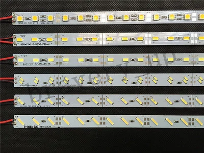

yes they seems ok. But you know, with chinese stuff is always a lottery :D
The important thing is to buy cheap stuff so in case they are not ok for you, you have lost only a few euros..

theoretically yes, in fact I bought a 5050 led strip :) but then they were less bright than a 5630 strip I already have..
But you are right, 5050 should be better!
(Just FYI, these 'codes' are simply the leds size: 5050 is a 50mm x 50mm led, 5630 is a 56mm x 30mm and so on)
