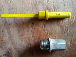

These parts
If anyone knows the part numbers would be great. Or the thread size. And any other dimensions! Thanks!
